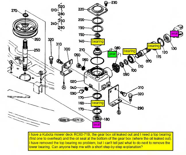

Kubota mower deck RC60-71B, the gear box oil leaked out

I have a Kubota mower deck RC60-71B, the gear box oil leaked out and I need a top bearing (first one to overheat) and the oil seal at the bottom of the gear box (where the oil leaked out). I have removed the top bearing no problem, but I can't tell just what to do next to remove the lower bearing(?) to get to the oil seal. Can anyone help me with a short step-by-step explanation? :(

Answer: remove (4) gear box mounting bolts #310 and the gear box just lifts straight up, and the lower bearing and oil seal comes up and out with the gear box; and the pulley and pulley drive shaft #250 remains in place. You may need to pry slightly between the bottom of the gear box and the top of the pulley to break the slight adhesion between the lower bearing and oil seal, and the pulley drive shaft. :)

I need to pull the gearbox on my RC60-71H, which has a different gear box (70723-33110) from the RC60-71B in this post. Is removal the same?
I can't tell from the parts drawings if the shaft stays with the deck and the lower spindle housing like the RC60-71B (original post), or whether it comes out with the gearbox.

OK, starting to feel a bit like I'm talking to myself but I'm going to post this in case it is useful to someone else. I got the gear box off. The shaft stays with the gearbox on the RC60-71H. First, take off the blade and associated washers. Then remove the circlip and the splined boss on the shaft. On mine the circlip was missing and the boss would not pull off. The next step is to remove the four bolts holding the gearbox on. Having done that, I was able to encourage the shaft and gearbox upward (block of wood and large hammer) driving the shaft up through the boss, at which point the gear box was off. It goes now to the dealer to have the bearings and seals replaced. I feel confident I could do that but they said it is just about one hour labor plus parts and I think it would take me a few hours at least and probably multiple trips for parts, tools (I would need large circlip pliers for this job) and supplies. And it will be good to develop a relationship with the local dealer.
I'm needing to do this on my RC72-B mower (same gearbox design from what I can tell) and don't see how this is possible with snap ring #150 still in place. I'll report back, hopefully later today
