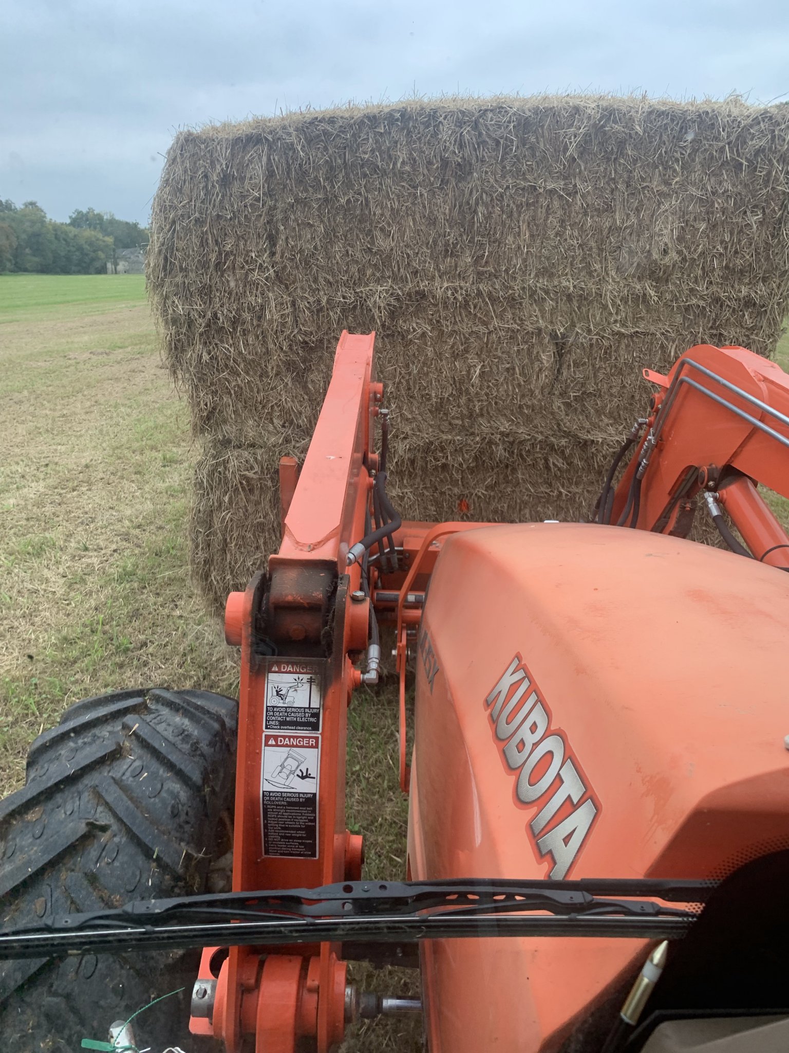

I’m running 2 larger Kubotas (M135X& M126X) and trying to lift 3,300lbs (2 large square bales and a set of bale forks) and that’s about all it’ll handle.

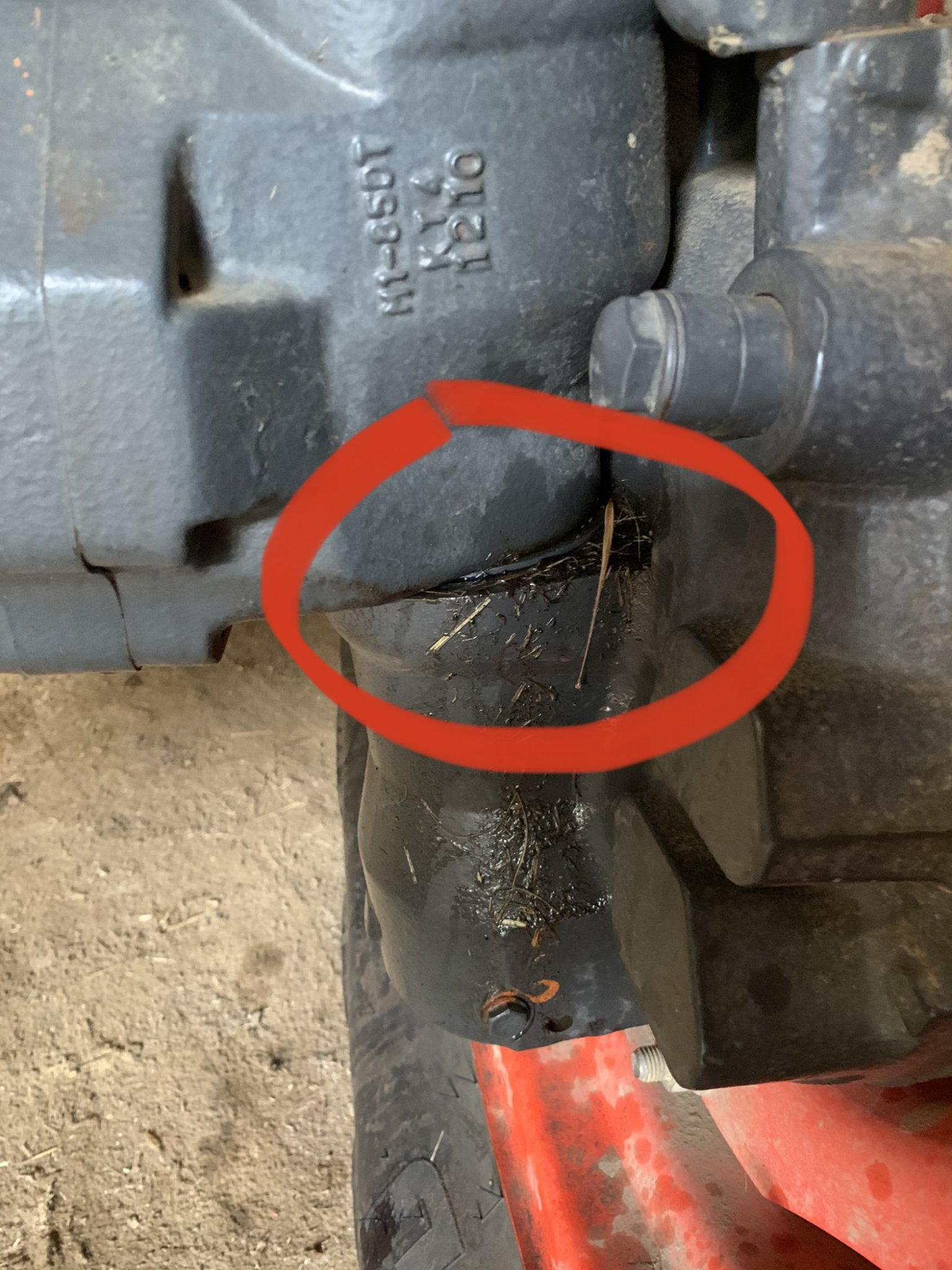

Also keep in mind Kubotas can encounter front axle bearing & seal problems when you push the loader to it’s limits. I just finished replacing seals & bearings for the second time on my M126X from doing a lot of heavy loader work. Once in a while is ok, but regular heavy loading like I’m doing puts a lot of stress on front axle components..
