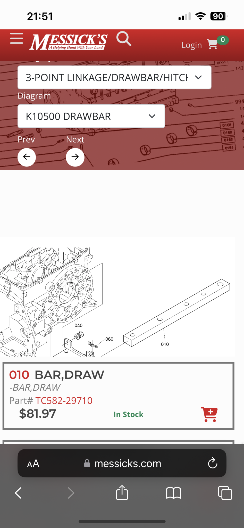

Messick’s lists the drawbar for $81.97. If you need bigger hole for some stuff and the original size hole for other stuff, might just buy an additional drawbar and enlarge the hole in one of them unless enlarging the hole is going to take too much metal out of the bar for it to retain sufficient strength.
