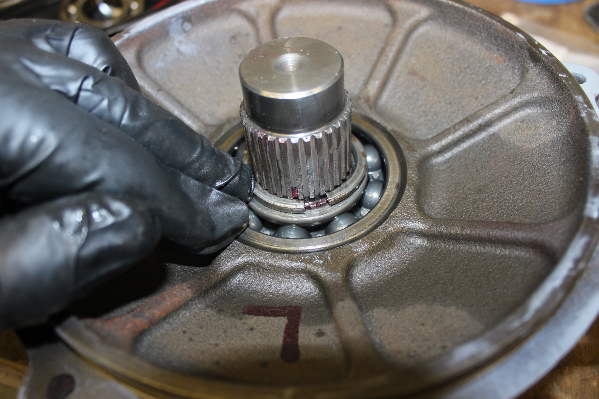

For anyone seeking to replace leaky seals or perform an oil change on the front end, I hope these pictures provide some inspiration.
This tractor was a rust bucket and severely abused. I wanted to try my hand at restoration on something other than a motorcycle and well, it's been a work in progress over the last year. I've learned a lot and as a retired person - I like to keep busy - like really, really busy.
Hopefully the pics will tell the story and show anyone seeking to do this that it is hard work, dirty, and yet very rewarding to see a machine working properly!

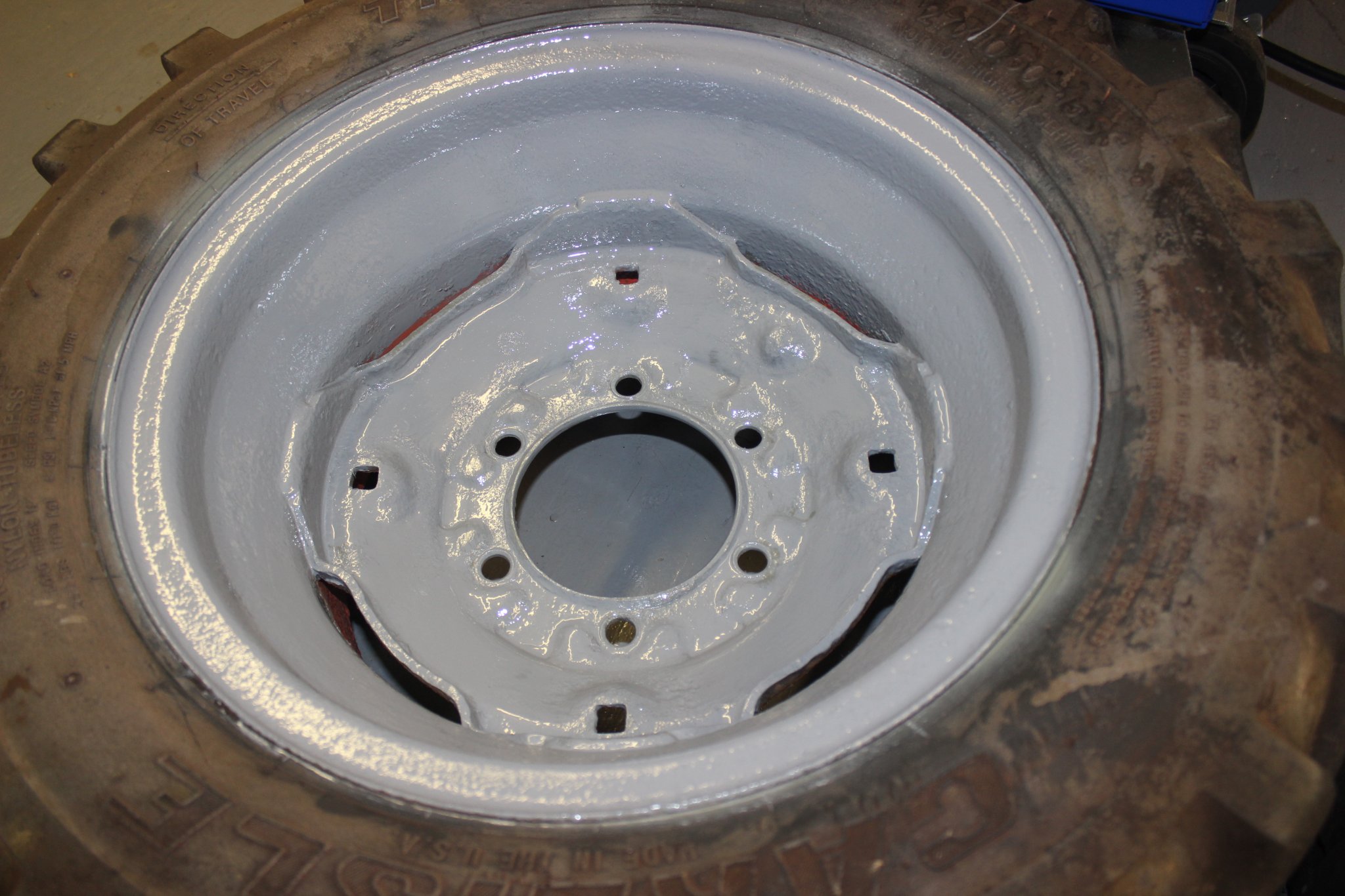

I took it one step further and decided to powder coat the majority of components. The axle itself was painted however.
I added a grease fitting to the front axle holder. I don't see why Kubota omitted this.
Anyway here are pics. I can only post 10 per post.

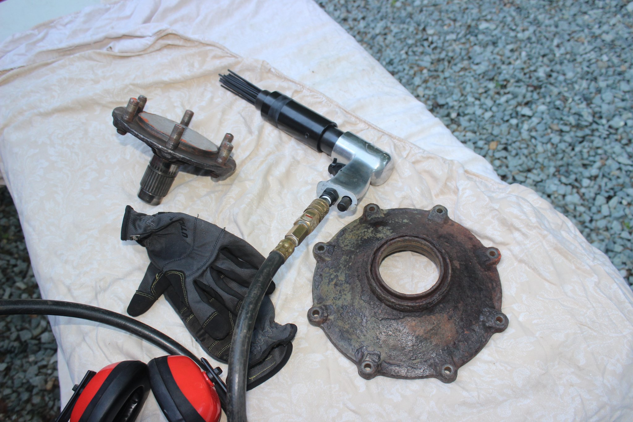

I used an air hammer and needle scaler for rust removal, finishing with abrasive blasting and wire brush.
Paint primer is Rustoleum self-etching primer.
Paint used is Rustoleum Smoke Grey and Powder coat is Hotcoat Machine Grey from Eastwood.
