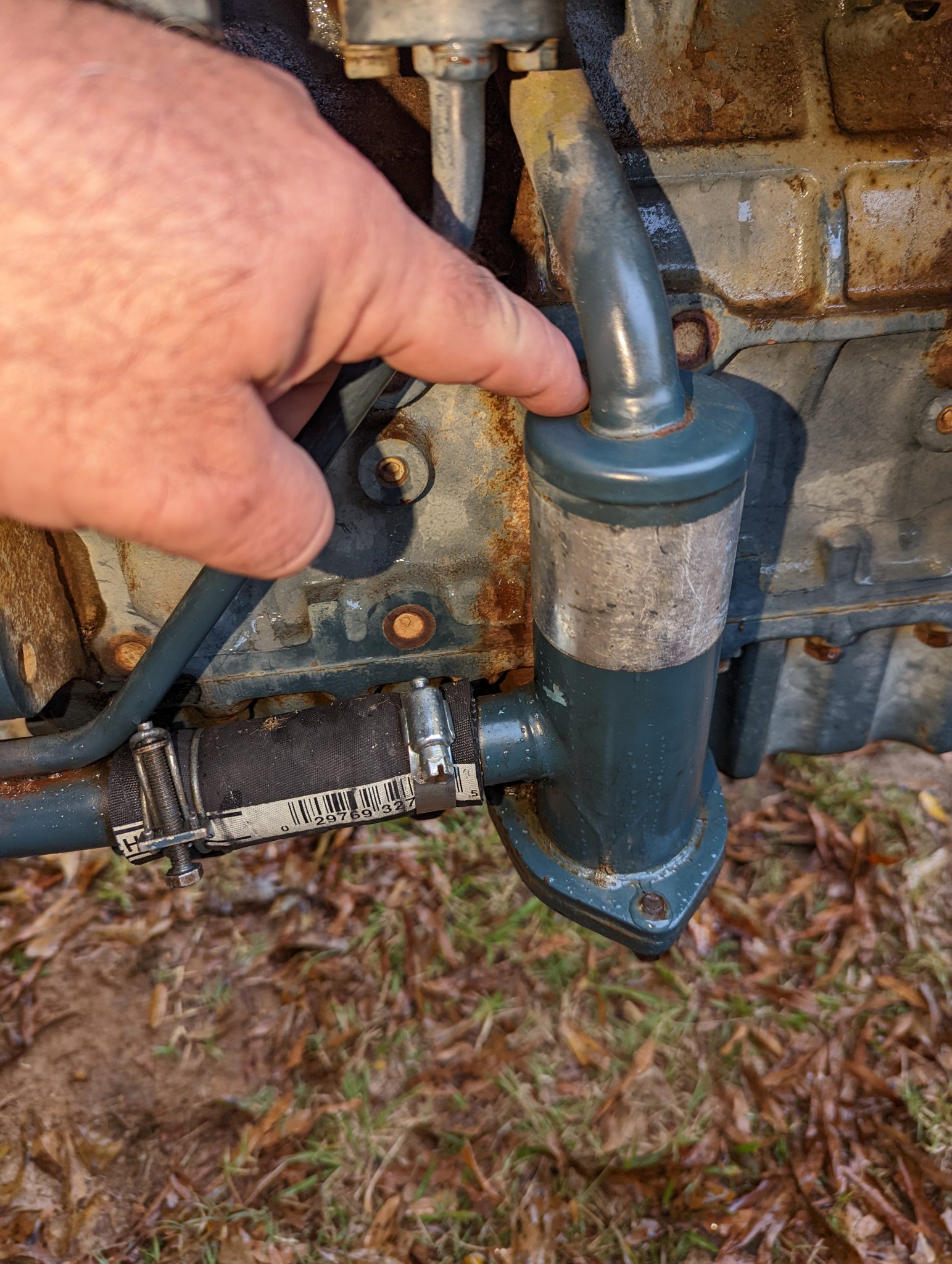

Where the pipe is coming out of whatever that cylinder is it did bend a little when the hose below was pulled off. That cylinder caught a stump when I backed up and hose separated.. I guess it is possible that when that bent it could have caused a hairline crack where they meet.

That canister contains the oil strainer. It looks like the top may be bent. I'd still start by checking to see if the pump is producing flow. If not then I'd turn my attention to the pickup side. You could try replacing that hose with some clear tube to get a visual on the flow.
There is a filter of some sort in that canister. I suggest you take the filter out of the canister and see what condition it is in. I guess I would do that after you get it working again unless that doesn’t happen by priming the pump.

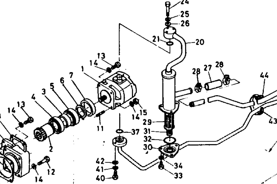

The line out of the top is the inlet pipe to the pump that @TheOldHokie describes above. That would be my first thing to try (prime the pump). I assume you were running the tractor for some time until you noticed that it was not working. That may have damaged the pump but I am hopeful that the pump is just really dry and can’t draw enough fluid into it to get itself primed thoroughly through the filter.
Since you are unaware that is the filter I assume it may be pretty dirty. The illustrated parts list above looks like it is a screen that can be cleaned but I assume it will drain the whole transmission of fluid if you take it out.
