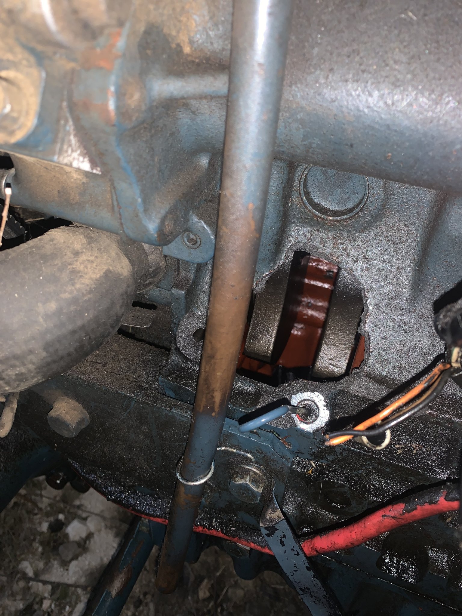

i blew out the block on my 1980 kubota l305dt. Im not having any luck finding a replacement. Does anyone know where I can get one?

How bad is your block? A picture might help get more ideas from members.

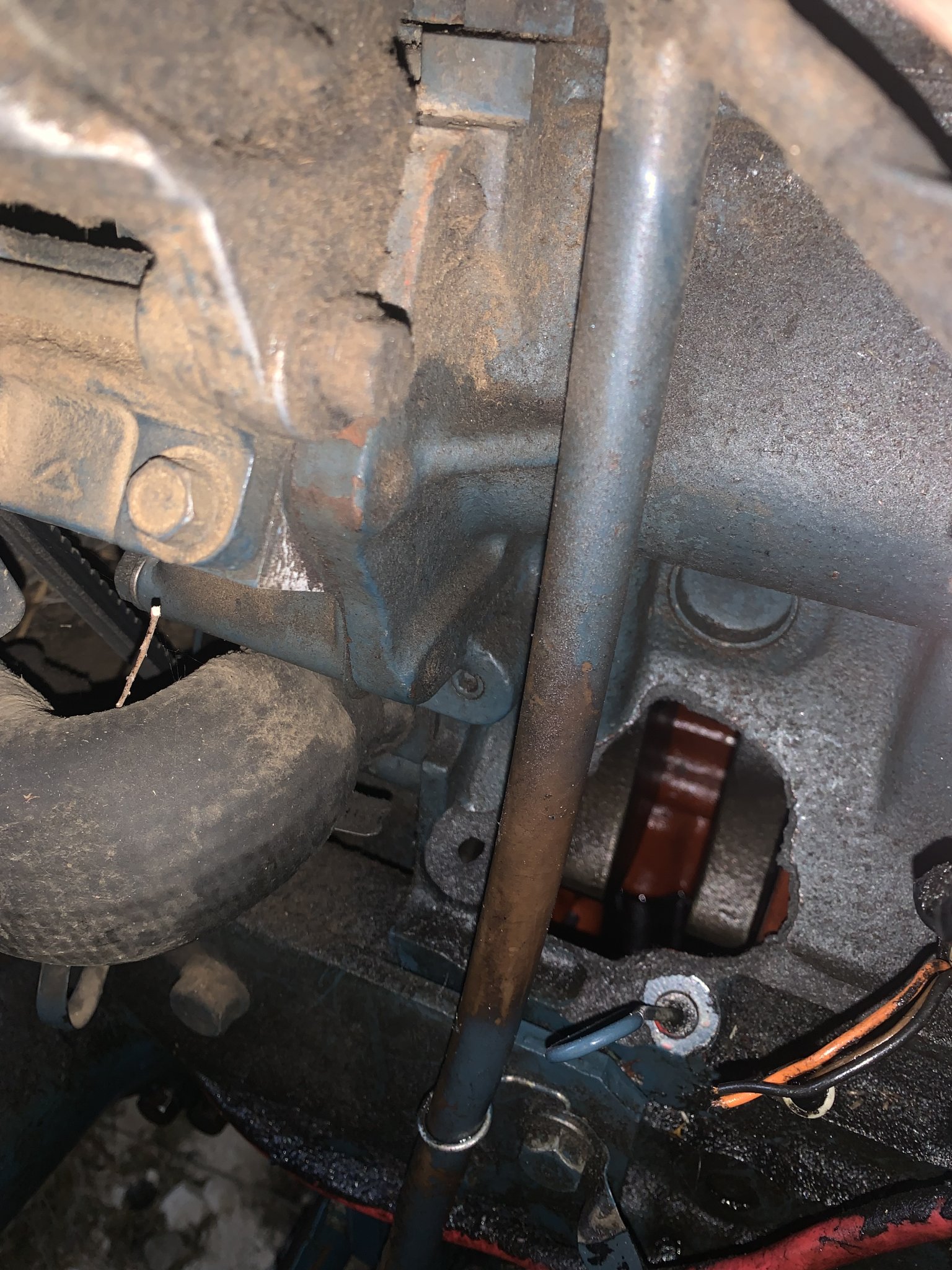

I WILL TRY TO POST SOME PICTURES THIS EVENING WHEN I GET HOME. THE HOLE IS ABOUT FIST SIZE GOING DOWN TO WHERE THE DIP STICK IS LOCATED

Maybe like the hole in the block in this thread?
This is a long, long thread but does get around to patching the hole with a patch and epoxy glue.

99% likely the connecting rod is broken and the stump poked a hole in the block. Don't start it again. The broken out pieces they could be brazed back in place - but that would come WAY down the road after finding and fixing what caused the rod to fail - and what else inside the engine needs replacing. To get the pan off on that model, the front axle and bracket have to be taken off.
