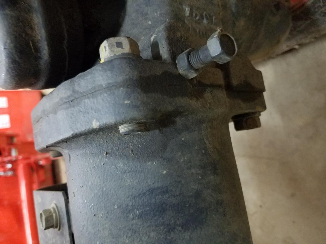

One issue I have noticed with my 2501 now, as Ive been watching it over time, is a VERY slow leak of the front right side axle. You can see just a tiny bit of seepage over time in the little line where the two pieces of metal come together. Im posting a picture I found online that shows the location...It is the location just below the mans fingers in this picture, where the wheel assembly bolts onto the axle here. I can also see visible wear signs on the bolts that clearly indicate the dealer, or someone, put a wrench on them. I was told in another thread some weeks ago when I mentioned this that this wheel possibly ships from the factory not assembled on the tractor body, and is potentially assembled by the dealer, and this would explain the clear wear on these bolts from being wrenched. I bought the tractor brand new from a dealer lot and noticed this wear within first few hours. Ive always wondered about this....The leak is super slow. If you whipe the little crack down with a rag it takes many days to notice a tiny discoloration to reappear in the crack/line. Its just wet enough that you can see it and know that its seeping. Ive been told that this is sealed with an Oring, and the fix would be to take it apart and install a new Oring, or to simply live with it, given the seep is so little that Id estimate in a solid year you wouldn't have maybe 1 ounce or less seeping out. I have thus far elected to just ignore it because Im not someone who has done a lot of work on tractors, and while I have no doubt I could accomplish the fix likely, I just dont have a lot of interest in jumping on it. I would have to drain the axle I suspect, replace the O ring, get it all back together, then refill with fluid. Im not happy that it is seeping, but I also can see how slow and small it is.
Im curious if troverman or any others noted any similar leak here, or perhaps can see any wear on these bolts indicating they had been wrenched on either of the two front axles.
A 2nd image giving a little idea of what this seepage leak kinda looks like. Notice the "wet" little discoloration around the area where the axle comes together. For mine to look like this it would take probably a couple of weeks after wiping it clean.
