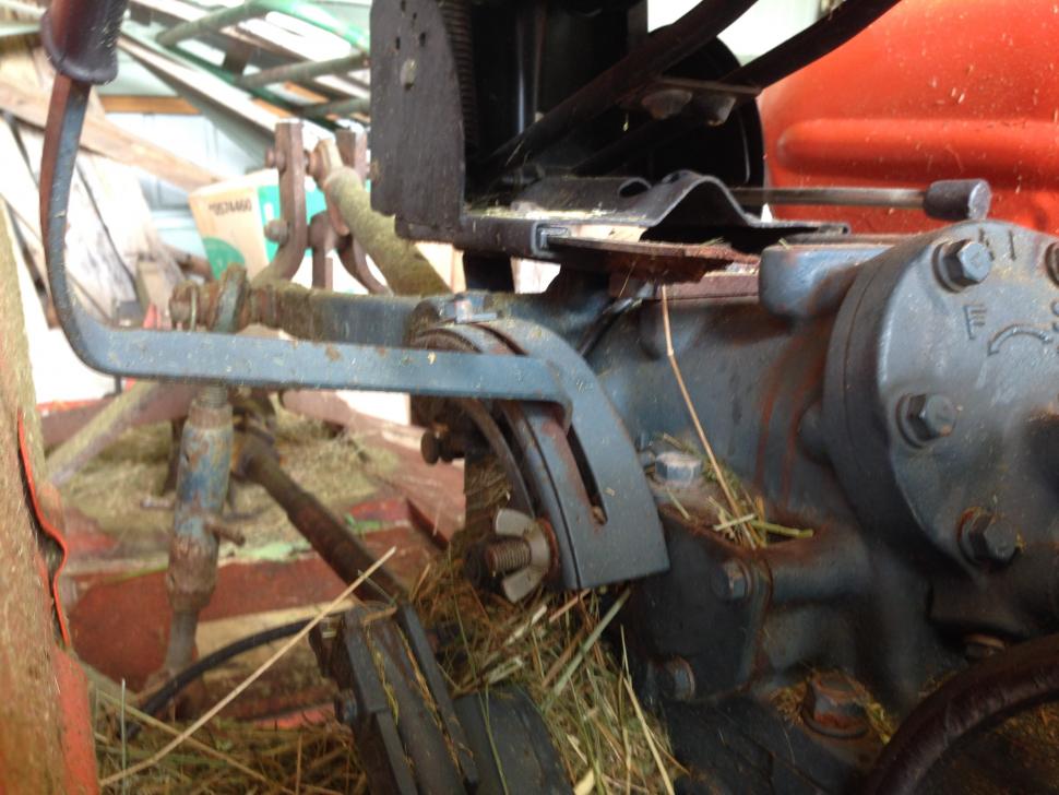

Where were you saying mud dobbers could cause a problem? I was thinking of another area. Attached are two pics under my seat taken from both sides.
I checked the hydraulic filter and it looks alright. The fact that the gear shifts only leak when I'm using my brush hog makes me think it has more to do with the rear hydraulic lift than the seals of the gear shifts. The guy at Kubota said the 0-rings in the gear shifts weren't hard to replace, but I can't figure how to get them off. Any advice on the hydraulics or gear shifts would be appreciated.

In your first picture there is a piece of pipe sticking out of the side of the transmission. It has a bend that resembles a question mark and doesn't go anywhere. That's the vent for the transmission. Mud dobbers love to plug that bugger up. That pipe just screws into the side of the transmission. But it can be a bugger to unscrew it. Then I usually just clean it out with a coat hanger.
Some people will clamp a piece of screen to it, or even a piece of an old sock or rag, after its been cleaned out to keep the mud dobbers out of it :)

Thanks, I didn't know that question mark thing unscrewed. How do mud dobbers get into some of the place they do. Someone also told me there's small vent on top of the hydraulic fill cap that can be cleaned with a paper clip. I haven't looked yet. I hope this solves the problem. I've seen posts on other sites that say that is most likely the problem. Sure would beat installing new o-rings.
