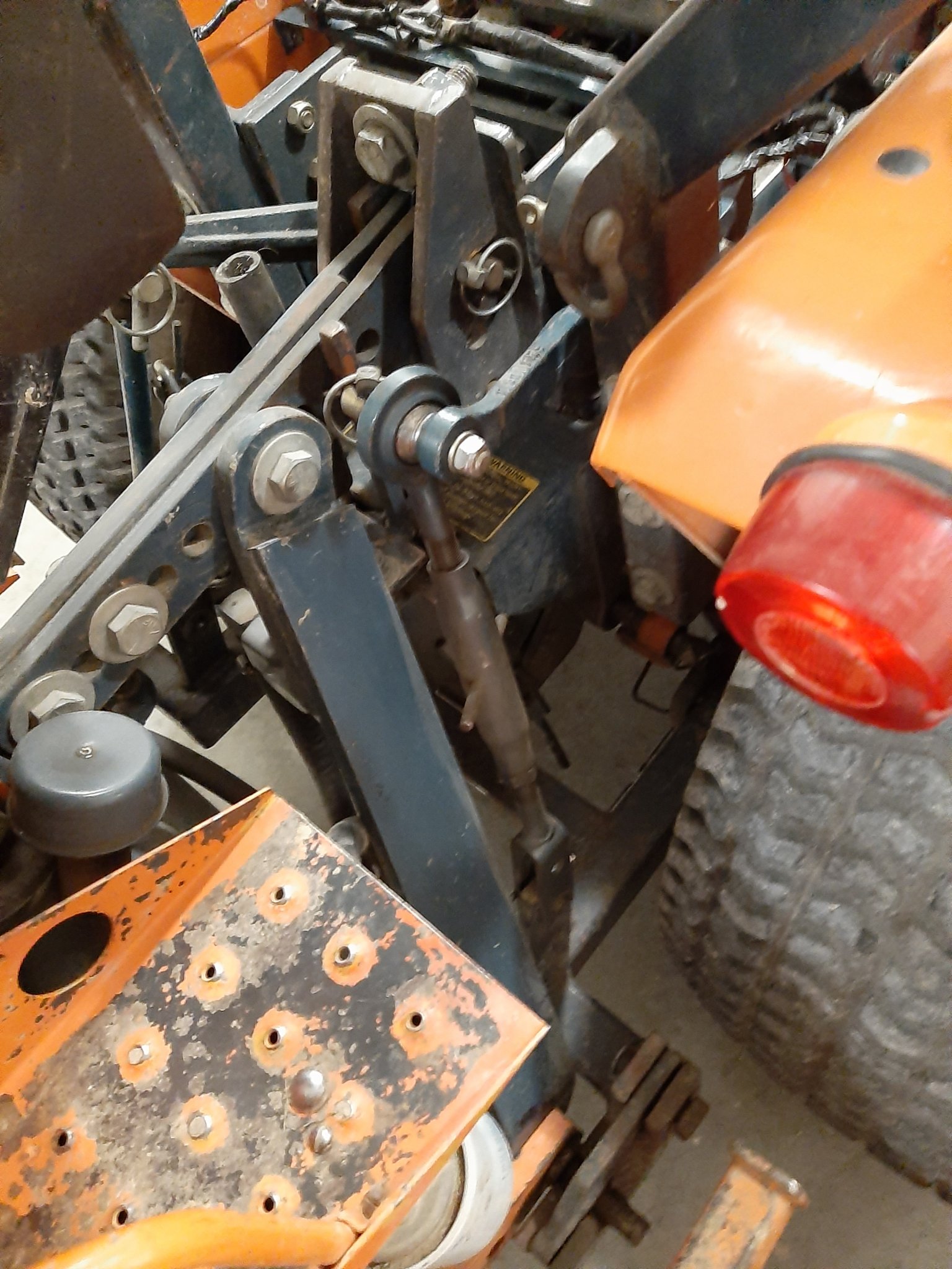

Good morning Dan
Here are some photos of the top bar and the connectors where the limiter would attach. Please ignore my janky bolts and the current "limiter" I am using - that setup was for travel only.
9,902
5,242
Good morning Dan
Thanks - excellent pictures and that shows exactly how the limiter is attached.
The blue bar appears to be a repurposed top link and is doing the hold down function provided by the limiter cylinder. It does that fine abd there is no need to replace it. The only thing you would gain using a cylinder is the ability to raise the 3pt.
If you want to replace that hold down with a cylinder you need to take a couple measurements and buy one wirh the correct length. As I said earlier a DA cylinder with the proper length is probably cheaper and easier to find.
Hey Dan, you're correct - I used the top link as a temporary solution. Glad to hear it's sufficient for the job. That said, I would like to replace it with a cylinder. Which measurements do you recommend me taking? I can measure the length of the top link, which I assume is the short measurement. I can also measure the width where the limiter attaches to the hoe and top bar. Do I need a fourth measurement for the extended length of the cylinder?
Thanks for your help with this, I think we're on the right track.
9,902
5,242
Measure the eye to eye length of the top link as adjusted and shown in your pictures. That is the extended length for the cylinder.
Then remove the two pins securing the blue top link and use the 3pt to raise the backhoe. Wirh the hoe raised measure rhe center to center distance of the pin holes where the blue top link was attached. That is the retracted length needed for your cylinder.
Then all we need worry about is making sure the ends on the cylinder will fit the attachment points. Simple as that.
