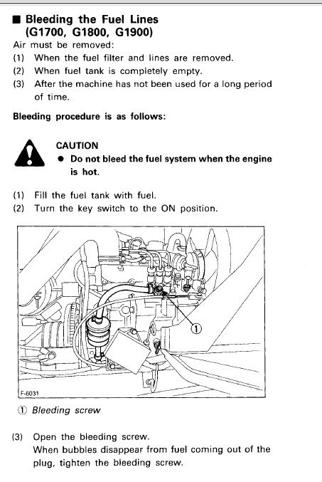

Are you following this procedure to bleed the fuel injection system Doing this will tell you if your fuel pump is working.

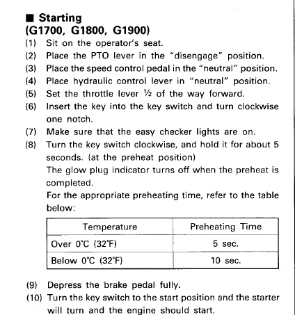

Are you following the starting instructions including the pre-heating of the glow plug?

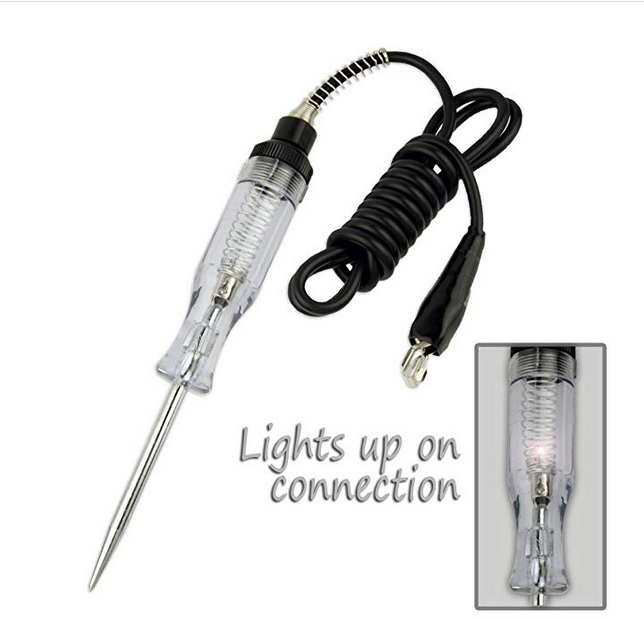

I suggest you invest in a 12 volt test light to help you get your machine going. Available any auto parts store for $10 to $15.
With the test light you can easily check if power is getting to the fuel pump before deciding the pump needs to be replaced.
If power is reaching the fuel pump but it is not working then you need to replace it
