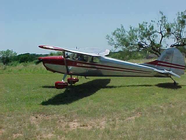

I use WD40 by the gallon cans. Several full ones are sitting in my place because I buy them whenever they’re on-sale. I use it instead of soap in the wash-water-bucket to keep from having to polish this thing (which was last polished in 1997)…WD40 works great:
