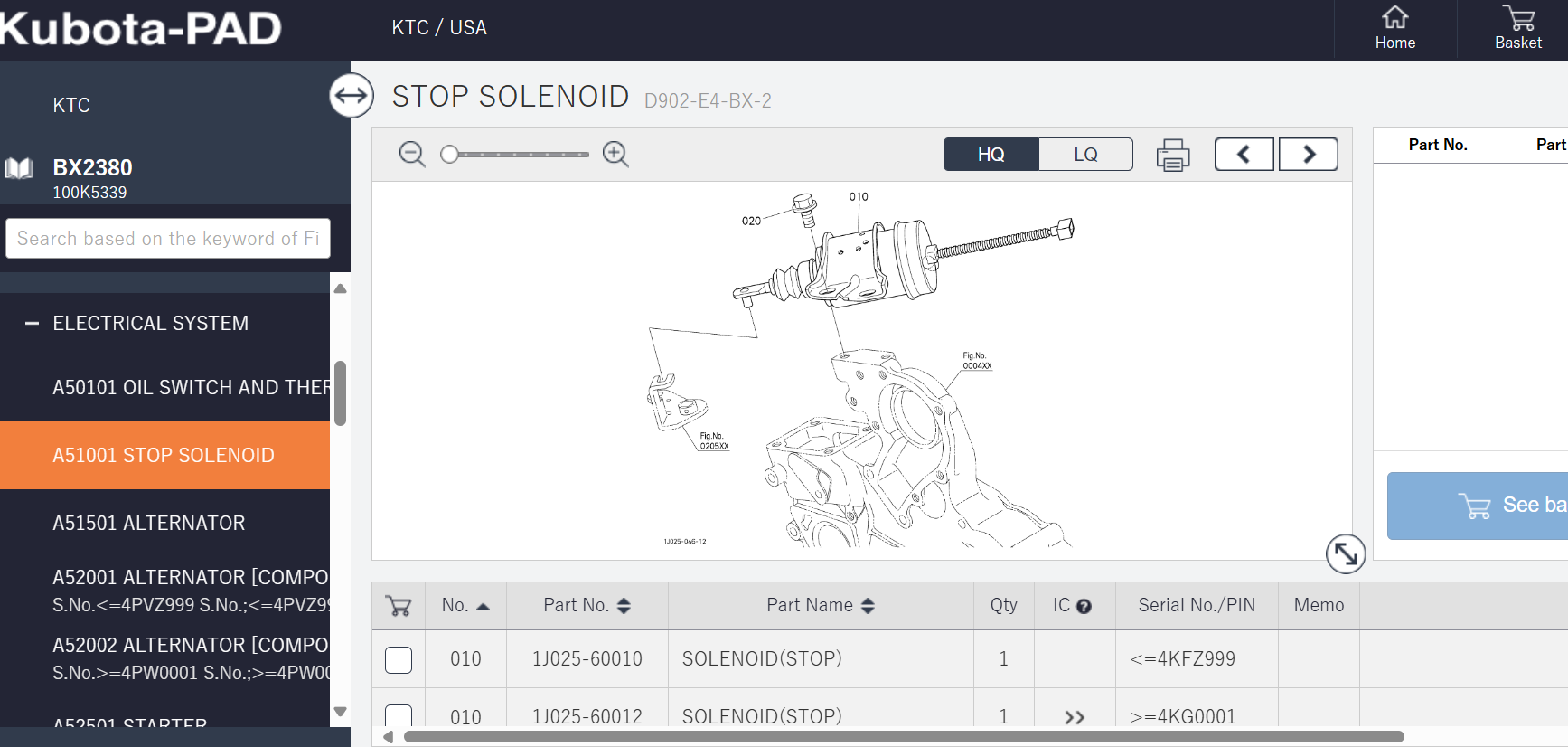

I think your BX2380 is very much like my BX2360, just newer.
From Kubota Tractor Corporation - Illustrated Parts List (kubotausa.com)
My tractor extends the stop solenoid rod to the "run" position about 6-8 seconds after the tractor shuts down.
I'm guessing the stop solenoid is bad, or there's some interference in the linkage. Not sure which, but I'd first disconnect the linkage to make sure everything is free.
I'd run the tractor again to see if you can hear/see the solenoid attempt to extend. Probably could bench test off from 12v power.
Don't just throw parts at it. Likely a simple solution.

Thanks for the reply. The solenoid appears to be good. I haven't actually measured the rod travel, but it appears to be retracting and extending in the same manner as my neighbors (who has the 2370 model). It's all that "linkage" that is connected to the rod that appears to be the problem. I don't suppose you have a nice exploded view of that portion of the tractor?
10,003
6,809
Follow the Kubota illustrations I linked before. If you’re in Canada, there’s a similar option.
Make sure you have followed the directions in the WSM, as well as what @whitetiger mentioned on post #4.
whitetiger really is an expert. He’s forgetten more about these machines than I’ll ever know.
