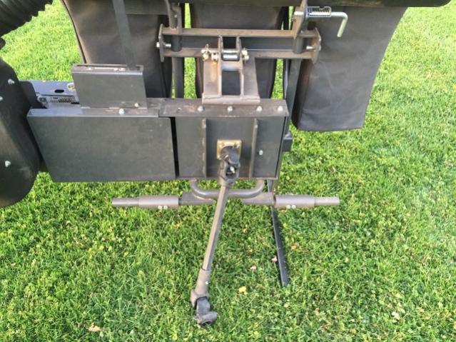

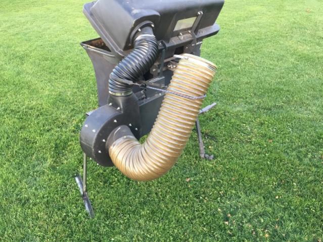

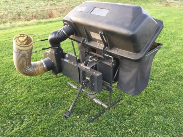

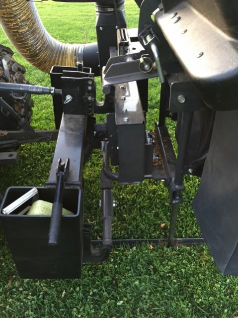

Since I didn’t find anything, I decided to make it myself. So after many measurements and a couple of designs I ended up with this one.
I removed the upper bagger mounts off the tractor and off the bagger. I removed the lower mounting system off the tractor. I also removed the U shaped upper-to-lower brackets that were on the bagger. I then had some new lower mount extension pieces made up for the bagger. Then went on to make a new upper link mount (all bolt on).
Now that the bagger is 9-12” farther behind the tractor than before, the OEM driveshaft will not work. For some stupid reason, the stub shaft that drives the pulley system is welded to the yoke of the driveshaft so the main pulley has to be removed and the shaft pressed out of the bearings in order to remove the whole driveshaft. There is a driveshaft company nearby, so I went to them and got the parts to make up a new slip shaft. I then had a new stub shaft made up and installed that into the bearing housing and reassembled the pulley. The driveshaft is keyed and set screwed onto the stub shaft.

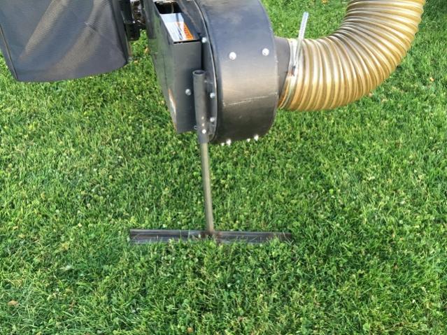

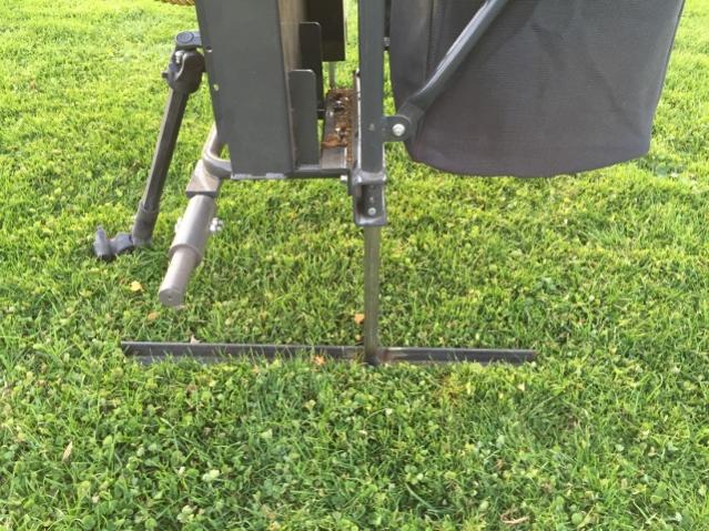

Even with the QH mount and the bagger in the highest position my suction tube was just long enough to work. I then had to make new feet for the bagger because the OEM ones are not tall enough. So, I fabbed up some new legs. Now, I can back my tractor up to my bagger and be on my way in under 2 minutes; vs an hour.
