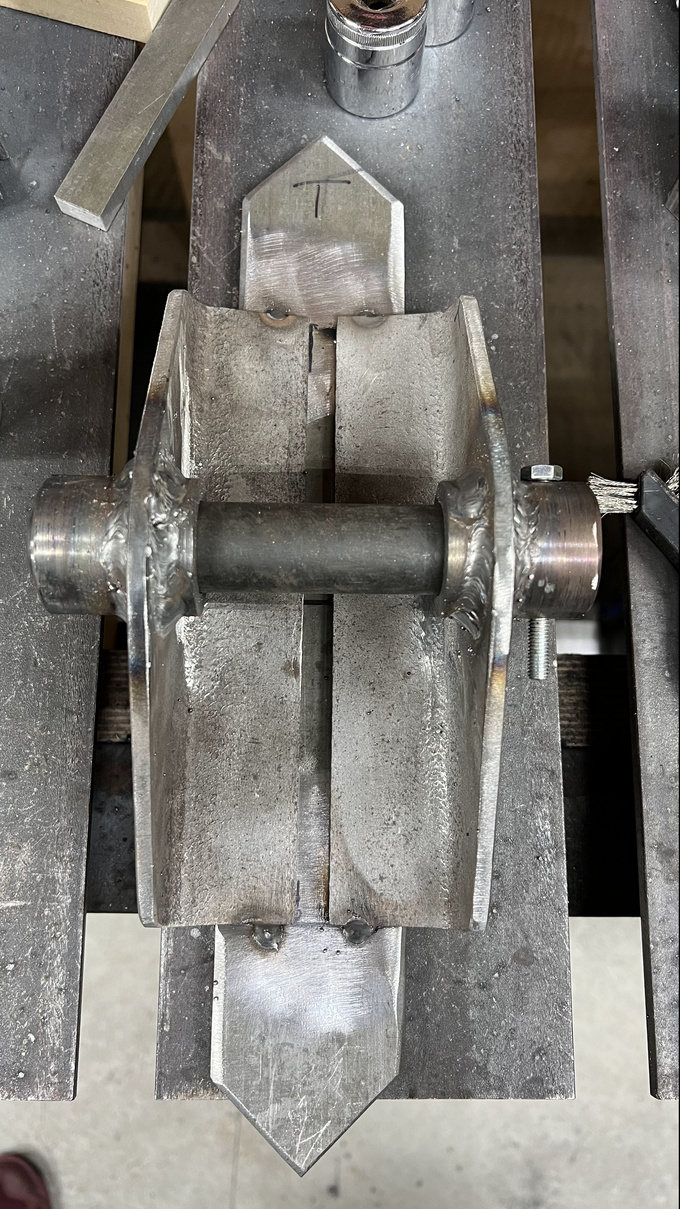

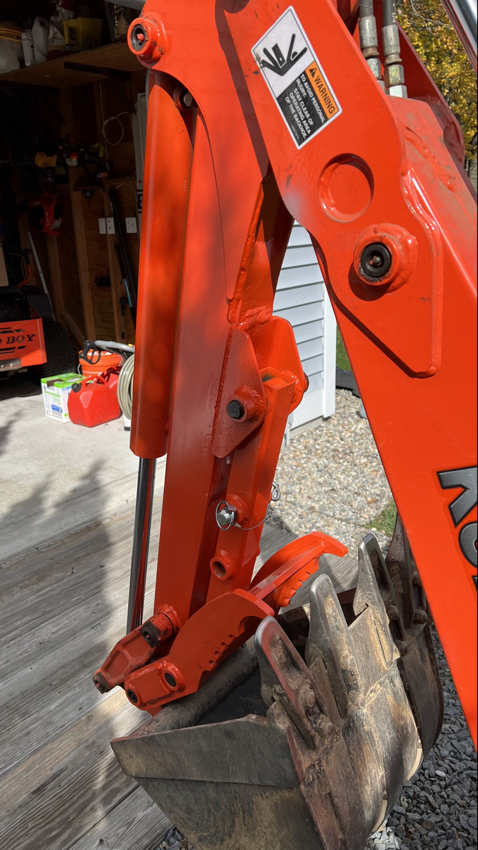

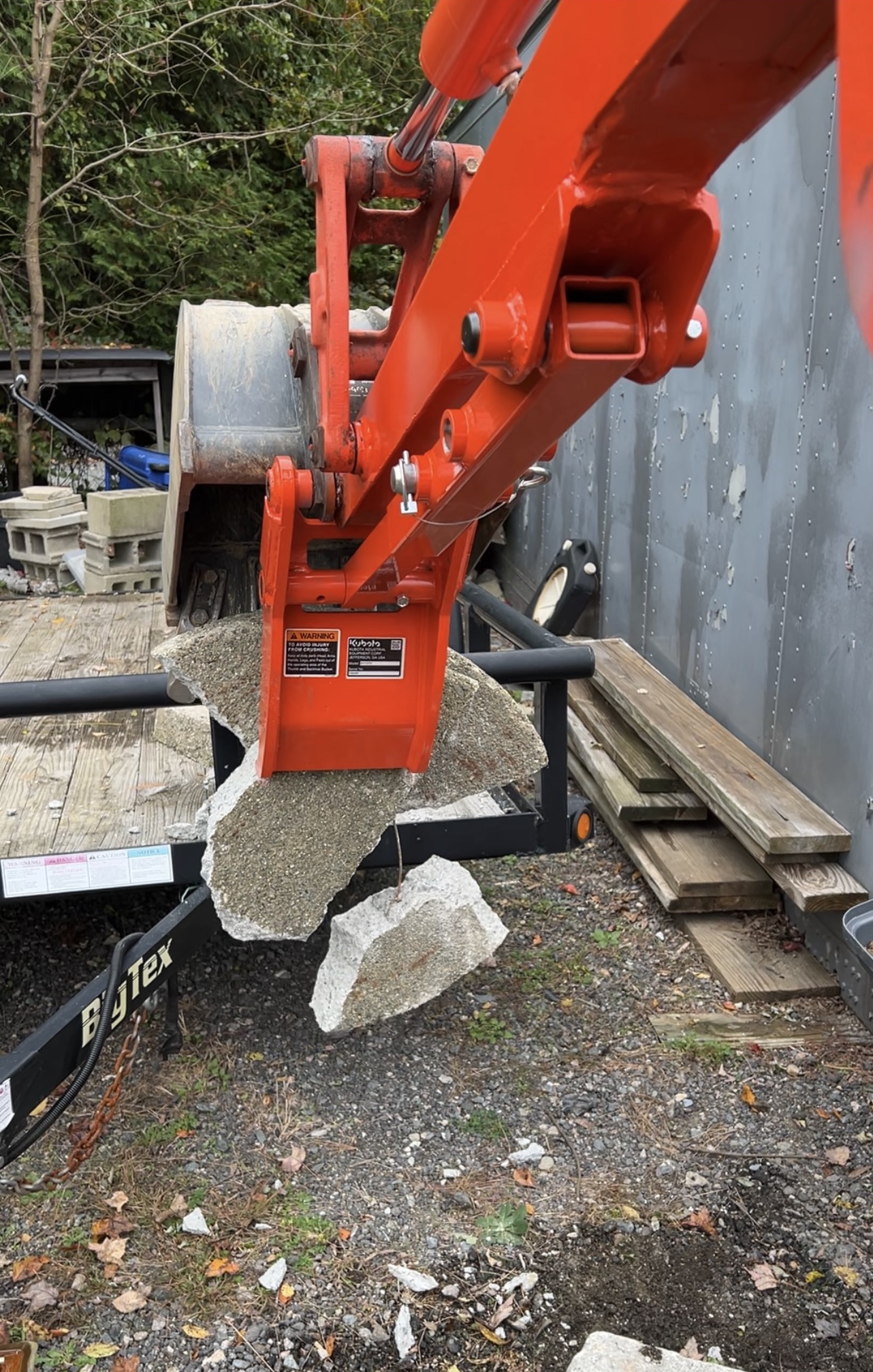

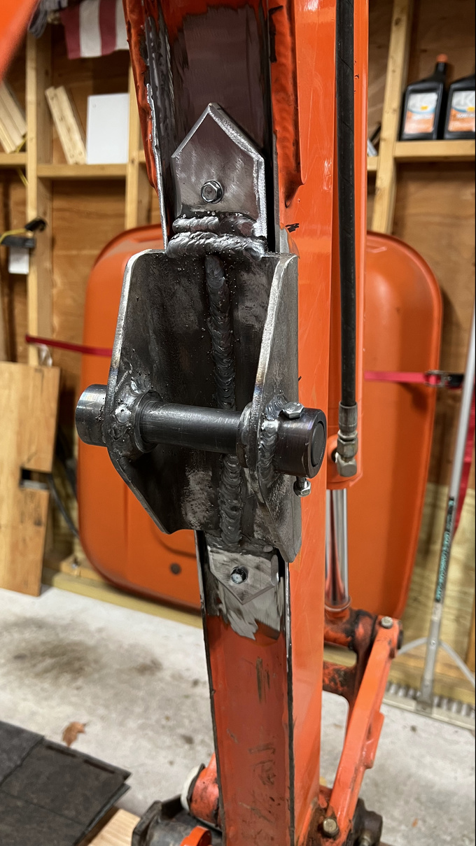

I have a BH75 backhoe and added the BH1976 thumb. I had to fabricate the pivot point on the arm as you will. I took a lot of measurements of a B3050 with a B76 backhoe at the Kubota dealer.
Here's what I ended up doing...
Bought an extra pin to fabricate with. Used it to make the bushings, and align everything.
Sanded the backhoe arm and drilled a couple holes to screw, and mount the assembly in place to weld it.
Once welded, I used some auto body filler to create a nice smooth factory looking finish.
Had some concrete to get rid of, figured it would be a good initial test. Worked great.
