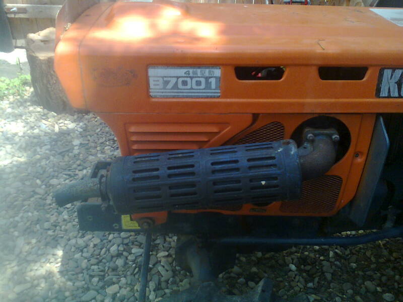

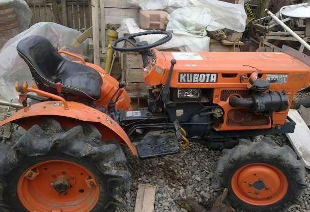

He says definedly it is a b7001 and it's fitted with a water pump, I have some pictures taken by my mate and sent through wathsapp so they are not in a good quality. the stickers seem to be the original ones and the paint as well...unfortunately I don't have any pics showing the serial number stamped on the frame (or what was left of it after destroying it)

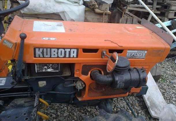

There is no water pump on that 7001.
I'd love to have that mirror though.
7,790
2,996
Me too! And the matching one for the opposite side, as long as I'm dreaming....

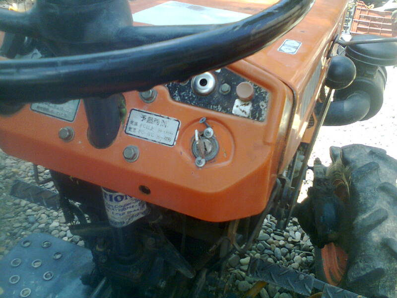

looks like a nice straight JDM B7001 indeed, i think you may want to organise a new ig switch though;)
Mirrors, if you other guys were not so far away i sell you the pair i have just like those...:D
