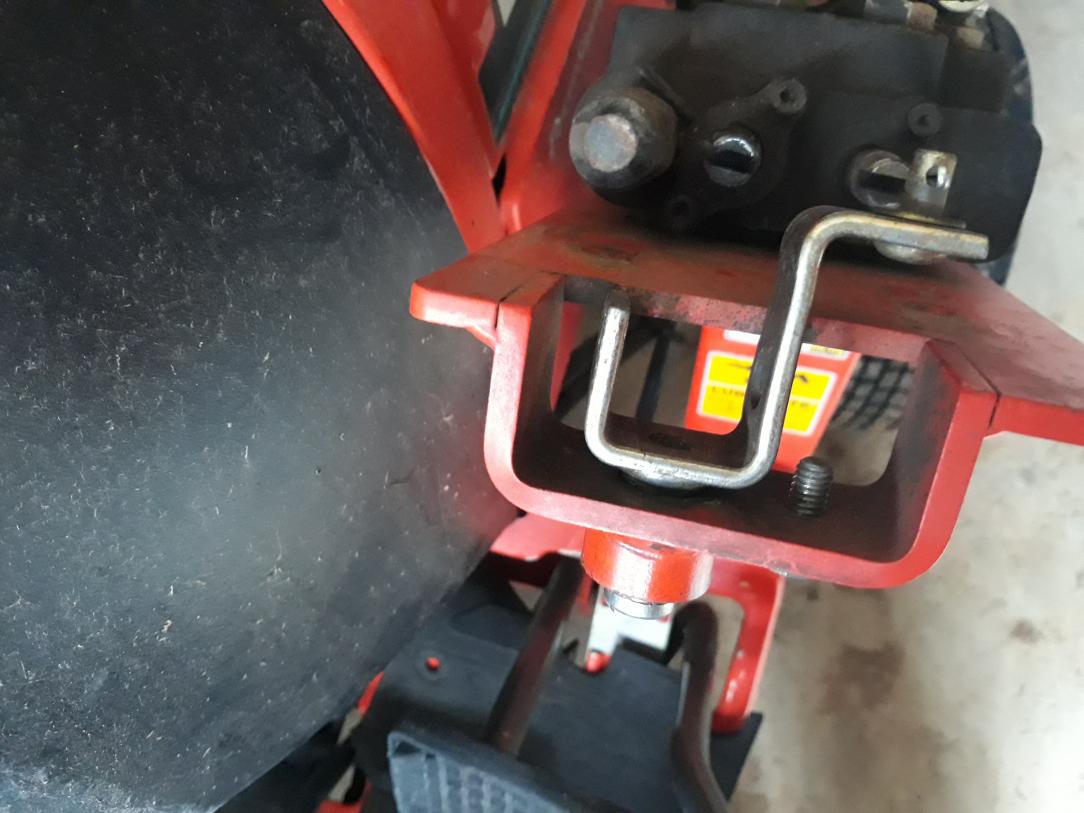

I am doing some preventative maintenance on the "Old Gal". I have some slop in the blade (same as a loader) control valve linkage and I cannot find any parts break out online.
The model number is B2056 and the serial number is 10843. Here is the question... is there a wear bushing in the frame where the yoke pin of the attaches to the frame?
It looks and feels like there is one in the pivot hole... here is a couple of pics to show what I am talking about.

I went noodling around the Kubota Corp. site for the parts breakdown for maintenance repair. I found everything but the frame post the control valve mounts on. So... queried google. This is what I came up with... with pictures!
https://www.tractorbynet.com/forums...94671-kubota-b7500-sloppy-loader-control.html
He used copper pipe to do the change out. I went to ace hardware where in the nuts, bolts and screw section I found a 5/8 ID x 11/16 OD oil bronze sleeve bearing that is a perfect fit!... Thanks for those that helped me locate this McGiver solution!
