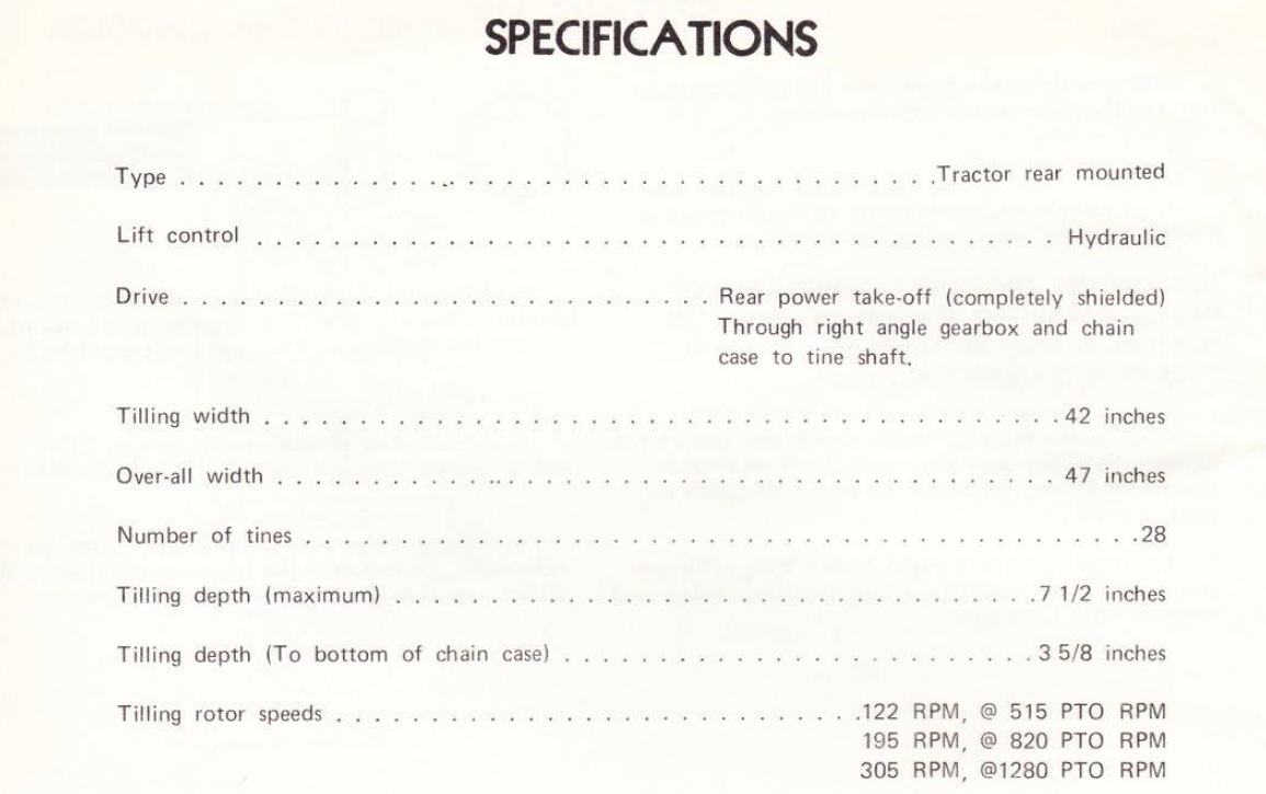

Ok problem solved Someone on epay has a copy of the Kubota B40C tiller. in the photo's it shows the speed 540 RPM Will be here by the 19 LOL from Buffalo to Pgh. Well at least it should have part numbers
Thank everyone for helping me on this and the Cornhead grease Joe
