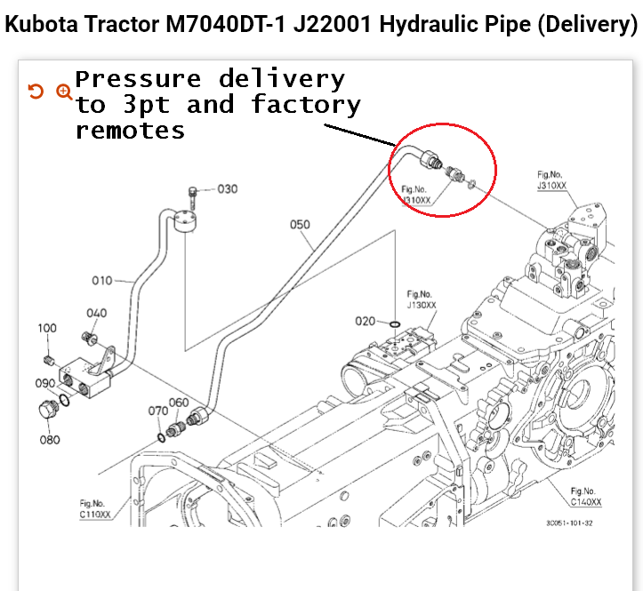

I had a chance to look at the parts books. You have an open station machine and I assume a loader as well. Here is the main pressure delivery pipe (power beyond from the loader) going to the rear. This is probably the easiest point to plumb in your new 3 spool valve.
  1. Disconnect/remove this pipe and run a hose to the IN port on the new valve.
  2. Then connect the power beyond port on the new valve to the port on the side of the transmission where the pipe was connected. You will probably need a new adapter to match your hose for that port connection. My guess is the port is BSPP but you need to confirm that before jamming something in.

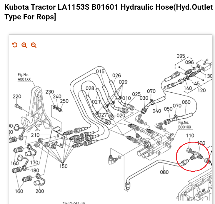

  3. Finally you need to run a tank return for the new valve. The second parts diagram is the plumbing for the loader valve. It varies some depending on the type of loader valve but they all seem to have the tee fitting I have circled in the diagram. Run a hose from teh tank port on your new valve to that tee junction.
