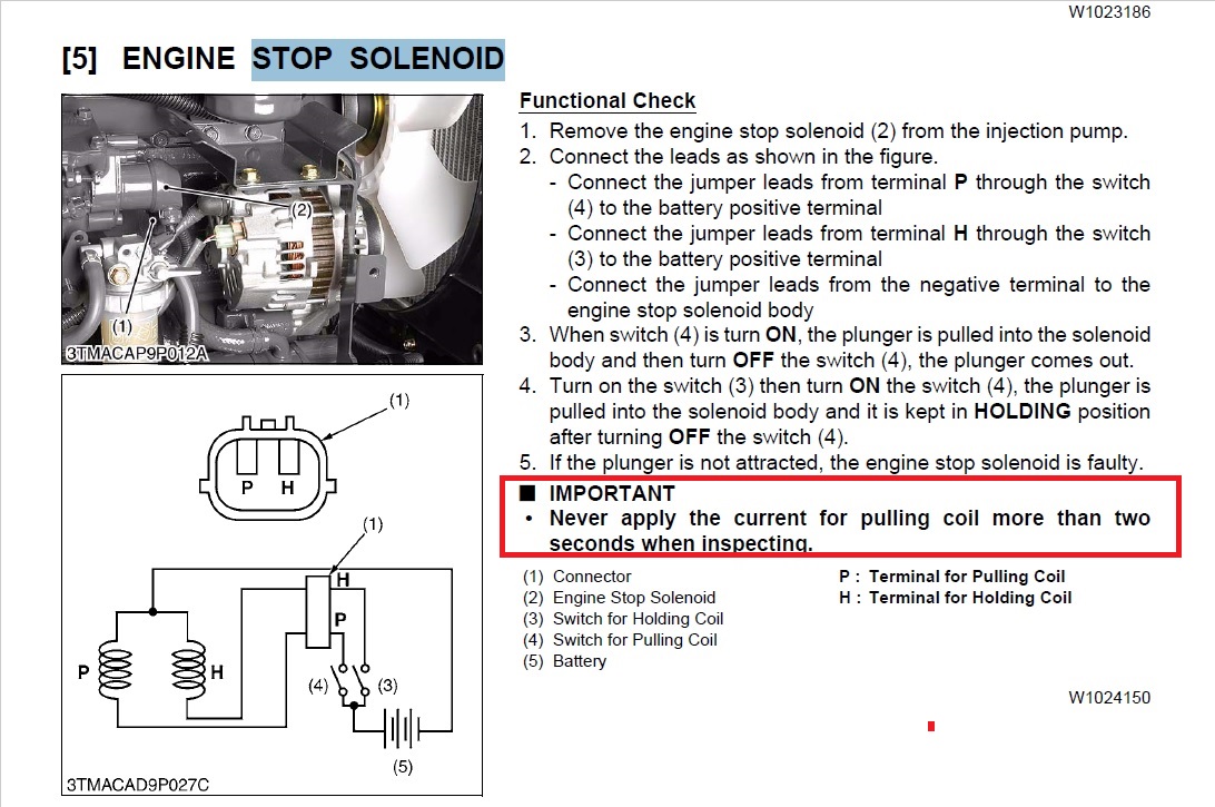

You need to understand how to test the solenoid as you can easily damage it.
This is the test procedure.
There are two internal coils. Your haphazard testing may have already damaged the unit.
There is an internal switch which cuts power to the pull coil once the plunger moves.
This is not a do it yourself project if your skills are weak as you can easily destroy expensive parts.

I have the shop manual, read this section and did not apply current for more than 2 seconds. I concur that I may have misunderstood the test procedure, because when they referred to “the switch”, I assumed this to be the starter switch in the tractor.
As I said,. I first removed the wiring harness from the solenoid and checked the voltage. Zero volts with key off... 4 volts on each side (2 positive wires P and H if I understood the description correctly, one start and one hold). I still do not know if this is the correct voltage to engage the solenoid, nor could I find this in the manual. I know this step was not part of the test procedure, but it seemed reasonable to see if any power was getting to the solenoid before doing anything else.
My second step was to have the solenoid still wired up to the tractor , but removed from the injector pump, (but grounded to it), so I could visually see what was happening . Turning the key started the tractor (which did not happen before removing stop solenoid), the stop solenoid did nothing. It seemed a reasonable conclusion that 4 volts, delivered to the grounded solenoid, via the tractor ignition switch did not cause it to work as the manual suggested it should. Am I missing something? If so, what?
I was still left with uncertainty because I did not, and still do not know, if this voltage is sufficient to cause the coils to engage as they should.

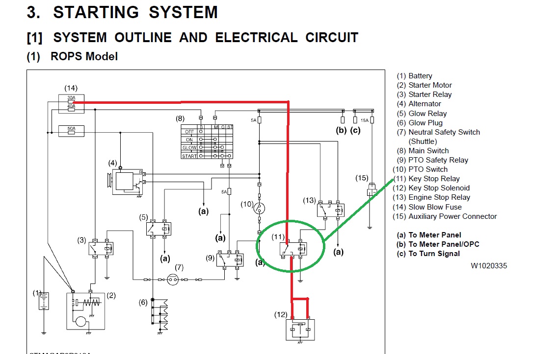

With many systems on today's tractors they do not tolerate a 'lets try it and see," approach and parts are destroyed in a fraction of a second. At 76 years of age, in my early years I had lots of parts go up in smoke or, if hydraulic crack. I had help from many and gradually learned.
Back to your situation.

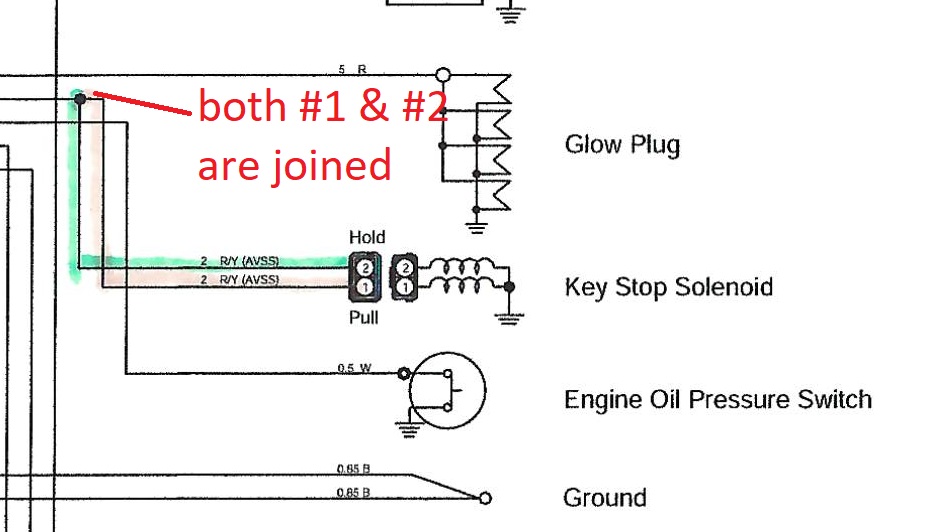

There are a series of wiring diagrams for the different models of M7040 so posting your exact model will help ensure you and I am looking at the same wiring diagram
Any time you are seeing low voltages on a tractor without the latest electronic systems there is a problem. Usually rodent damage is the first to suspect as chewed wires can cause current paths to change resulting in low voltage at the end of a wire.
Although there are two wire terminals on the stop solenoid a short distance back in the wiring harness both join together.
The fact that you are measuring 4 volts on both P & H just confirms they are joined.

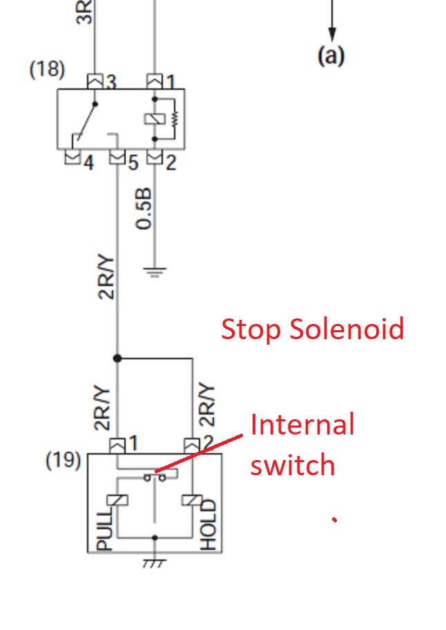

The circuit path to the stop solenoid as far as the main power supply is concerned is simple and I have marked it in red.
Locate the key stop relay #11 and with the key on measure the voltage going in to the relay and coming out of the relay. It should be 12 volts more or less and if it is not, then you need to work your way back to the slow blow fuse looking for damage or corrosion.

@Dave_eng now you have raised more questions on that circuit.
As a mechanical guy the circuit diagram symbols are somewhat difficult to remember what they mean so it may be obvious to a more electrically adept mind.
But as I understand the key stop solenoid operation the solenoid is only in operation to stop the motor for a few seconds so what is the point of the holding circuit? If it was a run solenoid I could understand the need for a holding coil to draw less power and to stay cooler over the time the tractor is in operation (running).
I guess the stop solenoid pulling coil is just not robust enough to hold for several seconds and survive probably due to economics of design?
Perhaps Kubota just uses the same solenoid in both situations and get a volume discount on it

When you are measuring 4 volts you have removed the wiring connector from the solenoid.
One probe is against the terminals inside the connector. Where are you grounding the other multi meter lead? It should be against the metal of the engine i.e. a battery ground.
it should NOT be against the terminals of the stop solenoid or you will read low voltages because your reading is in series with the internal coils.
Dave

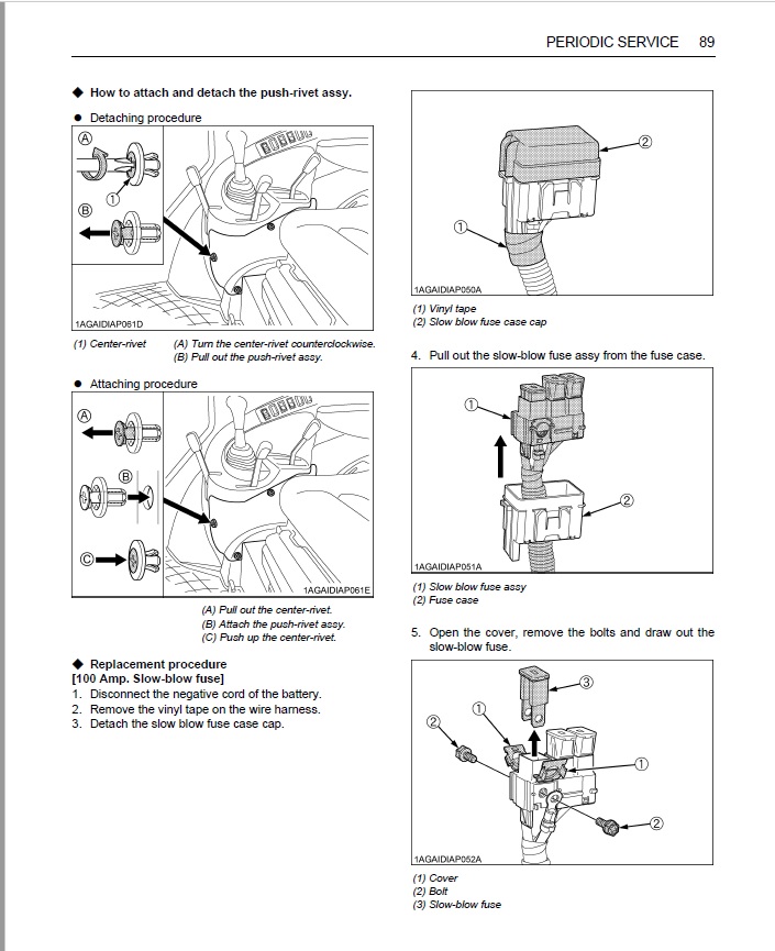

Please advise on your specific model of M7040. I have not seen it if you already have.
The slow blow fuses are in a removable panel below the gear shift lever.
A nice place for nesting rodents.
I will try and determine which fuse is involved but so far it is not obvious in the Operators' manual.
I am hoping you will remove the panel and see rodent damage immediately.
I leave my panel off because the cables for the remove hydraulic valves freeze up and the warming cab once the engine is going for a while free them up.

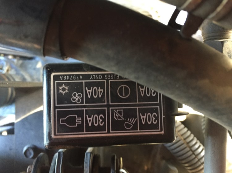

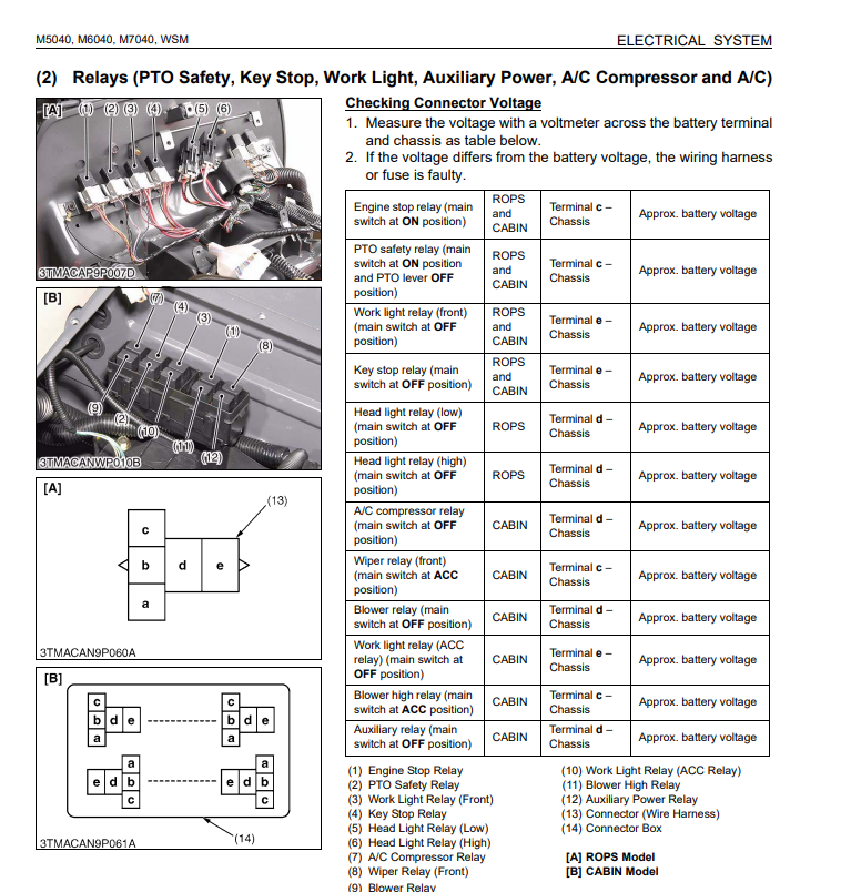

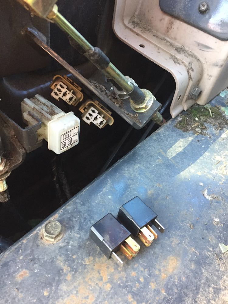

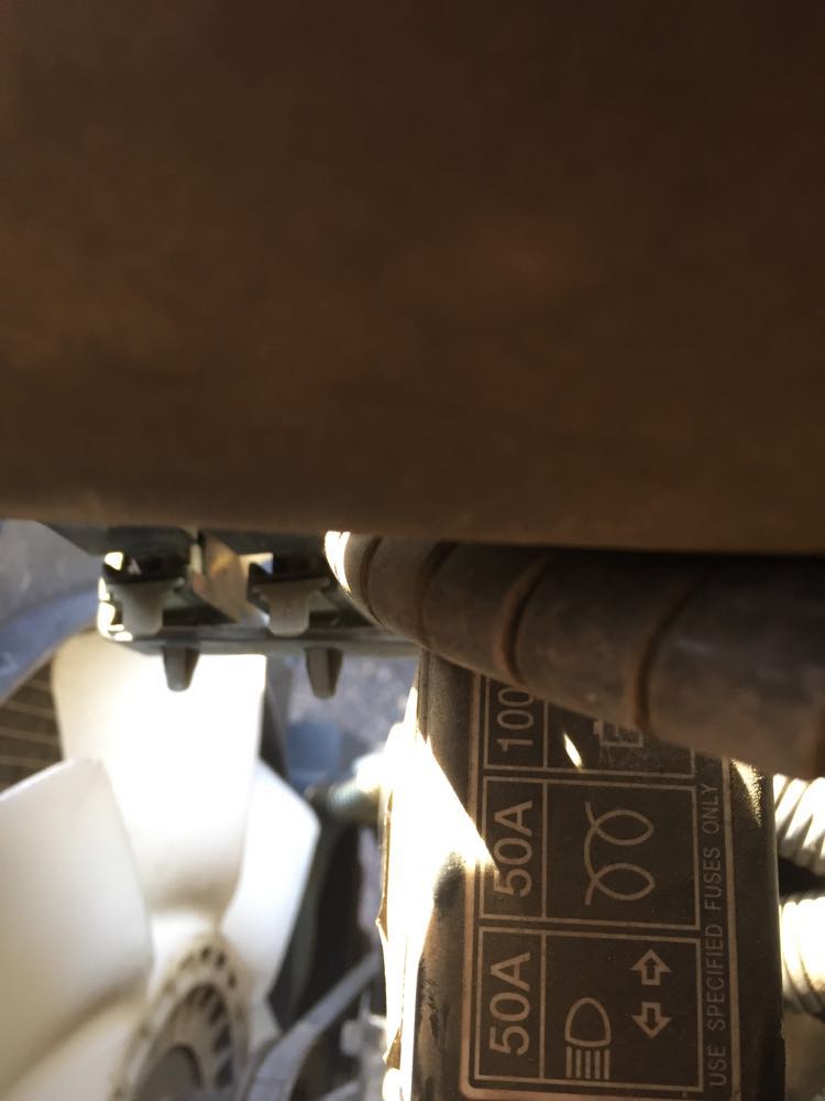

Hi Dave. My Tractor model is DTHSC. I think my layout must be different. I took photos of what is under the gear lever. 2 x 20 Amp fuses and 2 relays... (not sure what they go to)... removed so you can see them. No rodent damage..
I think my slow blow fuses and relays are in the engine compartment, behind and above the rad. See photos.
I have two relays, and two sets of slow blow fuses... I don't see any rodent damage there either.. I have that panel open as well... for the same reason!
The smallest image is the two large relays. I believe the one on the left is the key stop relay, because the engine will not start with it removed, but will if the one on the right is removed. . Input voltage = battery voltage with the key on.
I am guessing (from my manual), that the one on the right is the "Glow " relay).. It's been working fine.
Please pardon my ignorance, but how to I test output voltage on the relays? I swapped relays (they are identical) and the tractor starts with both.
The last 2 images are what my manual shows for relays... But I have no idea where they may be!

Can anyone tell me where the bank of relay's are... physically... on the tractor ? View attachment 90392
Steve
This is a quick and dirty answer from the top of my head.
The seat sits on a metal box. On the front face of his box (which is facing the pedals) is a metal panel held on by 4 bolts. Remove that panel and I think you will find electrical stuff inside.
Not certain if this will be the relays you are looking for but until I have time to do more research this is my best advice.

Steve
Dave
Thanks Again Dave... Thats where I will look in the morning... but... first day of deer season... so a late start...
