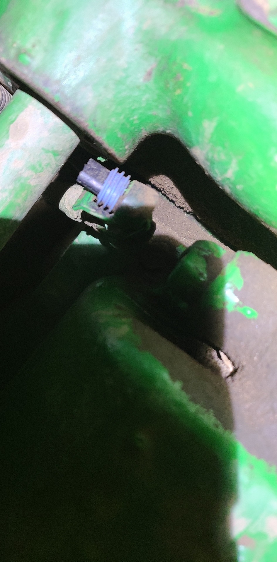

I think this would be considered off topic, we have a JD 7130 that is stuck in 4wd because a stick got up near the 4wd selenoid and did somthing. I have no idea which wire or even which selenoid controls the 4wd on this tractor but I hate having it stuck in 4wd. Deere will be along to fix it in 3-5 billion years or so but if I had a schematic I could probably find the loose connection and fix it myself.. Anyone know anything?

No problem, and friendly reminder to remember to clean the connector before shoving it back together! Maybe some contact cleaner? I'd hate for you to have to try and splice and solder a new connection on in that cramped space.
It actually wasn't full of dirt, the stick went in it like a little plug and came out in one piece so it was all good :) the little num for holding it in is gone but it seems pretty solid as is. So glad it's fixed, that has been a great tractor and driving around on hard ground in 4wd is not great.
