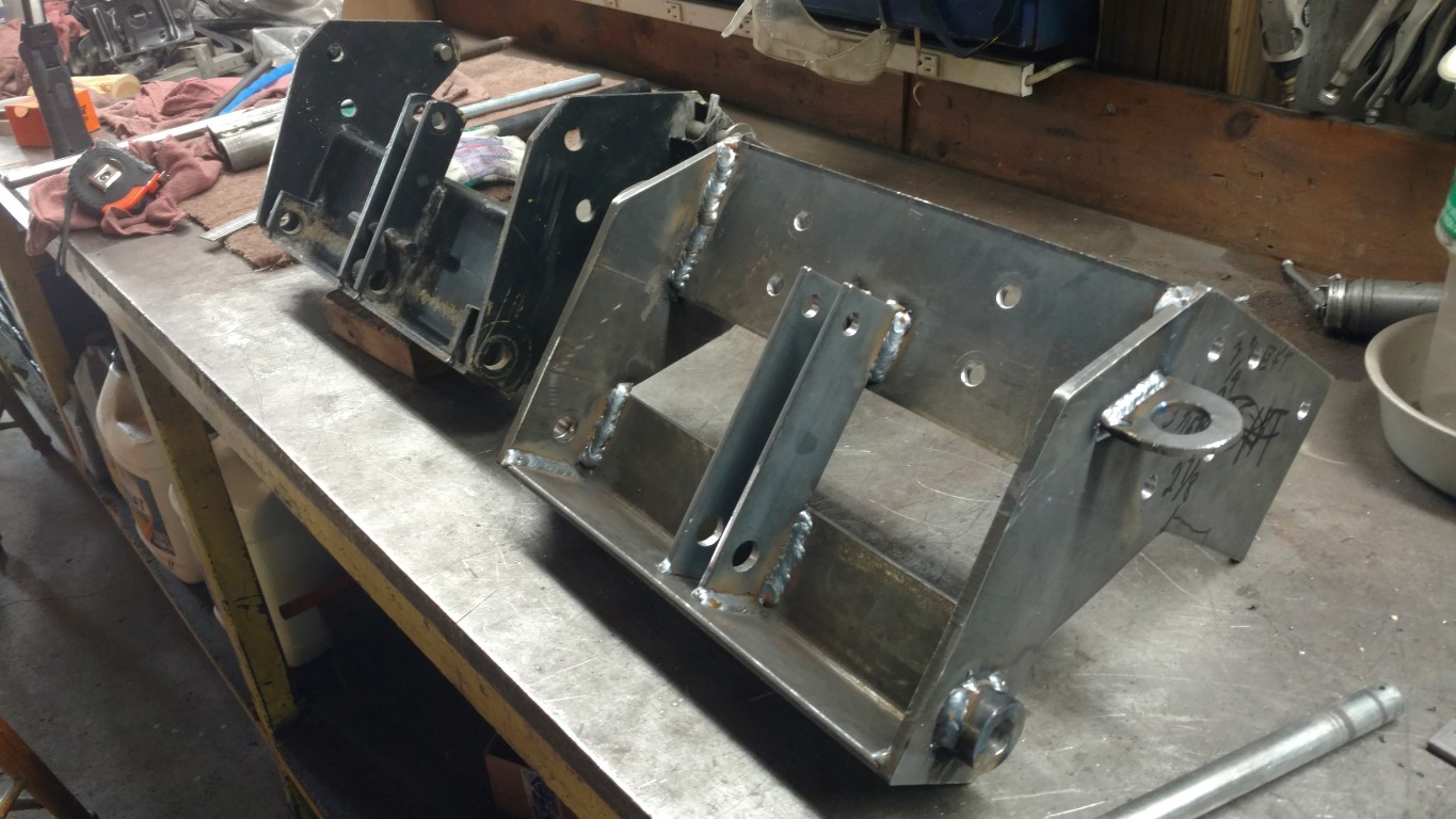

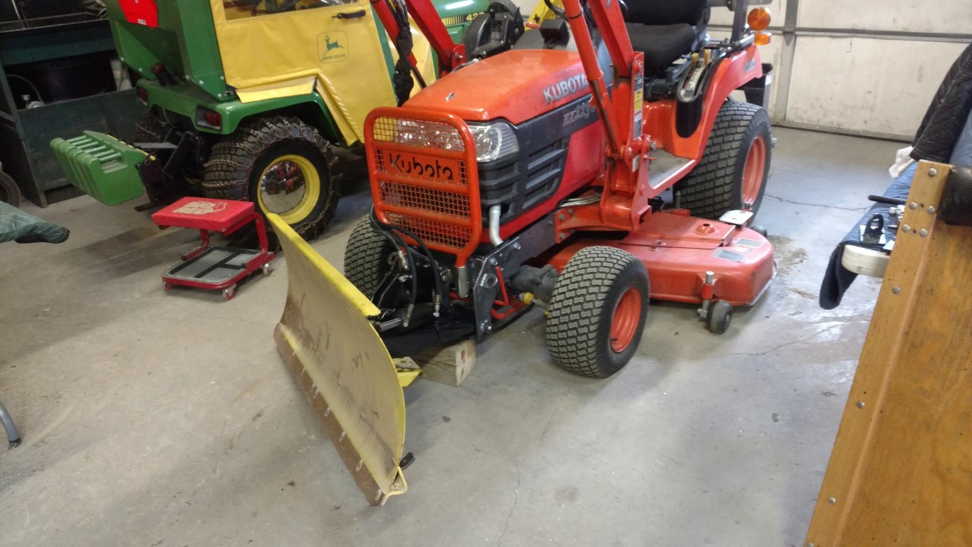

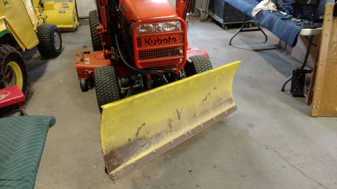

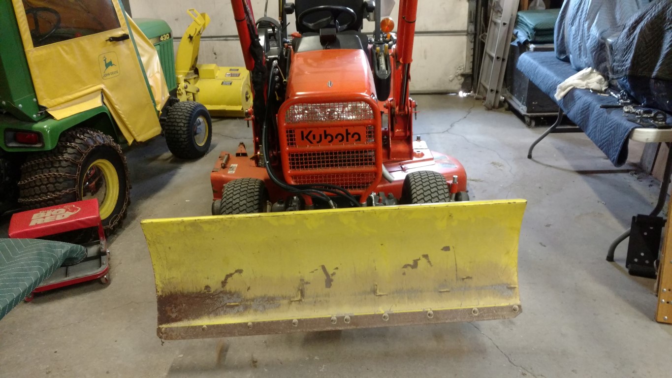

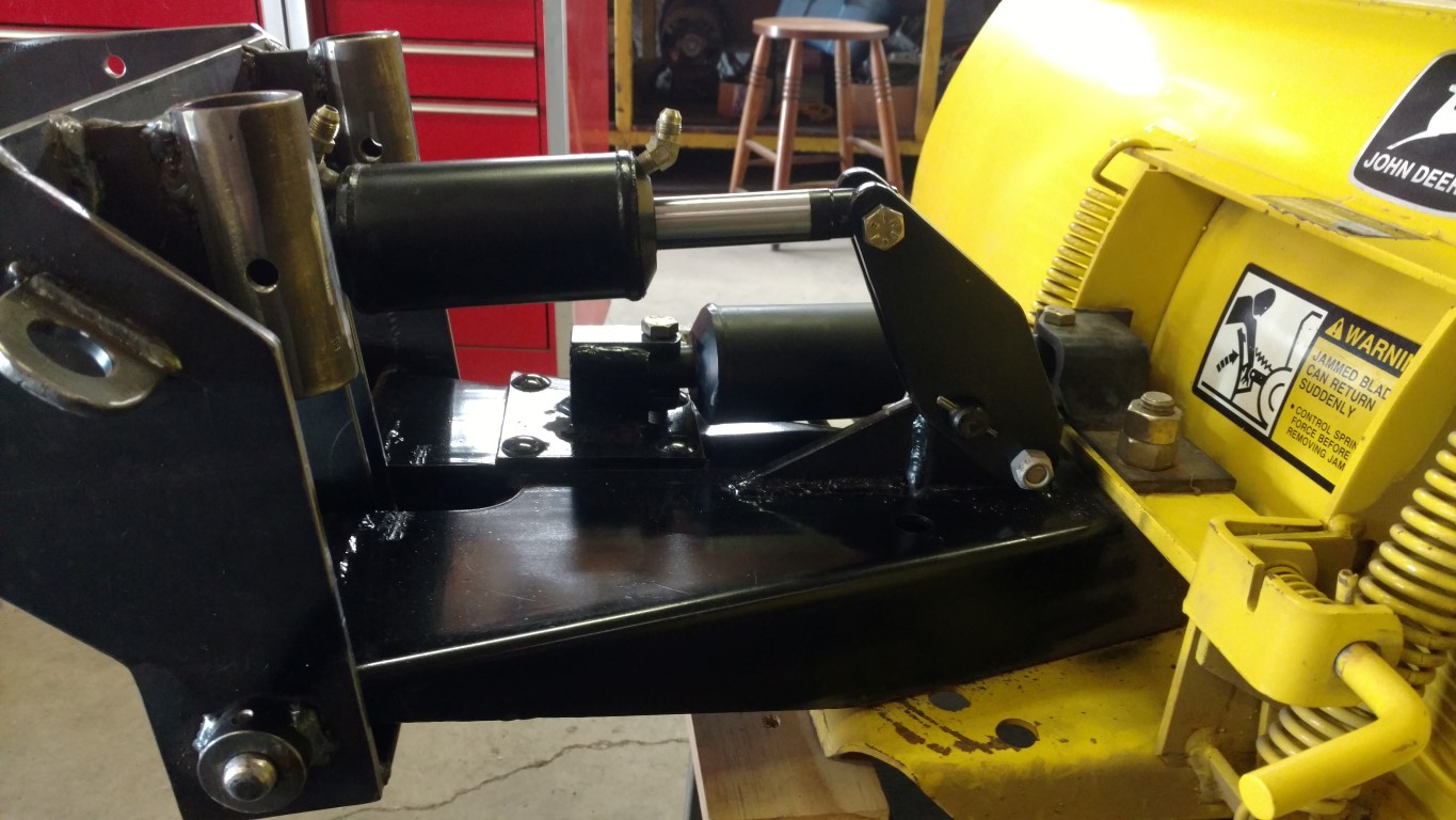

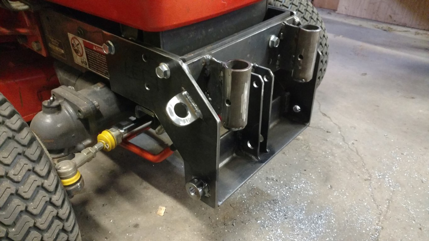

Since my JD430 has been relegated to snow blower duty, I decided that I would make an adapter to mount the blade on my BX. The blade is almost like new, has only been used three times, twice for snow and once to level a couple loads of base material for my shop drive. That was in '84 and the blade has been gathering dust in the back of the shop since then. I pulled out the mount that goes on the 430 and did some measuring and thought making an adapter would be fairly straightforward. A local fab shop made the major pieces for me, and I drilled mounting holes in the side plates and the BX frame to mount them. Welded all the pieces together, including mounts for my brush guard and gave it a test fit. Everything fit fine and I even used spacers between the adapter and the BX frame to allow for the powder coat it will get soon, and attached the blade with the pivot pin. I did have to make a new set of plates that attach the lift cylinder to the blade mount frame to get the range of motion correct for the lift cylinder.
Yesterday I made up the four hydraulic hoses, two for the lift cylinder and two for the angle cylinder, and put them on today. I hooked them up and everything works great.
I disconnected them and took the blade and the adapter off this afternoon, and will take it to the fab shop to be powder coated Kubota gray.
And yes, I did this with the FEL on the BX. I put the prop on the lift cylinder and rolled the bucket back all the way, used the control stick to release any residual pressure in the lines and disconnected the FEL lines. Worked just fine and I didn't have to completely remove the FEL.
I have a couple of little grading projects I want to do this summer that will work better with the blade that they would with the FEL. It will work better for snow removal when (if) we get wet snow that clogs up the blower on the JD.

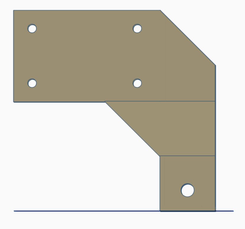

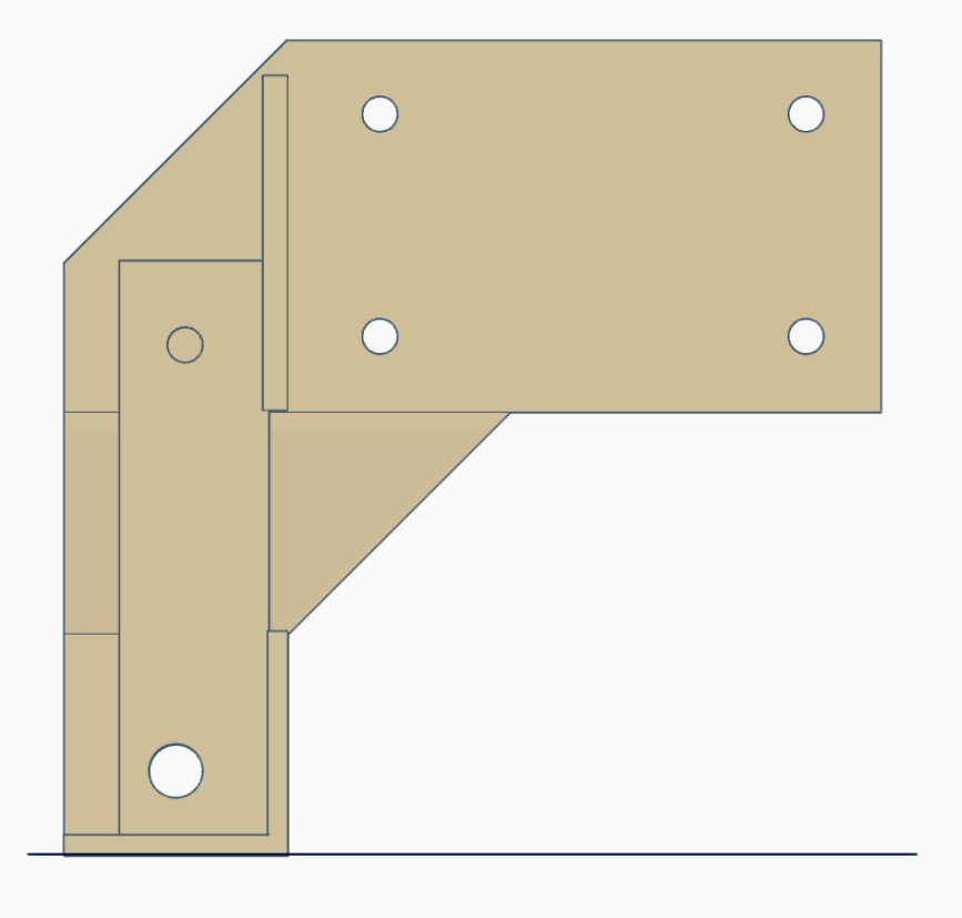

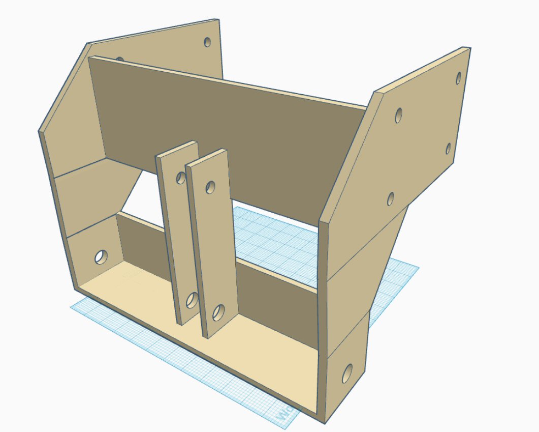

I have the images of the assembly, but they don't have dimensions on them. I can do some measuring tomorrow when I go down to the shop. The trickiest part was malingthe slight bends required to widen the mount about 1/4" where the blade pivots as it's just a little wider that the frame of my BX, about 13 7/8" if I remember correctly. The side pieces are made from 5/16" plate, the bottom angle is 1/4" X 3" X 3" angle, and the vertical pieces are 1/4" X 2" flat stock. I ended up using a different pattern of bolts to attach the sides to the BX frame that what is in the images.
The nice part about this mount is that it stays on the tractor and doesn't interfere with the mower deck or FEL.

I started with cardboard for the patterns. As it got dialed in, I changed to 7-ply aircraft plywood and cynacrolyte glue to bond it together. I too designed the mount to be used without interference or need R&R for the mower Assy. Doing that was a little tricky. I used it for 5 years mainly pushing rock and dirt without a single issue.

I only made one mount, in the 4th picture, the JD mount for the 430 is in the background. I also added the mounts for the brush guard after that picture was taken. I made the mount about 1/8" wider than the BX frame so it would slide over it easily, but clamp fast when the bolts were tightened. With three 1/2" frame bolts on each side and four more in the front, I think it'll be plenty stout.

Well, I debated having it painted or powder coated Kubota orange, but all the paint except some on the front of the blade is like brand new, so it wouldn't improve the appearance. It's only been used three times on the JD, once to level a truckload of gravel and twice to plow snow. Pushing more than a small amount of snow made the front end just slide around if the blade was angled. That's why I bought a snow blower for it.
