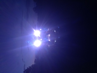

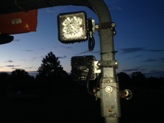

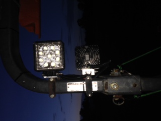

Wired up the tractor for lights on Saturday, installed the first three Sunday and the last two this afternoon. I'm impressed with the $9.99 lights I got off Amazon. They are super bright 9 count LED lights. I went with 30 degree for the front and 60 degree for the rear. I also added a 110 degree four count LED light to the center of the ROPS facing the rear. That one alone was bright as could be. But I decided since I have a backhoe it'd be nice to have three. I ran the power for the lights from the rear work light wires to the cover where the range selector and cruise control levers are. I used two toggle switches. I'm extremely happy with how this came out! I'm glad I can work well into the late night hours since its so darn hot during the summer, and gets dark early in the winter (not that Florida really has a winter.)
