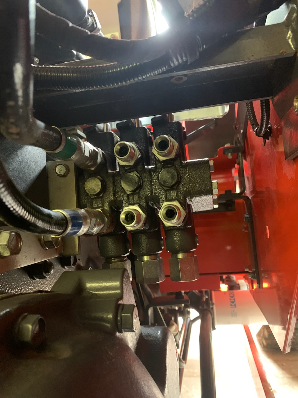

IMO there is only one reason to go OEM and that's integration and aesthetics. On an L01 that is minimal - the factory remotes are half assed and I bailed om them as soon as I got a good look st what my money was going to get me. The third function is pure third party.
That said I would not use one of Summit's (or anyone else's) electric rear remote kits. A three spool manual valve works better and costs less. You can spend a little or a lot. I have sold a lot of kits with Summit valves and no complaints.
When it comes to third function the biggest issue is the replacement joystick handle with switch. For what they are they are ridiculously expensive. If you can live with a cheap rocker switch lashed to the OEM joystick you can do it for pennies. The valve and plumbing is generic and easy to put together for less than the cost of a turnkey kit.
The final hurdle is the TnT cylinders. Those are much harder to replicate. Look at Brian's offerings to see the difference.
