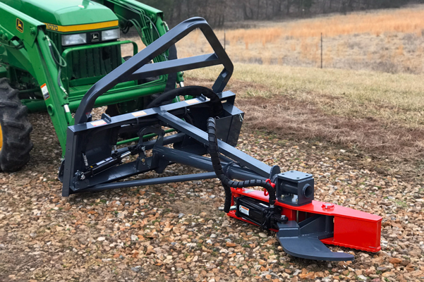

There is this type, but it is sized for bigger machines than your BX.

hmm, googled mini tree shear'...
Ah, that's the one i was talking about!
Still borderline for a BX, which is the main problem here. The one thing i would say is that it doesn't cut things and grab them in the same motion so if you can lift the attachment at all you can cut limbs with it. Now picking those limbs up to carry would be a maybe (probably not, on a bx). But if all you were doing was dragging things out of the pond you could certainly do that! Dragging is a lot easier for a tractor than lifting. :)
My 'log splitter' idea is similar to this thing but instead of a shear on the end of a rotating pipe, it would be a log splitter mounted along a rotating pipe. More of the weight would be inboard and on a bigger pipe so the diagonal bracing would be only near the base instead of reaching 3+ft out. I would hope the weight would not be 600 lbs like this thing :eek: but more like 300-350.

OK, had to zooooom the grabber picture to see the black spring on the black arms....sigh, old eyes....
should be able to 'somehow' add a 'trunk gripper' to the miniclip cutting bar, wedging the trunk between it and the red plate.
the big boys toys have a separate hydraulic gripper.....
That miniclip can rotate the cutter. I'd eliminate that in favour of a 'trunk gripper'. Should be able to reduce some weight, don't really need the A'section guard either.
