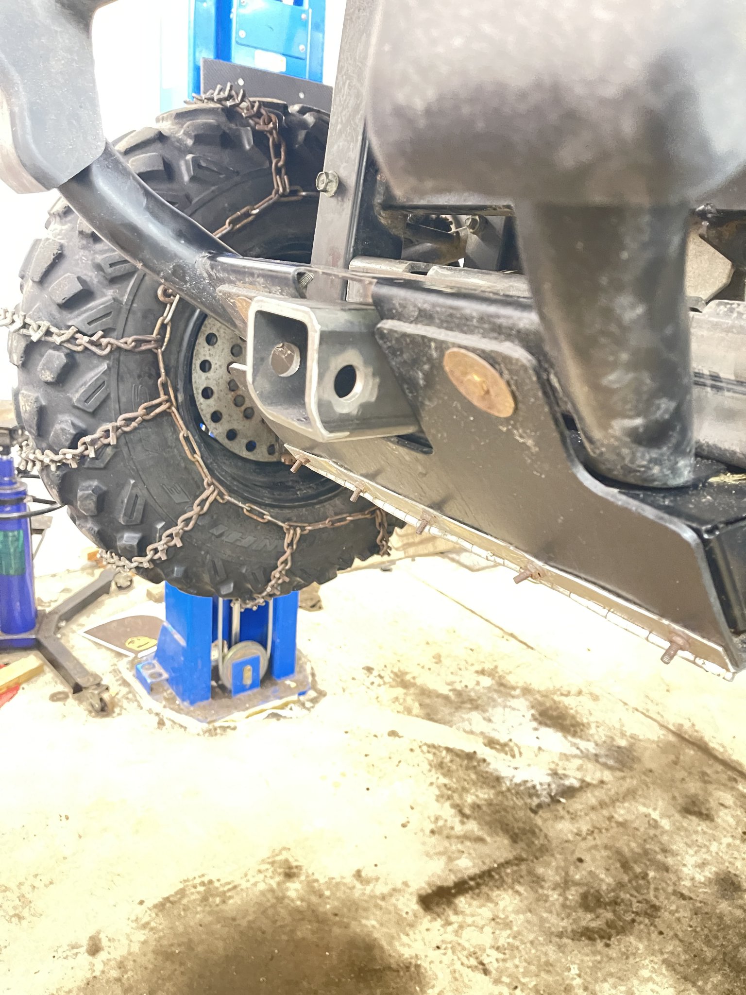

Then I access the area I think will be the “strongest” and begin to formulate my ‘plan”.
These lower bolts look pretty big, and I decide to incorporate them into my design.
The vertical holes on these "upright supports” will serve as some sort of “cross beam” attach points.
So its off to the Alro “metal store”……( My new favorite store, cause the “scrap pile” is getting low)
I make a “bee line” for the “clearance sale” section, cause at $1 per pound, it’s just too hard for me to pass up. ;)
I am envisioning, a horizontal piece being bolted in place with a 2” receiver “poking out” like this
This way I can use the winch in the front, or the rear if needed.
Well my first problem is how the hell am I going to access/use those “big bolts”. The “clearance section” only had 1/4 inch x 1.5 x 3’ rectangluar tube, so thats what I’m using.

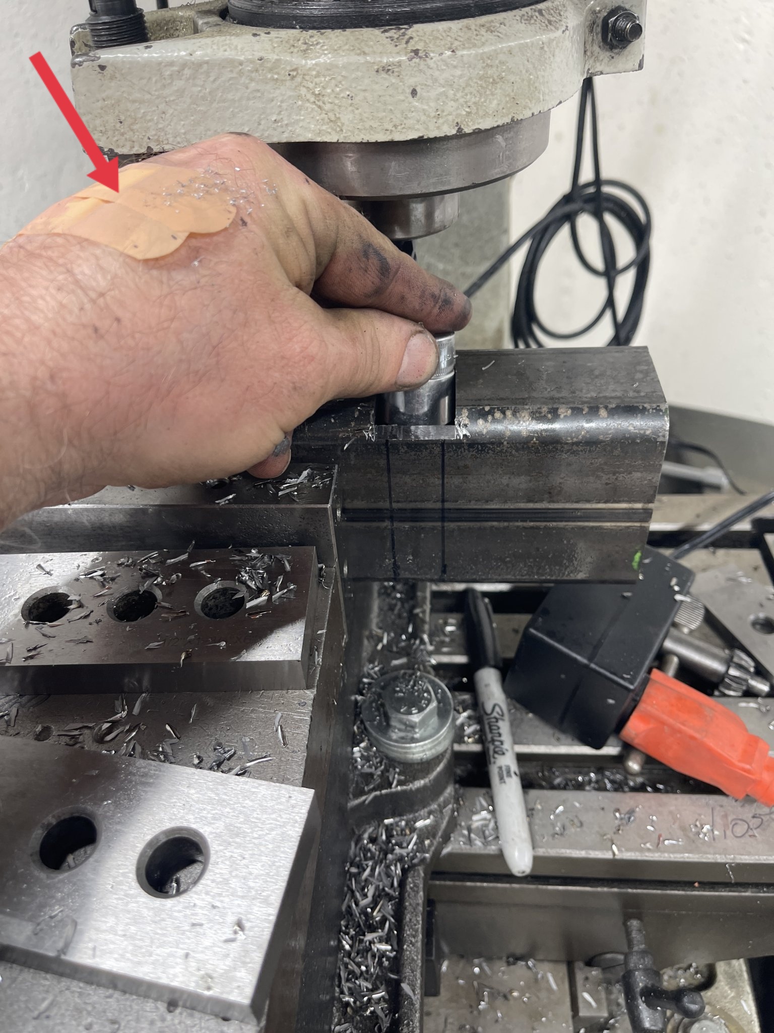

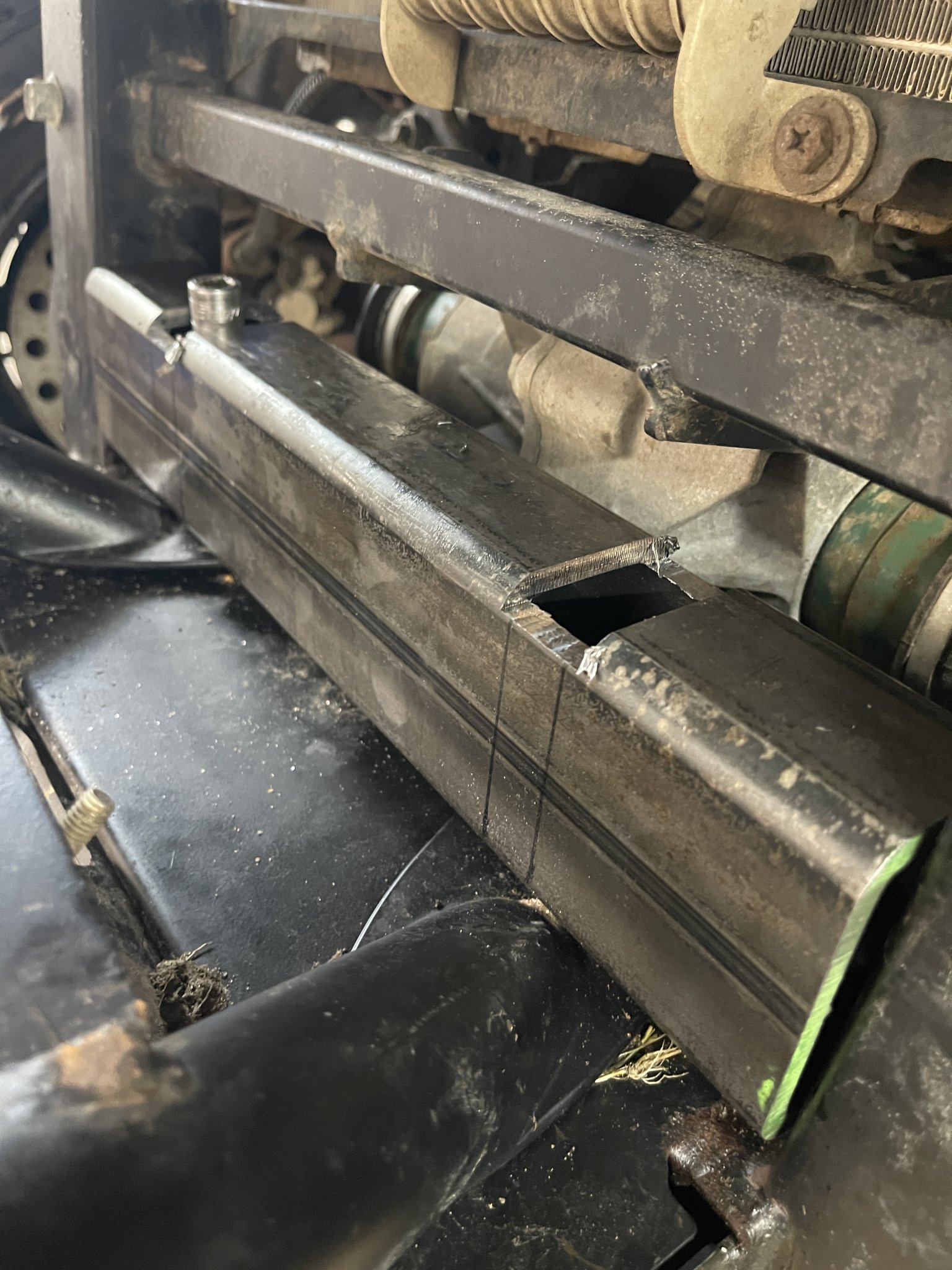

So I decide to mill some “access slots” for the bolt holes, and the plan is to weld the tube shut, then drill matching holes for those existing vertcal holes and use a piece of “all thread” to secure it horizontally.
Off to the Chi-Com mill…….
I take some careful measurments, then mark up the tube.
Then after a few passes, I run upstairs and grab a socket to make sure it will pass through the slot.
Then I flip it over and drill/mill the holes…..I go a little oversized to allow for some “slop” in my measurements
I have found, over the years, that trying to be too exact can be a "lesson in futility"

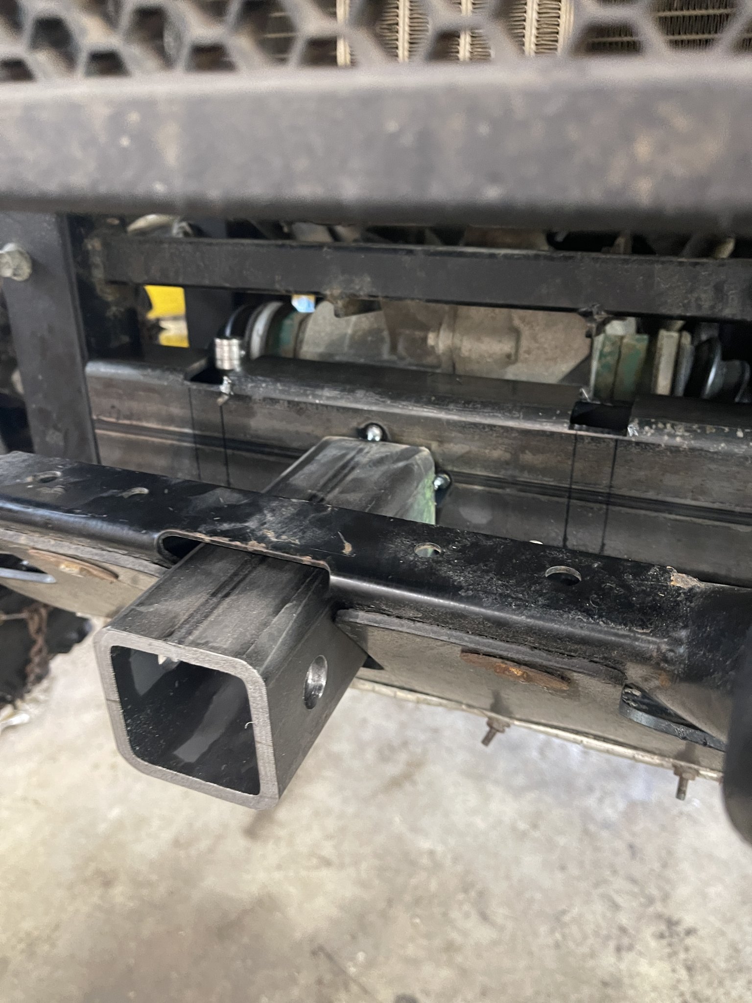

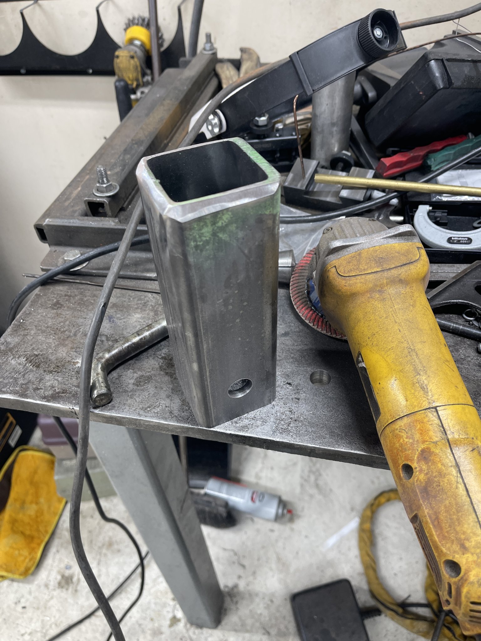

Now I "test fit” it……..
Its a little tight, but it seems like it fits well.
I cut a section of the 2” tube, drill the hole and chamfer it a wee bit, in preparation of a “full weld"
I was going to just weld it on, but I figured I best “test install/uninstall” it, so I decide to “tack on “ the receiver part and try to remove it.
MAN, am I glad I did not weld it right off the bat. it turns out to be a “smidge” too long to get in/out.
Now I’m feeling “all proud” of myself for not being stupid and just welding it in place.
Now it’s time to get creative with the Horizontal Bandsaw and grinder.
But WAIT…………Nothing is ever that easy.
Apparently those Chi-Com switch's only last about 30-35 years
So after counsulting my "OSHA safety manual" ;)
It’s decided to Hotwire that bitch…………So just like that movie “Gone in 60 seconds"
Houston……..we have ignition…...
Looks good and now it fits like a glove………...

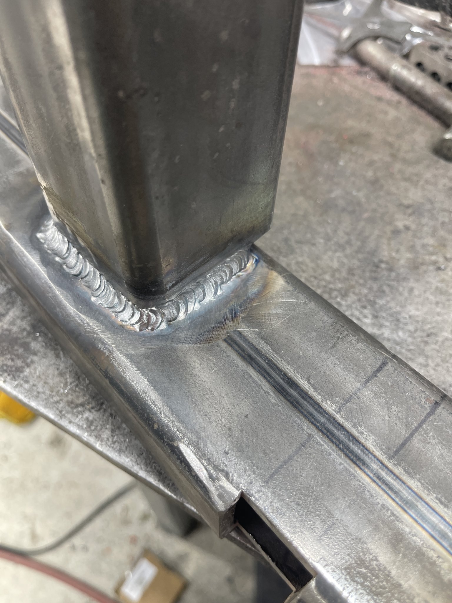

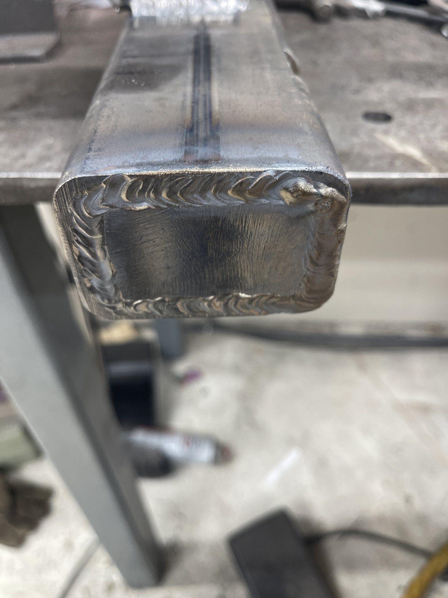

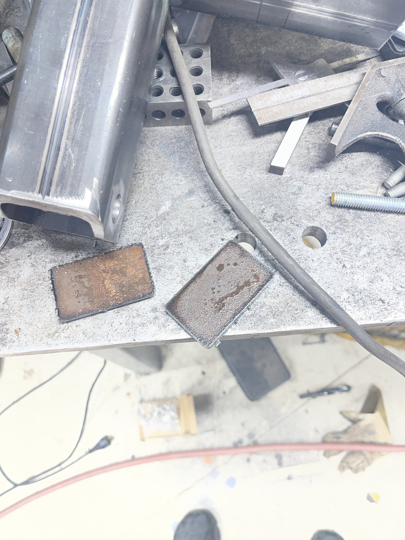

Now it’s off to the CNC Plasma cutter to knock out the “end caps” from a plate of “mystery metal"
Now for the “fun part”……..TIG WELDING!!!!!!!!
I clearly need some practice, but it’s dosen’t go too bad.
It’s not NASA quality, but it should be “Rhino good-nuff"

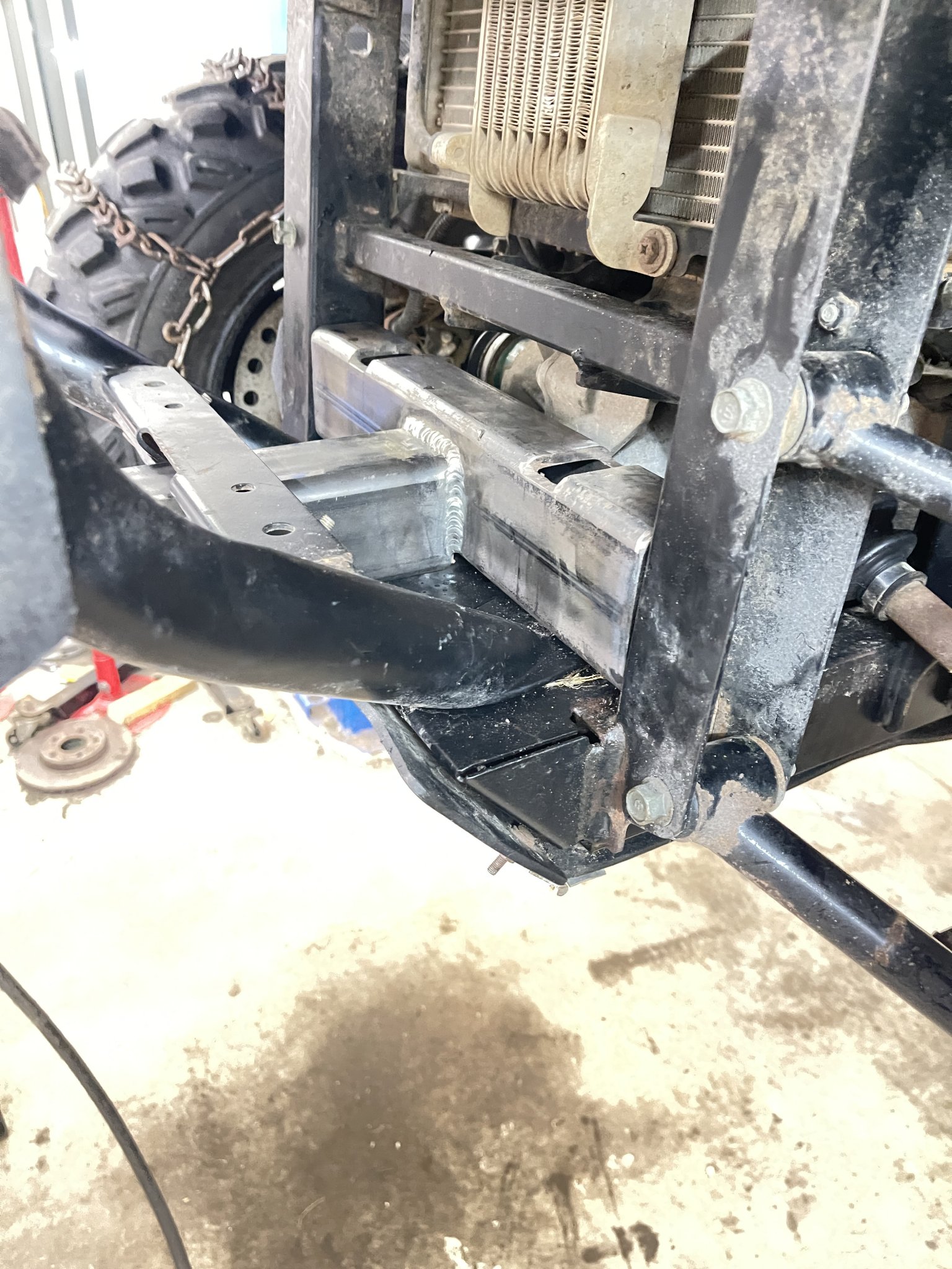

Sadly though…..The welds need to be “ground down” to make it fit…….
Well now it’s time for another “test fit”, and I decide to bolt her in place before I try to locate and drill the Vertical holes.
She’s looking pretty good, so I am stoked.

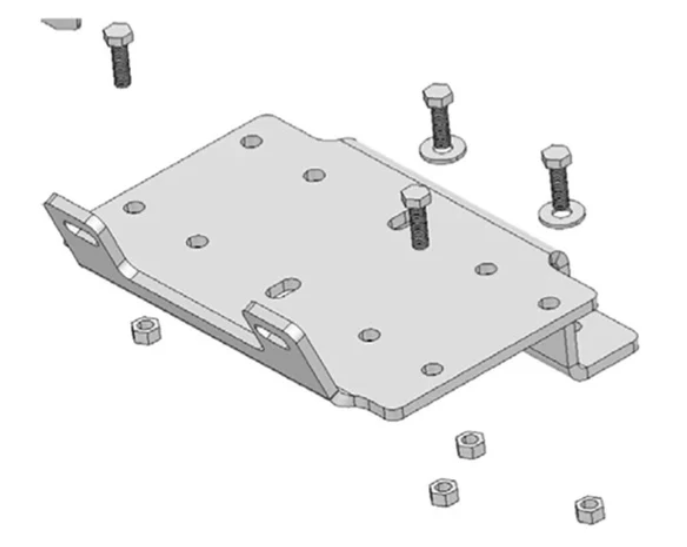

for our winches we went with Yamahas mounting plate. Kolpin sells similar. Good on you though for going custom. Here is diagram on how yamha / kolpin knock off tackle the project.
I used that same (or very similar) plate when mounting mine.
