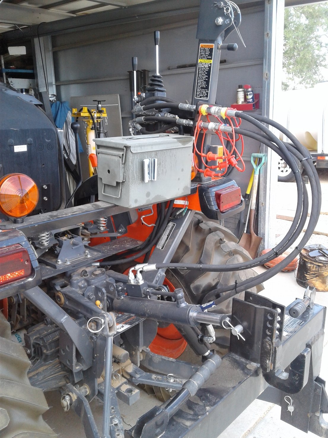

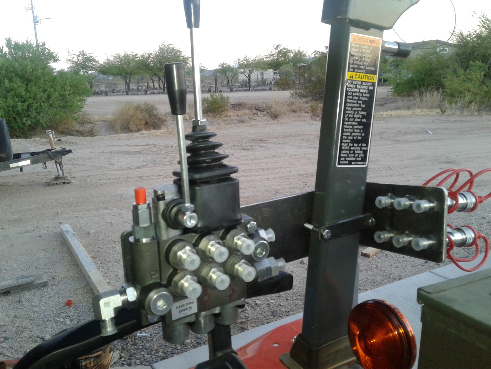

Here is my Top & Tilt i built. I used a joy stick for the top & tilt & a second joy sick for my 3rd function, rear or front I have 3 sets of quick disconnects. all together I spent $1300 for the complete set up. I came off of the main pump using the power beyond. it works like a charm.

My joystick forward/back for the top rear cylinder & the side to side is for the tilt. the 3rd joy stick is for ether the grapple or a 3rd cylinder on the rear.
