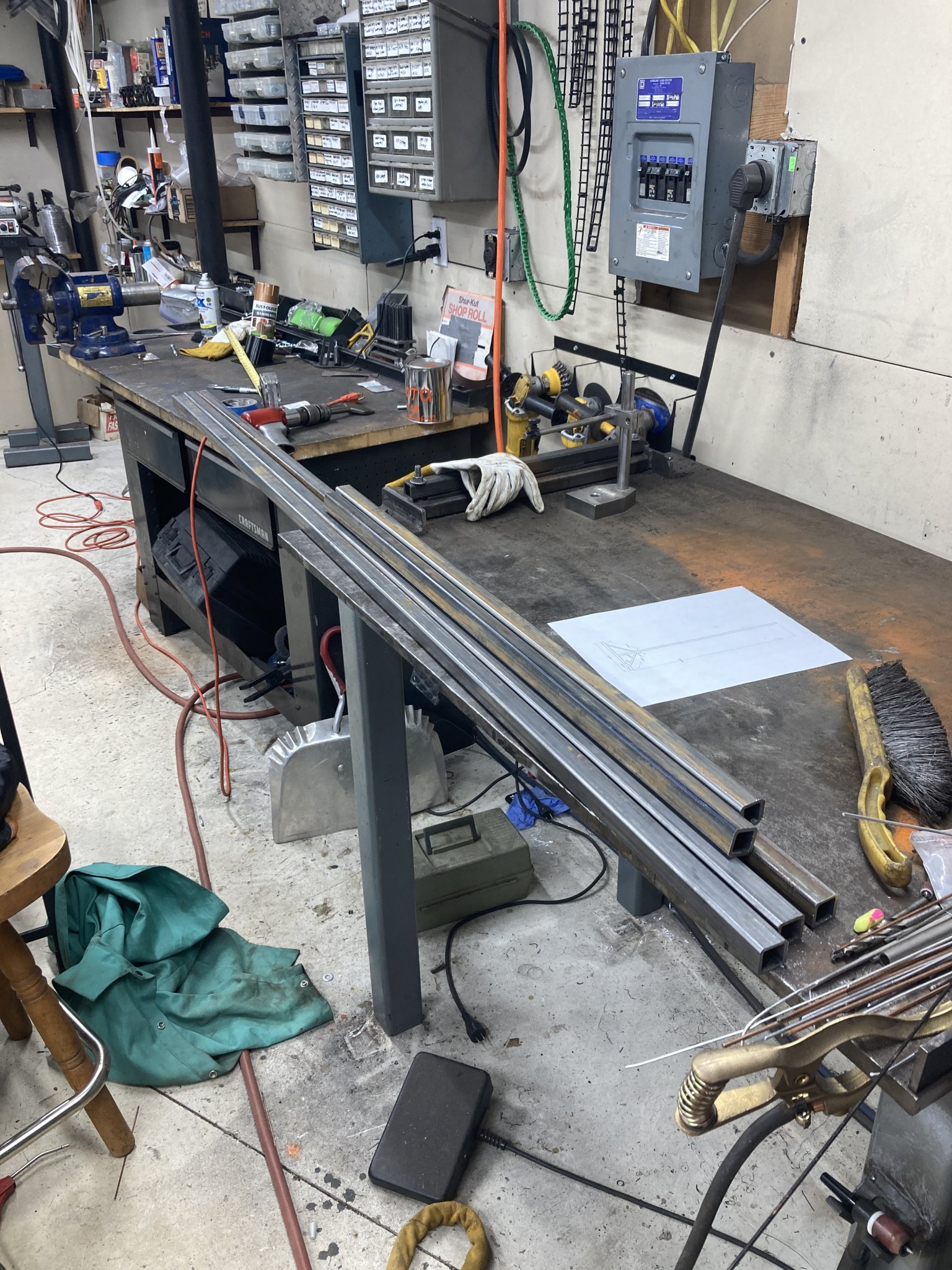

My SIL just gave me a lead on some 1x1 cold rolled steel, so I decide to use that.

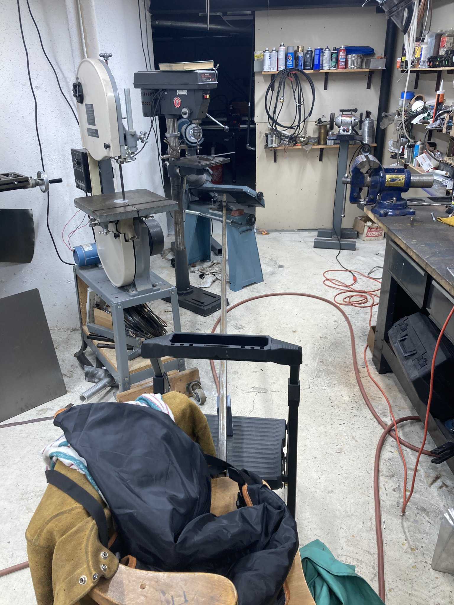

This also reminds me that I still need to make some "roller guides" for when I cut long pieces.....but for now (and the past 30 years) a "makeshift stand" like this Gorilla step ladder with a shim, will have to suffice.
BTW I love that little horizontal Bandsaw.....It is one of my oldest tools and man I get a ton of use out of it.
I'll bet that I paid about $149 for it, 25'ish years ago. Money well spent.
It is especially nice for those "angled cuts".

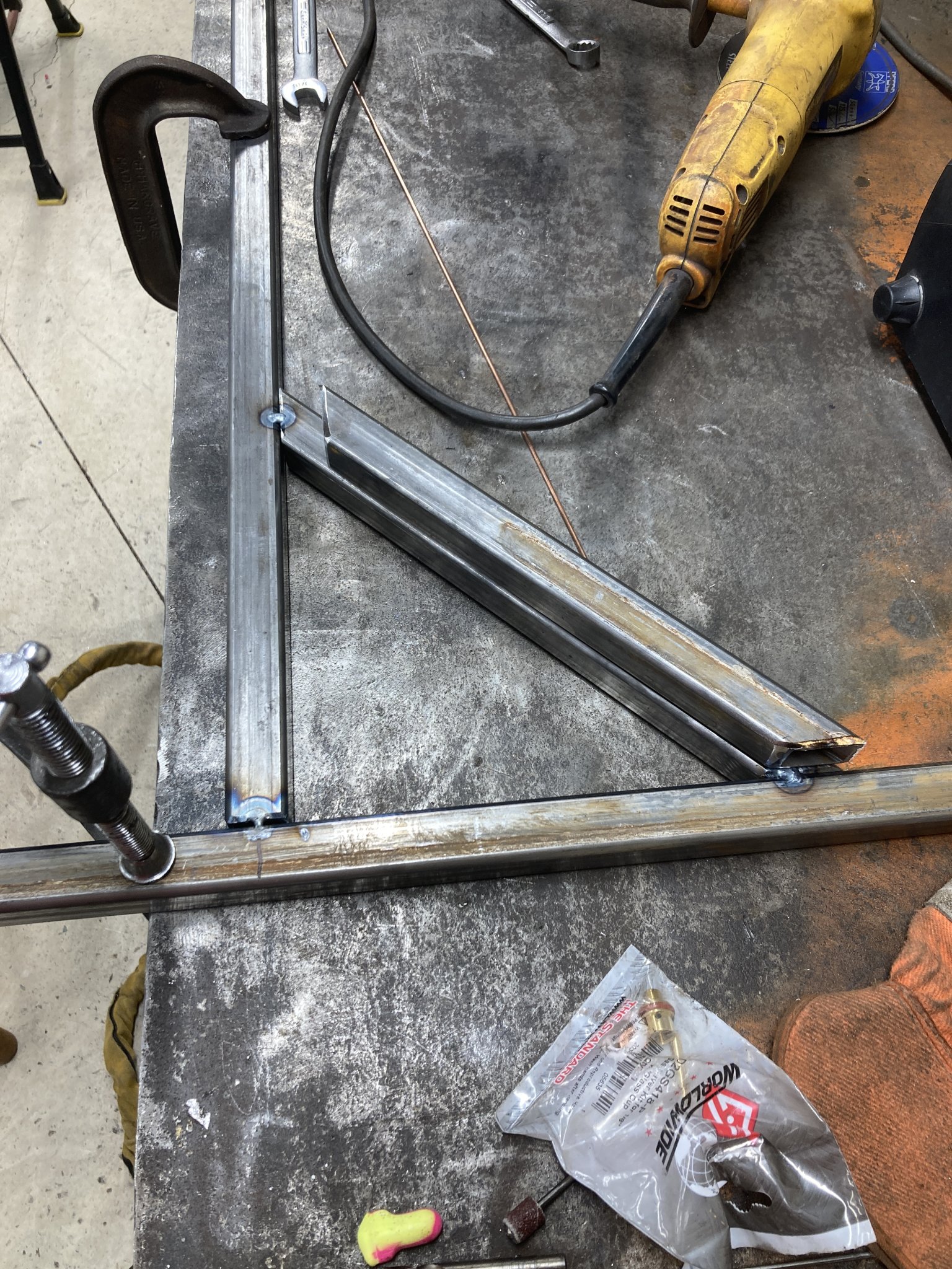

Time to lay it out, and tack it together. Sometimes I wish I would get a small El'Cheapo MIG gun for downstairs tacking.....Maybe one day......but for now, its all done with the TIG machine.
As I go to do the second one......DAMN IT ALL TO HELL!!!!!!
There is my first F-up. I must have checked that thing 20 times before I cut it, and I'll be damned if I didn't cut one an inch short.
Good thing I have about 400 more feet....hahahahh

So I cut a new piece and then its off to the "Langmuir" to cut out some "corner braces."
When I first started using that CAD program, It would have taken me 3 hours to make a stupid triangle, but now its just a few seconds.
I can't tell you how much of a time saver the Langmuir is. I love that damn thing.
After I hit "start", it takes about 15 seconds to cut 2 triangles out.
I'm running out of time for the day, the kids are coming over for dinner, so I get to feeling a little "rushed" (never a good thing)
I "quickie tack" them on, but I am not "loving them"....Something is not sitting well with me about the "look" of them.

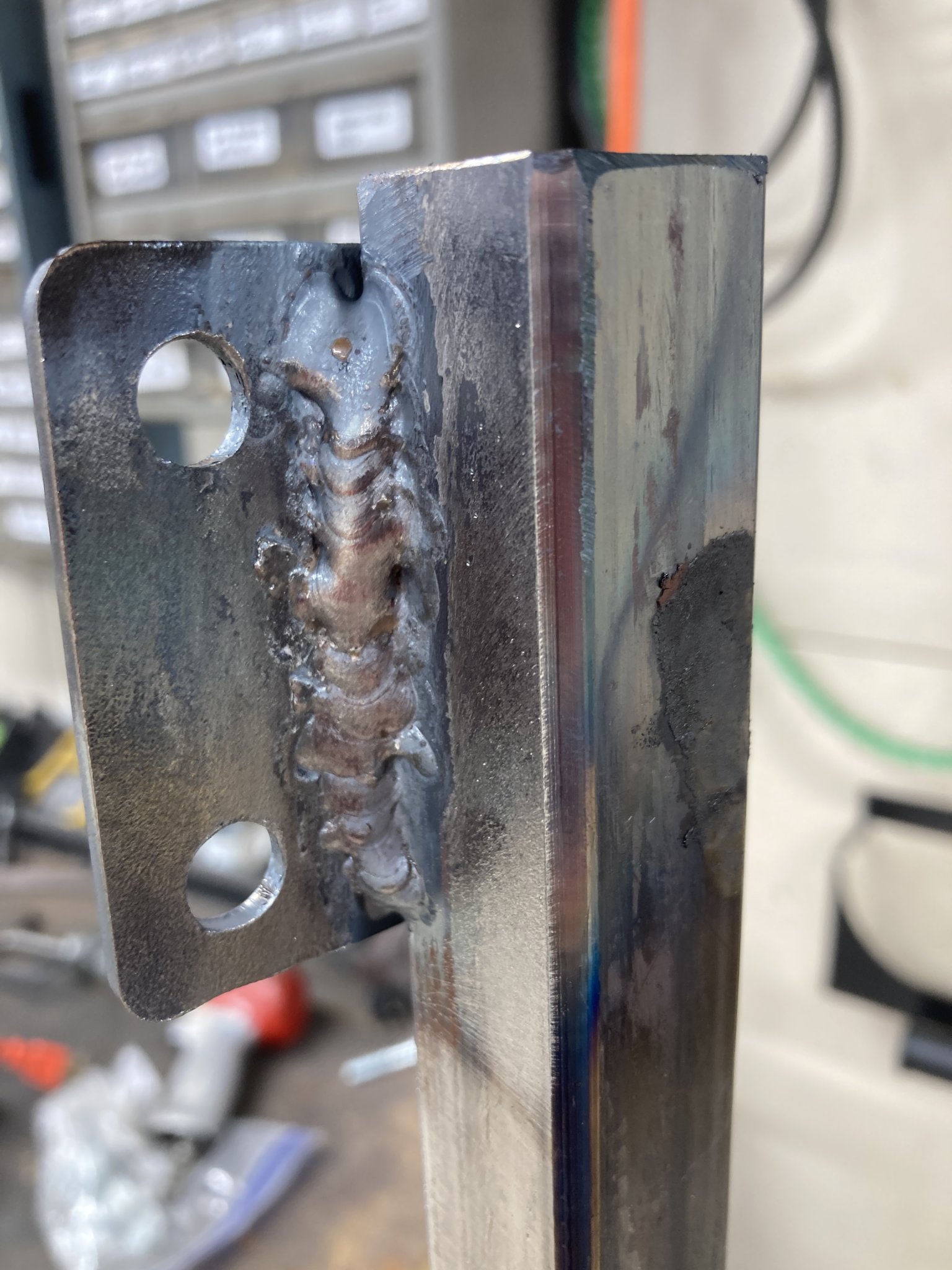

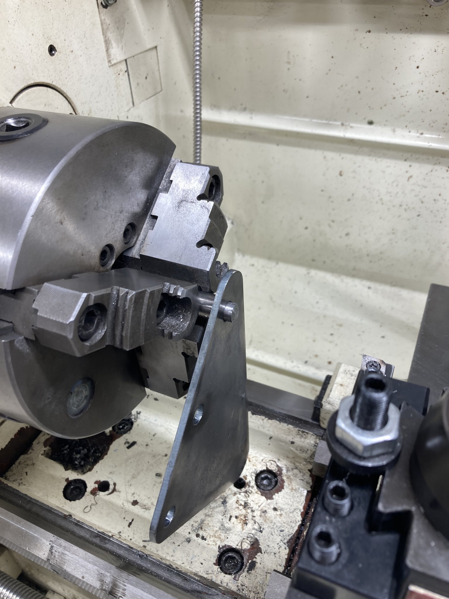

I remember....... "Back in the day" when I was an A@P mechanic, my primary job was doing sheet metal and structural repairs, and we would locate holes by using something called a "drill bushing".
I decide to make a "custom one" for this project. Although I think the ones I used back then were "hardened", I am only going to drill 12 holes, so thats not necessary.
So its off to the "scrape pile" to find a "donor"......and out pops this former impeller shaft off an old boat motor that I screwed up 15 years ago.
I chuck it up, and its "off to the races" to make my "custom drill bushing"
After a few passes, it "fits like a glove",
so after center drilling it, I break out my "new favorite tool"....the upside down parting tool.
Perfect.....Now I feel much better.
The hole drilling goes perfect, and they look nice.

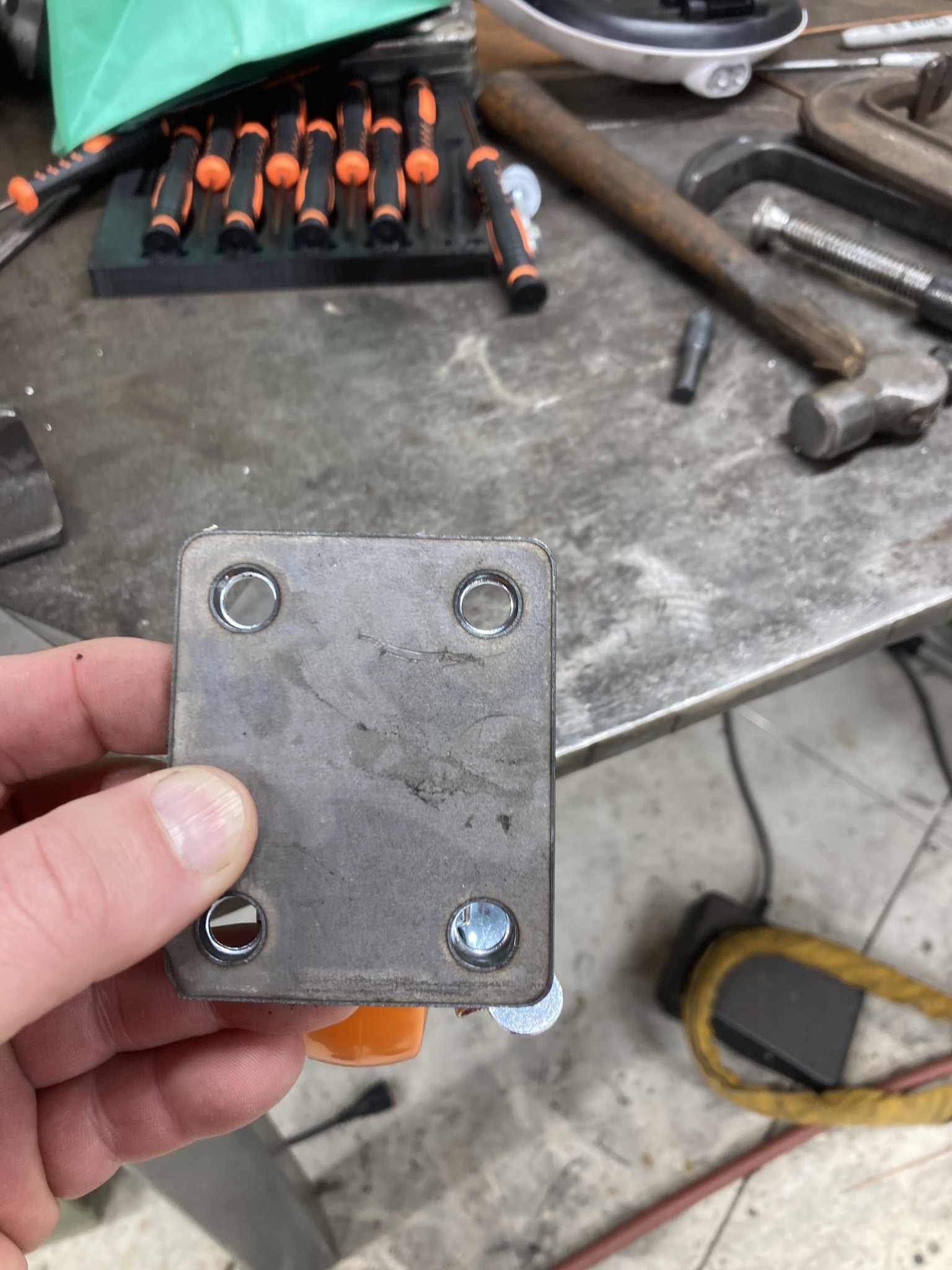

Now I go back to the Langmuir, and after a few minutes of set-up, I blast out 4 nice looking "caster pads"
Then I fire up the "TIG machine" and its "off to the races"
Welding went "just average" ....For some reason I could not find my "Mojo"....I made a few stupid mistakes, but overall, it works just fine.

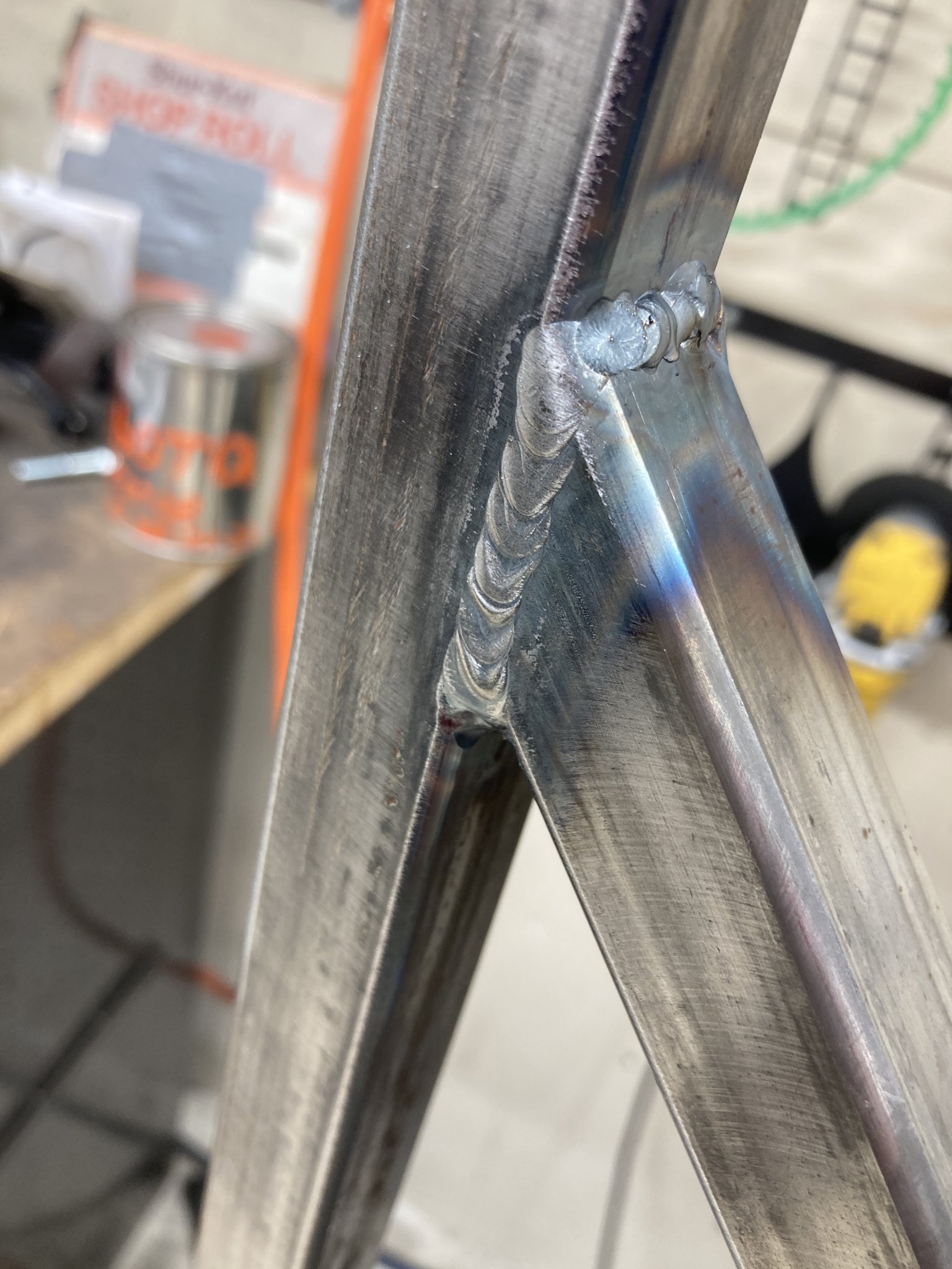

Here is a "vertical up" attempt....pathetic, but this ain't going on the space shuttle, ......it's only a paint rack...... so it will have to do.
Not horrible, but I gotta learn how to "turn the corner" better.

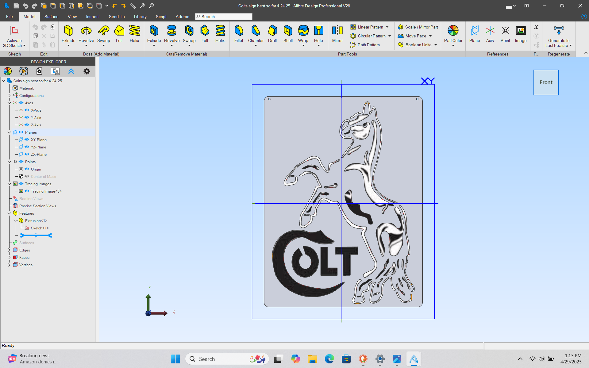

Here is one for my youngest grandson (named Colton, but I call him Colt) that I have been working on for a few months.
It "tips the scales" at 41 inchs x 30 inchs.
