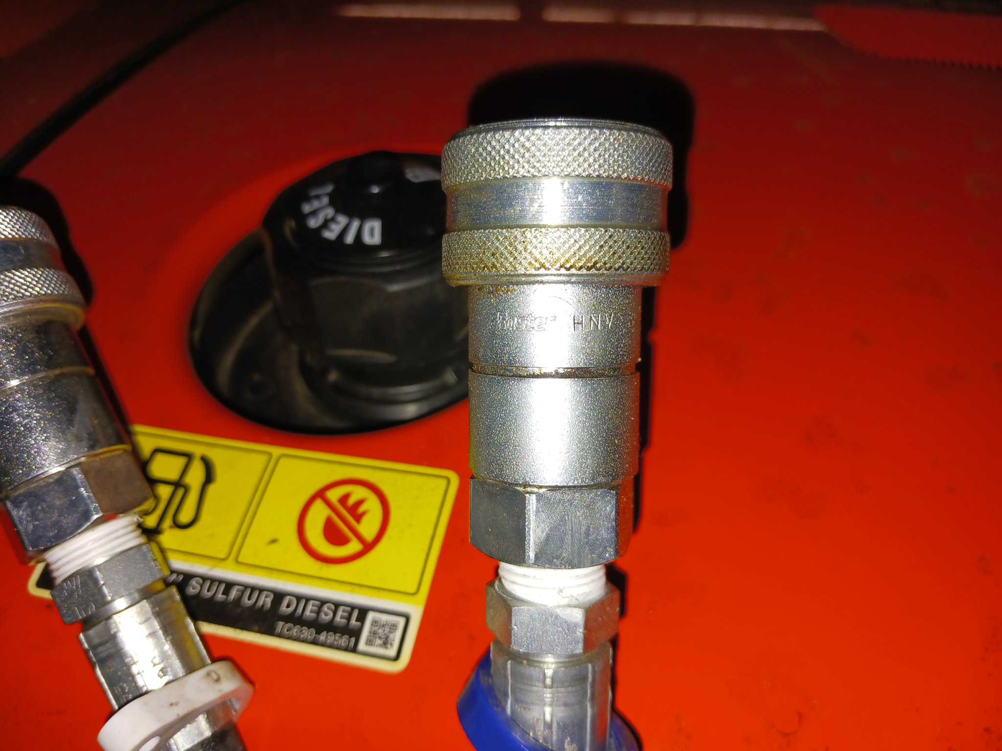

I assume we are talking about quick couplers. How about you tell us which ones and where they are on the tractor. OEM or after market? It would also help if you would look at the offending pieces and give us the part number stamped on them. Kubota seems to favor Faster couplers.

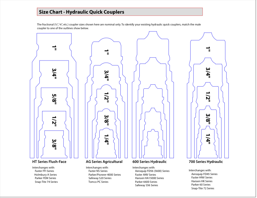

This might help.
I know that my BX24 uses the 700 series. Yours is probably the Ag series more commonly known as Pioneer couplers.
Yes the quick couplers. I need a set of females for a home brewed attachment of the OEM 3rd function at the quick connect where all the connections are on the loader attachment - not the end by the bucket. I had some 1/2 “pioneer” style that I thought were right but they are 3/8. But I don’t know what quick connect style. Ag, A or B.
I can probably find some number in there tomorrow.

What's so difficult about finding the name and number on the coupler? That's a positive ID. The OEM couplers on my LA525 loader are 3/8" Faster HNV - ISO 7241-B. They will not interchange witrh anything but another3/8" 7241-B coupler which you are not likely going to find in your local TSC.
It’s very difficult when you aren’t at the tractor Dan.
And thanks for just answering with the ISO B - that’s what I was looking for.

Now you are assuming the third function on your Grand L tractor is the same as the LA525 loader on my Standard L. Why not wait until you can get to the tractor and look at what YOU have.

Look at the base of the coupler - the part number is stamped on it - use google
