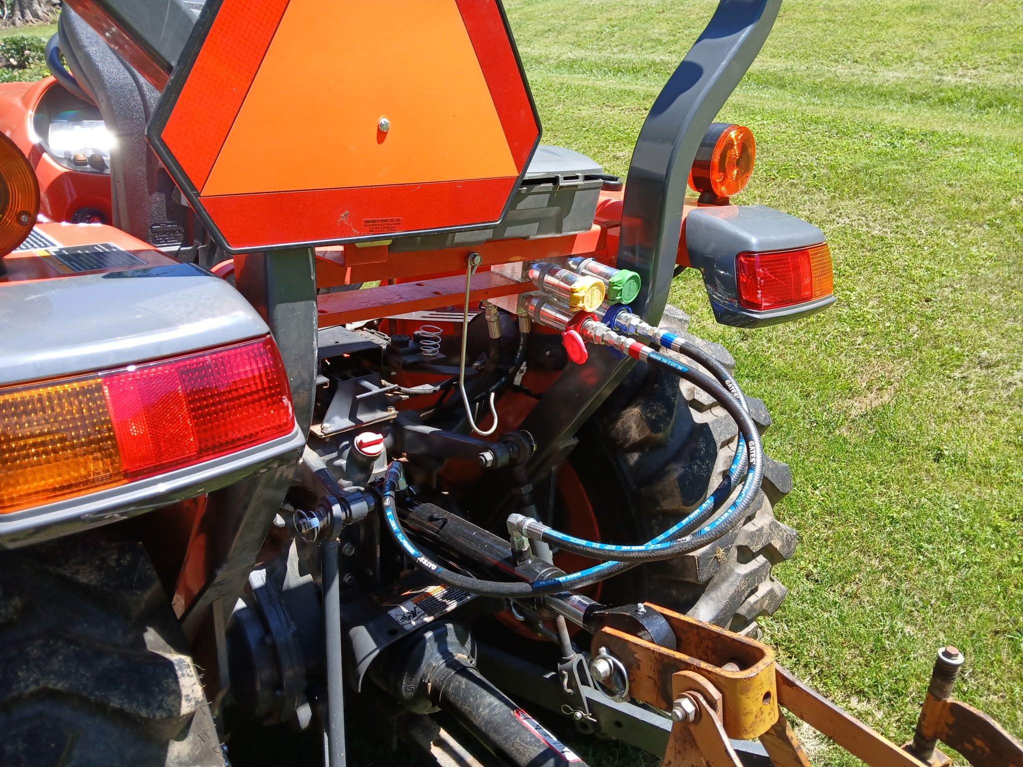

I will give you a couple more data points.
I just configured a two spool 12 GPM Bucher sectional valve with power beyond from Trausch . Both work sections are DA spring center and no float. Cost delivered to my shop is $453.
The same configuration delivered with a Summit monoblock and two DPOCV mounting blocks like the ones in the picture below (less the couplers) is $298.
I dont know how long the Bucher valves might hold that mower but I can say from personal experience the Summit valve will, for all practical purposes, hold it there FOREVER.

I know how long the Summit valve will hold without the checks. As I posted esrlier in this thread not long and I found it unacceptable.
But with the check valves which also provide a very neat and modular outlet mounting system it holds with ZERO leakdown.
