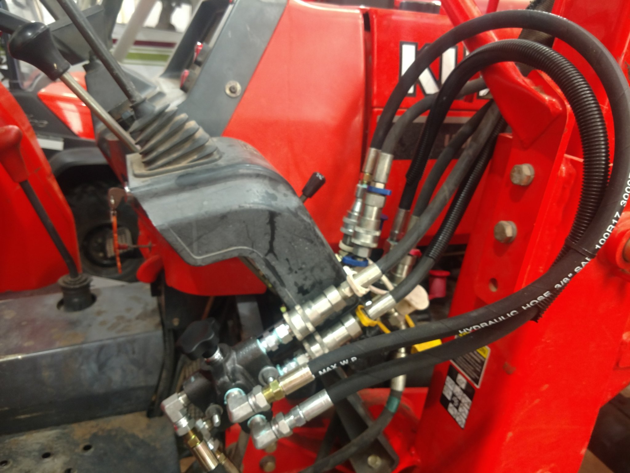

Not a B2330... did it on my M4700 using the valve/kit supplied by tractor Innovations.. Andy has really been helpful and the installation video is right-on-the-mark. Easy and works great With the hyd toplink I ordered from AgriSupply. (But be aware, the AgriSupply toplink and hoses are BSP fittings and require an adaptor to attach the Pioneer male fittings Andy supplies along with his kit. I got the adaptor from Amazon for $11.
Here’s my installation Pics taken just as I completed the installation. (I later tucked the valve hoses behind the FEL tower And they are completely out-of-the-way...not exposed as this pic shows.)

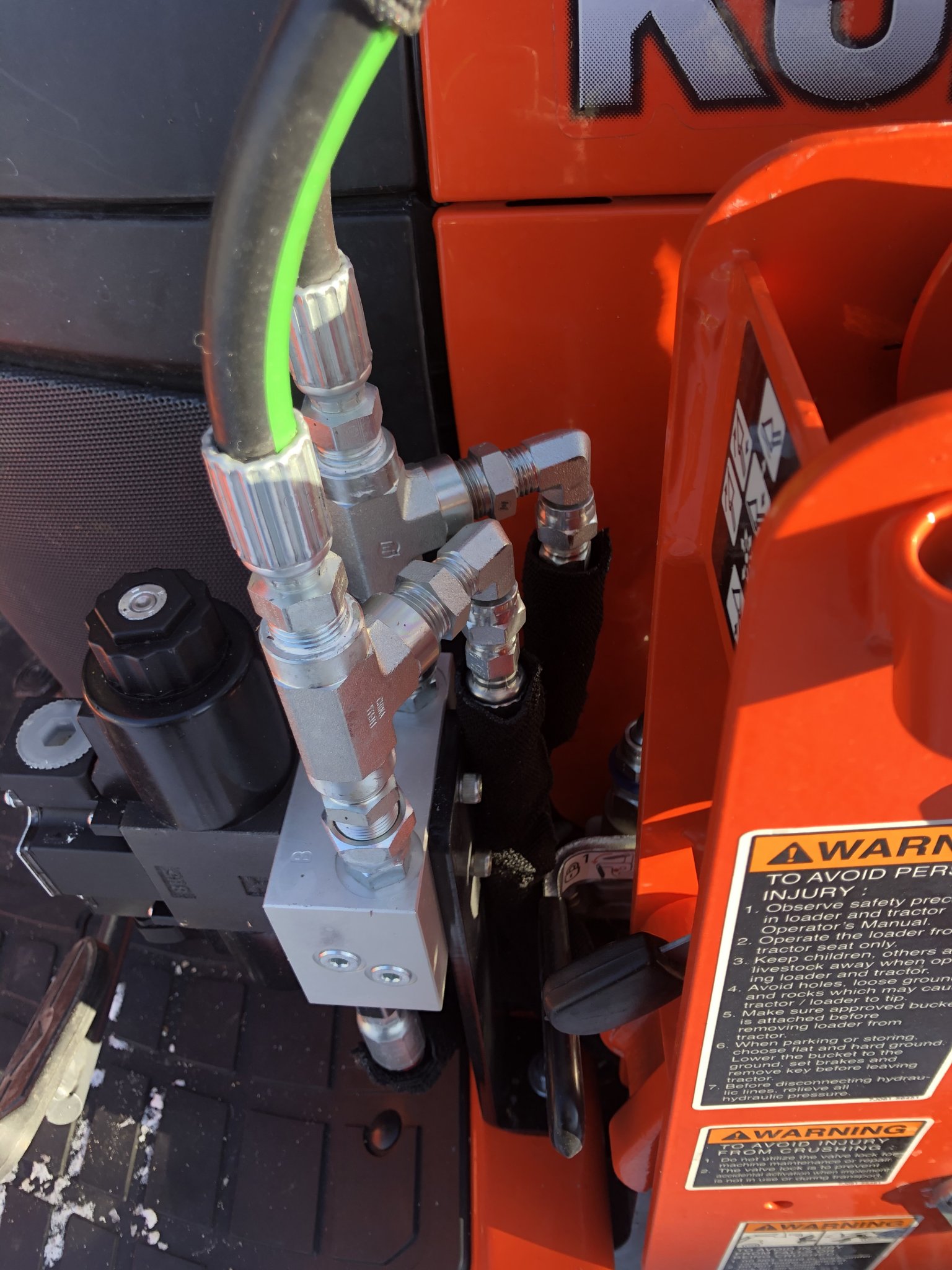

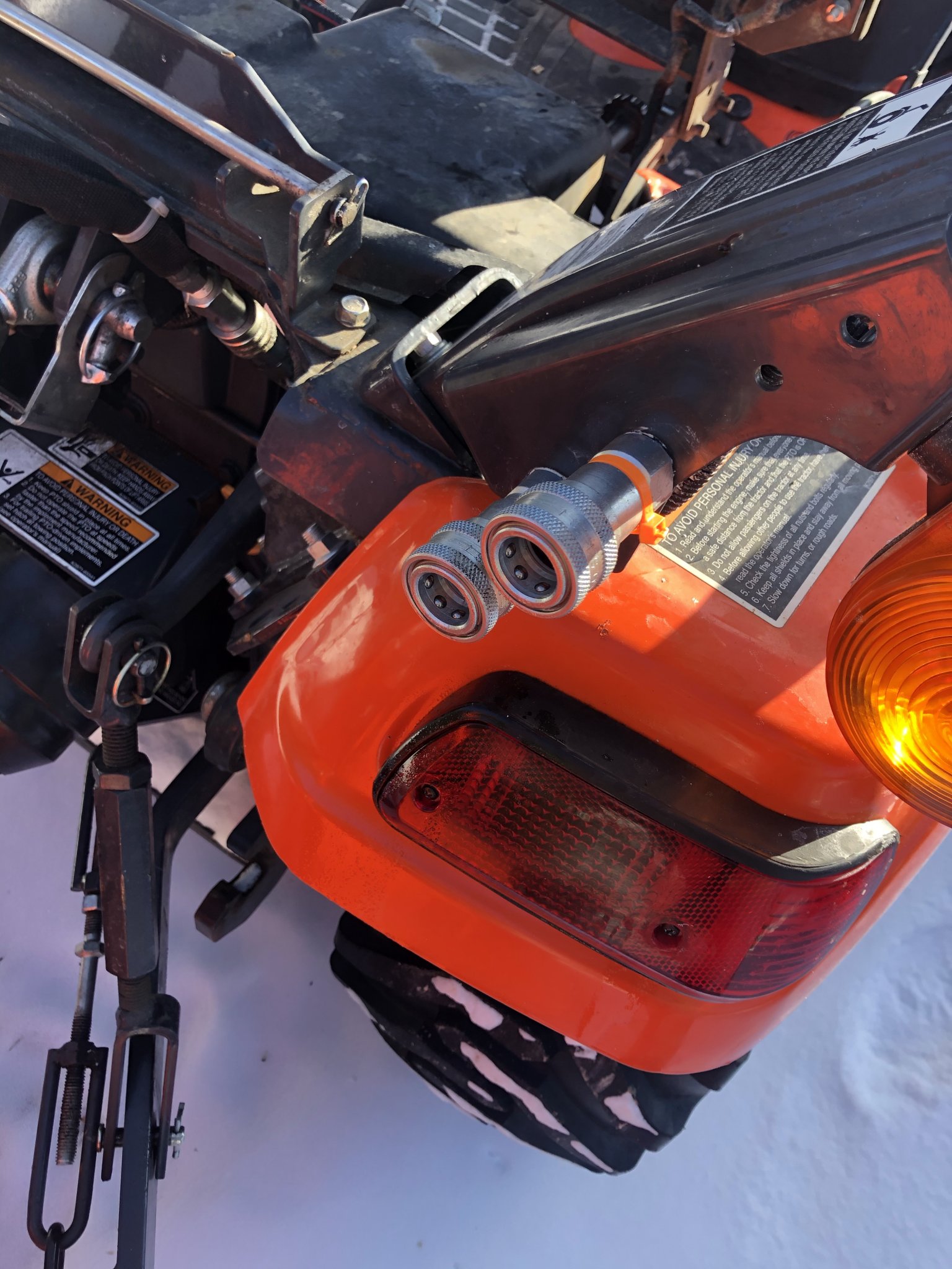

This is how I asked the dealer to set up 3rd function. The hoses to the front can be popped out of the bracket and I’m going to make a bracket so they lock to the tractor when the loader is off. The lines to the rear are permanently plumbed in to currently run my blower rotation; however I plan on setting up a hydraulic top link for using my box blade in the summer.
