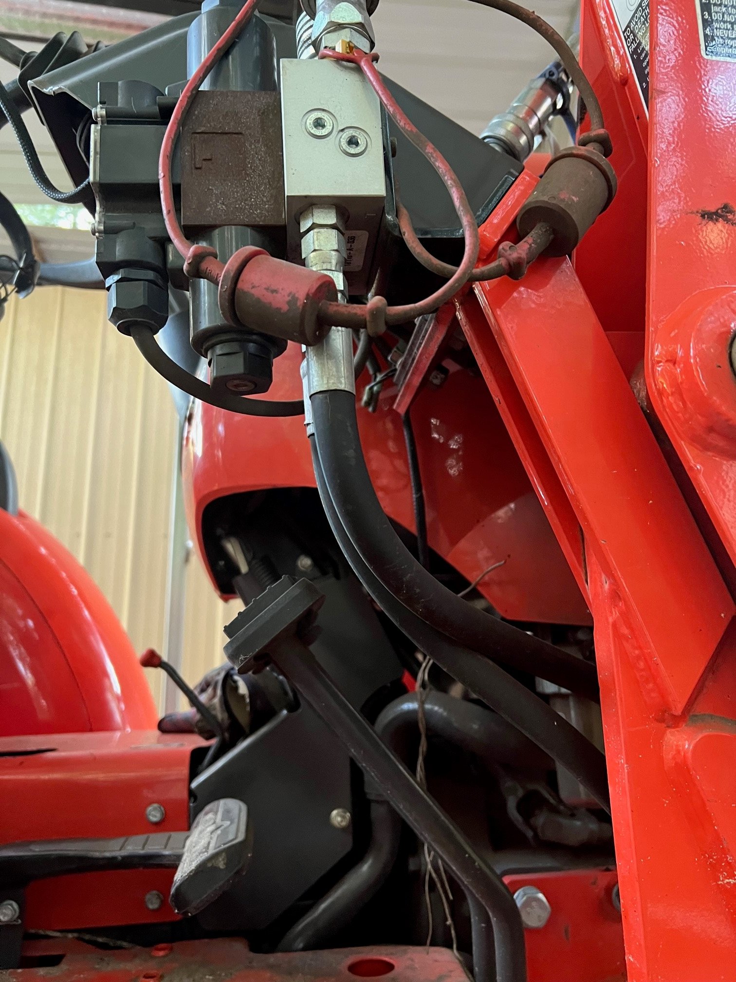

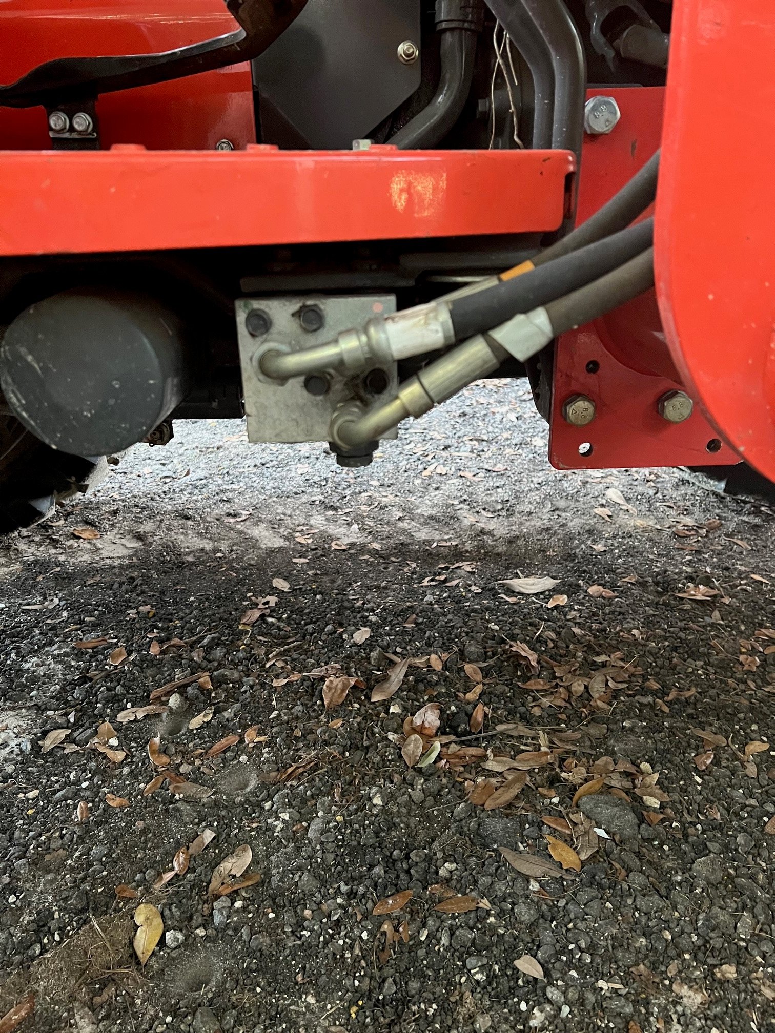

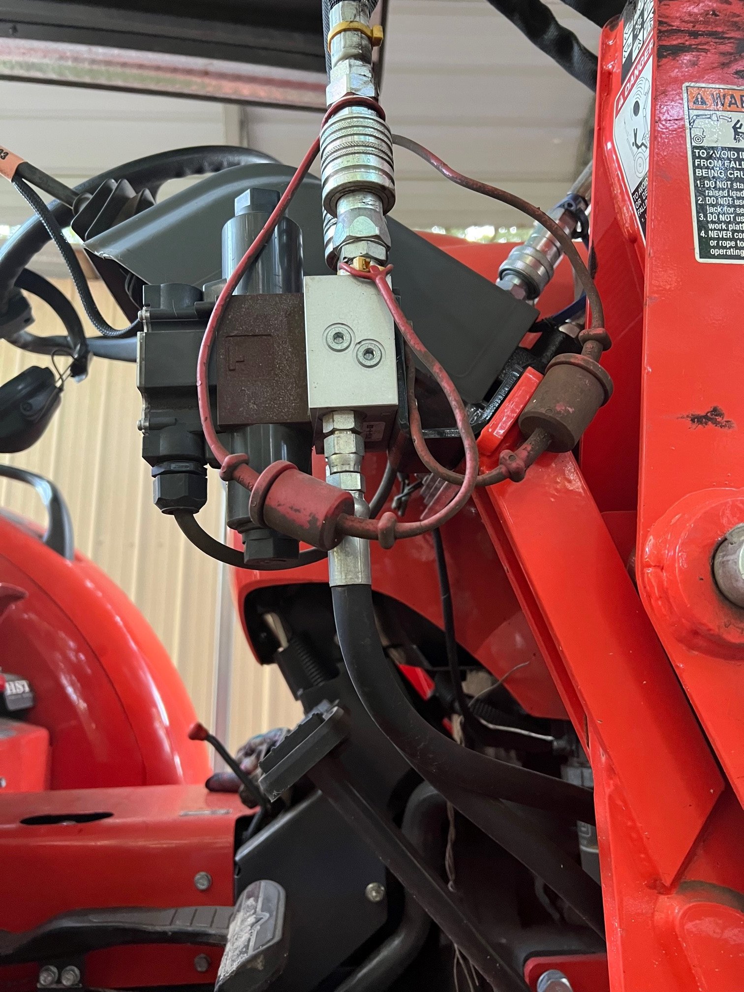

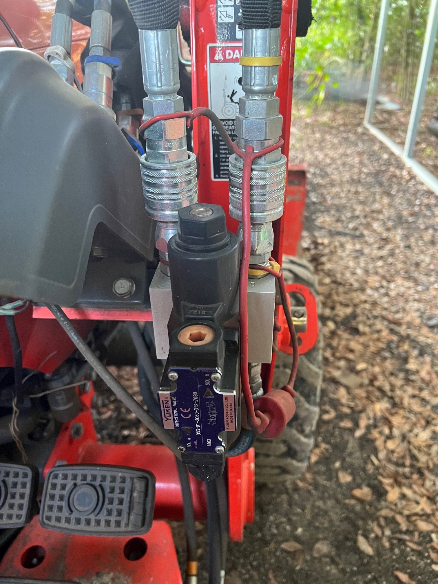

I did what you said by teeing my 3rd function so I have it front and back. I use it in back when I have the BH77 on for my home made hydraulic thumb. I bought a pendant switch from Surplus Center and paralleled the 3rd function switch so i can use it from the backhoe seat and it works really well for me.
I also did what Dan suggested and added a 2 spool valve this year to run top and tilt. I bought my top cylinder from Agri supply but for my L2501 it is a little short at 28" extended for my back blade. so you might keep that in mind and look for a longer one if 28" isn't enough. I ended up spending a day making a block to extend my top link base that is removable rather than weld or change the oem.
