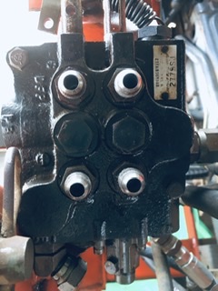

Is this rebuildable?
If its leaking externally yes. But if the spools or body are worn and its leaking internally no. You can replace that valve with a new and much nicer valve for $275.Is this rebuildable?
Thanks! 1 or 2 spool?If its leaking externally yes. But if the spools or body are worn and its leaking internally no. You can replace that valve with a new and much nicer valve for $275.
Two spool joystick loader valve with float detent and power beyond circuit.Thanks 1 or 2 spool?

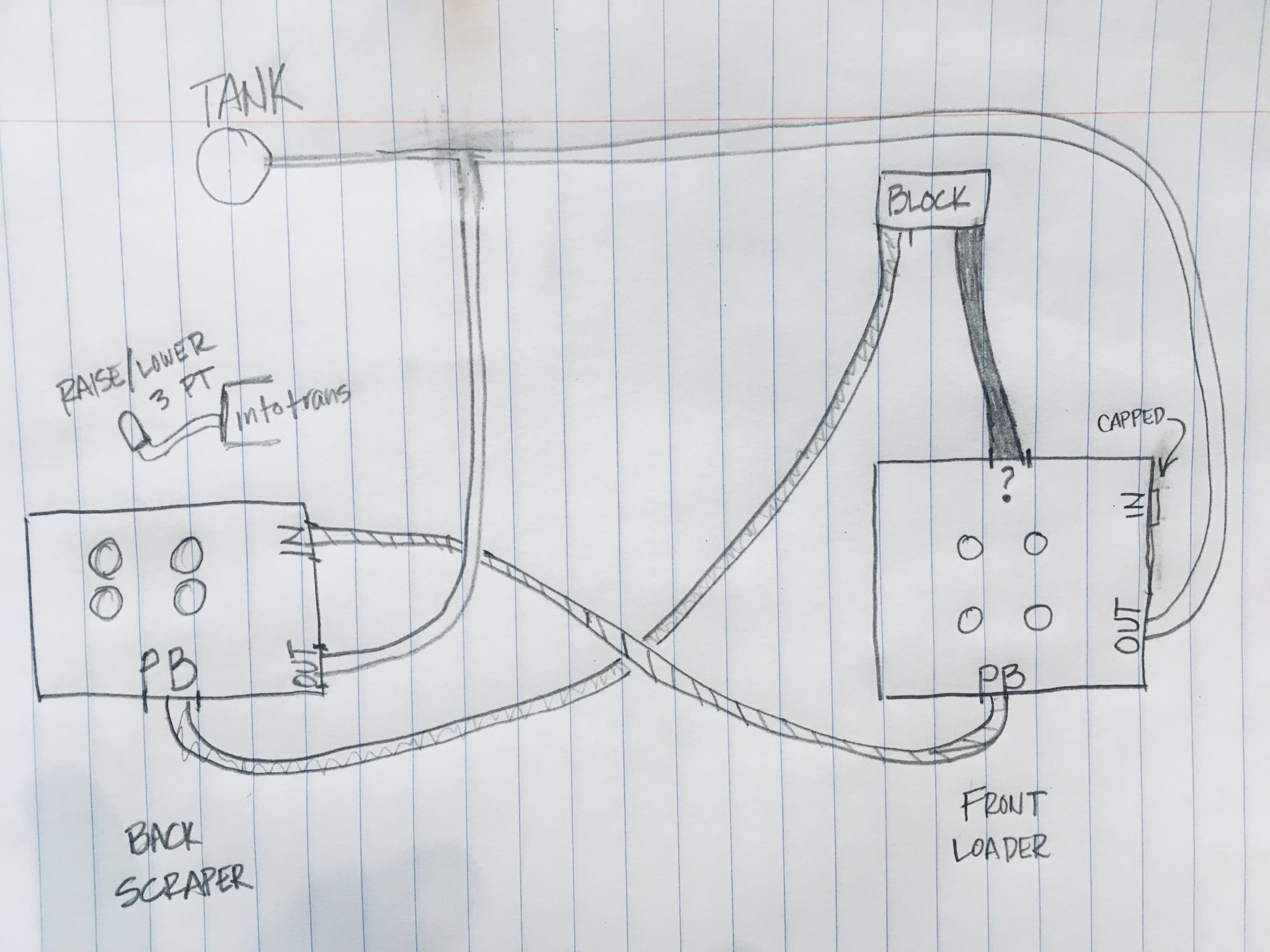

Here is the current hose schem.
Curious about the function of the line that goes from block to rear pbHere is the current hose schem.
I want to replace both controls, will this config work with new controls? Do i get the same for front and rear ?
It directs the oil back into the TPH valveCurious about the function of the line that goes from block to rear pb
That hose is where it initially sprung the leak, at the blockCurious about the function of the line that goes from block to rear pb
What is the tph valve and can it stick?It directs the oil back into the TPH valve
TPH = three point hitch and probably not.What is the tph valve and can it stick?
