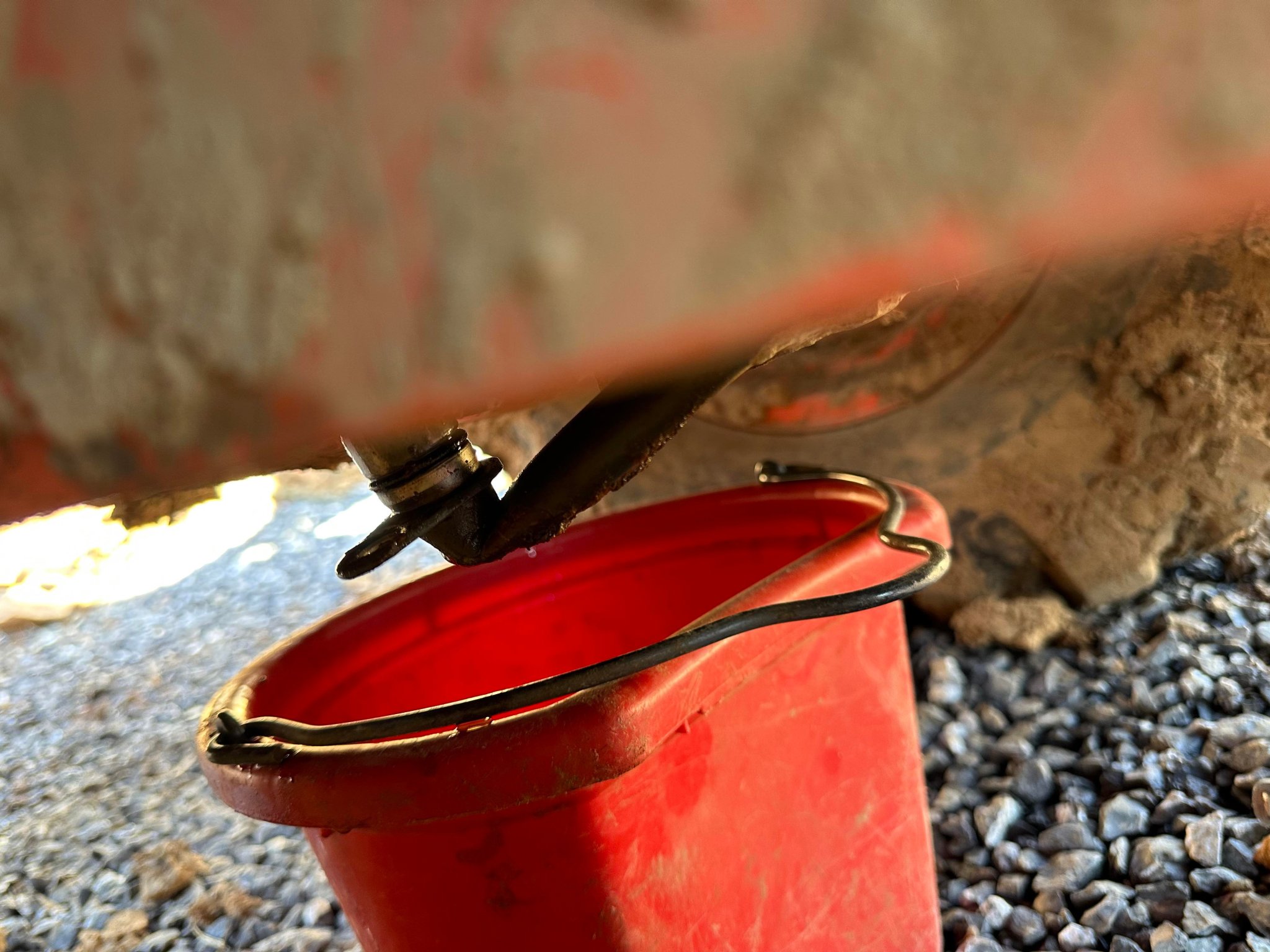

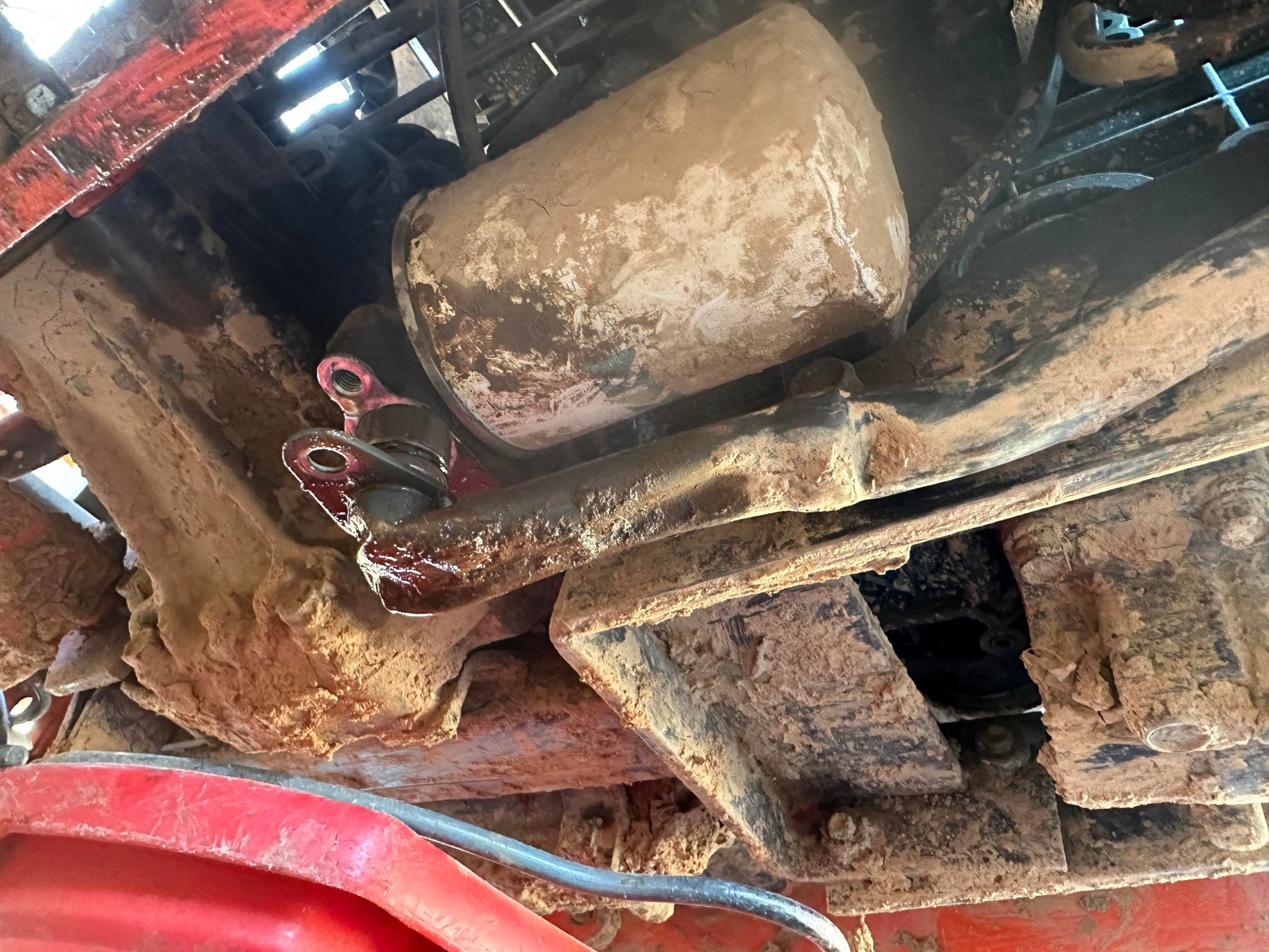

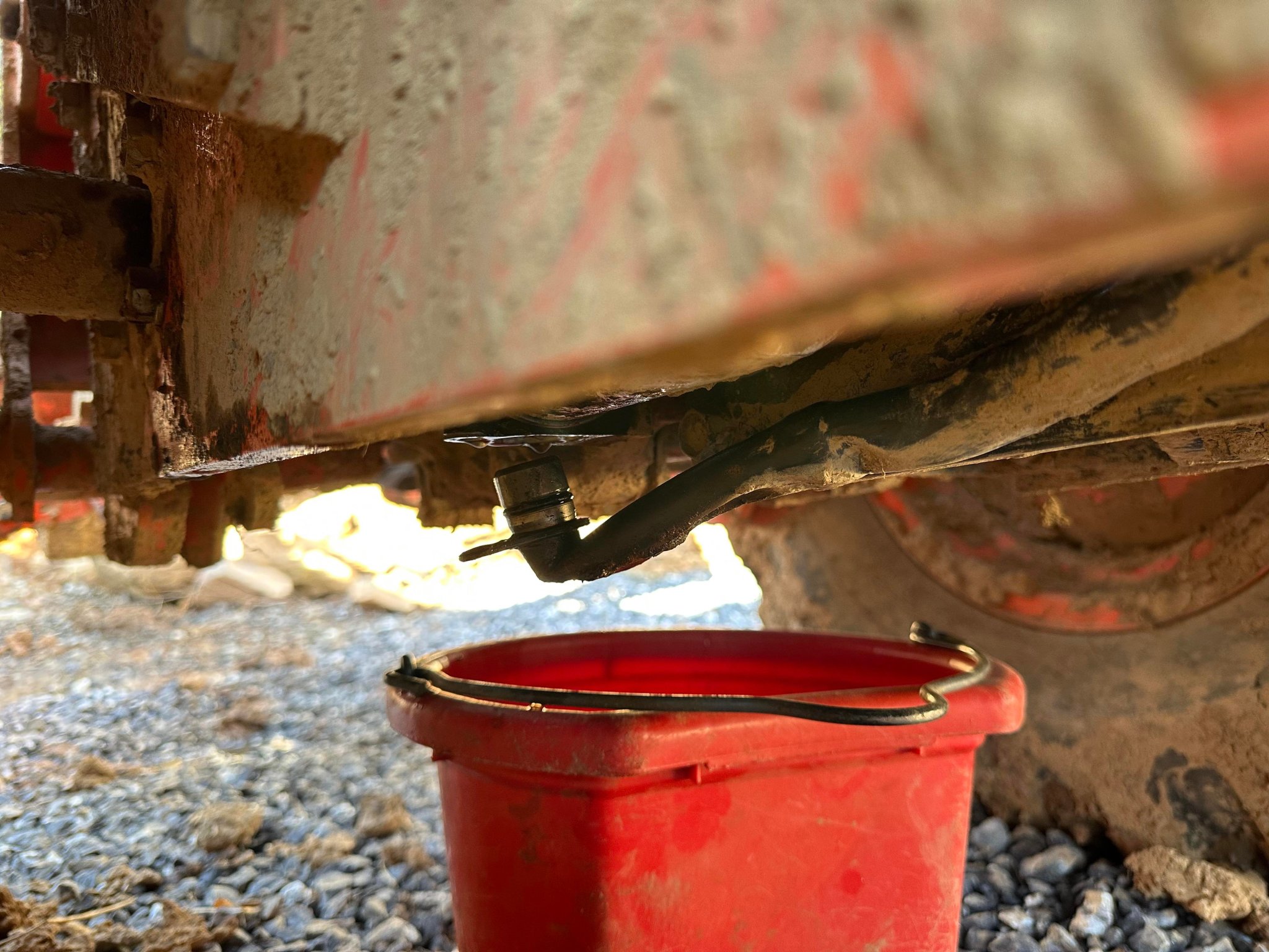

I'm truly at a loss for words here. How is this setup not built to fail? My hydraulic suction pipe is below my frame. There is no belly/guard plate. I've got a new pipe to install but I see no way to actually remove or install without removing the entire cab off the frame. Any help with this would be greatly appreciated. Please type slowly because I'm a female with limited mechanical tractor knowledge. However I'm willing to learn. LOL

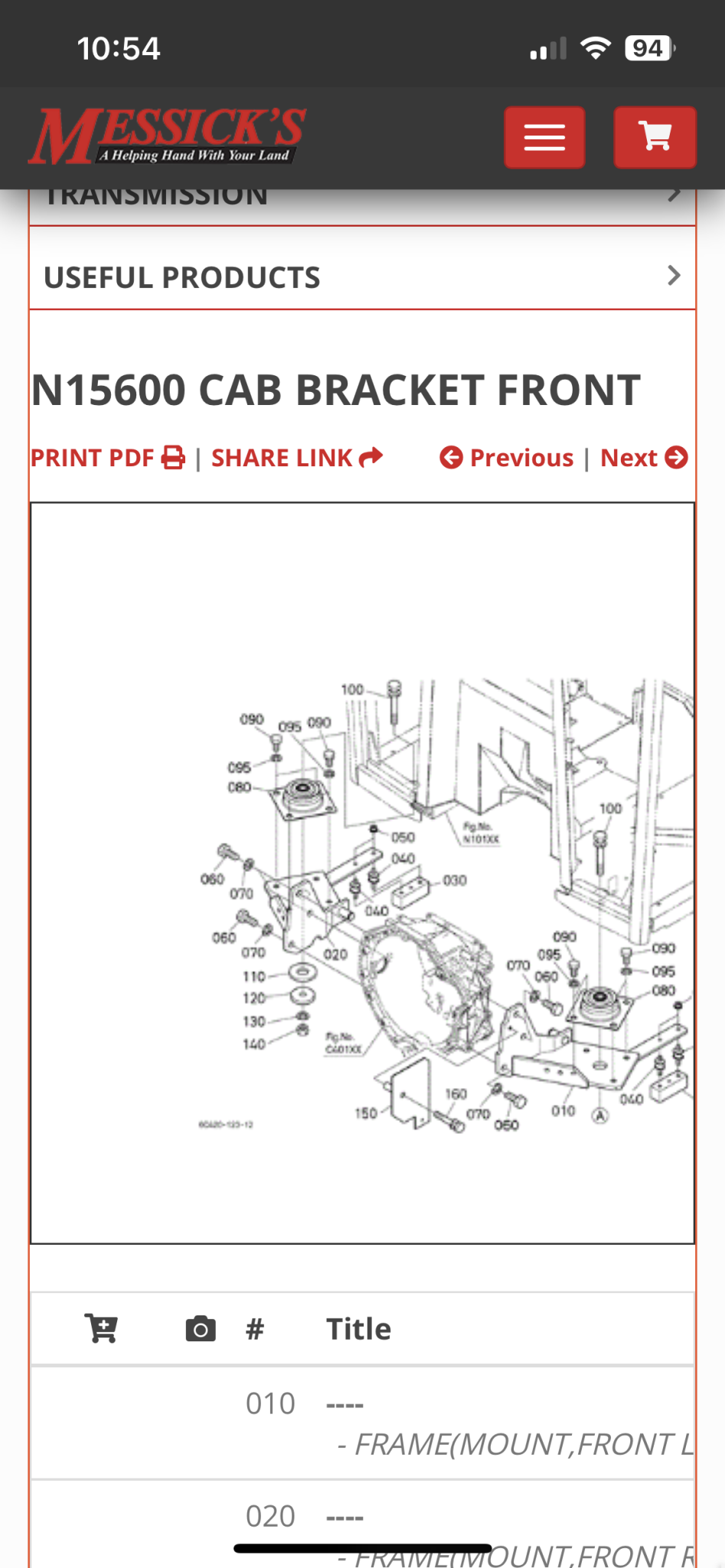

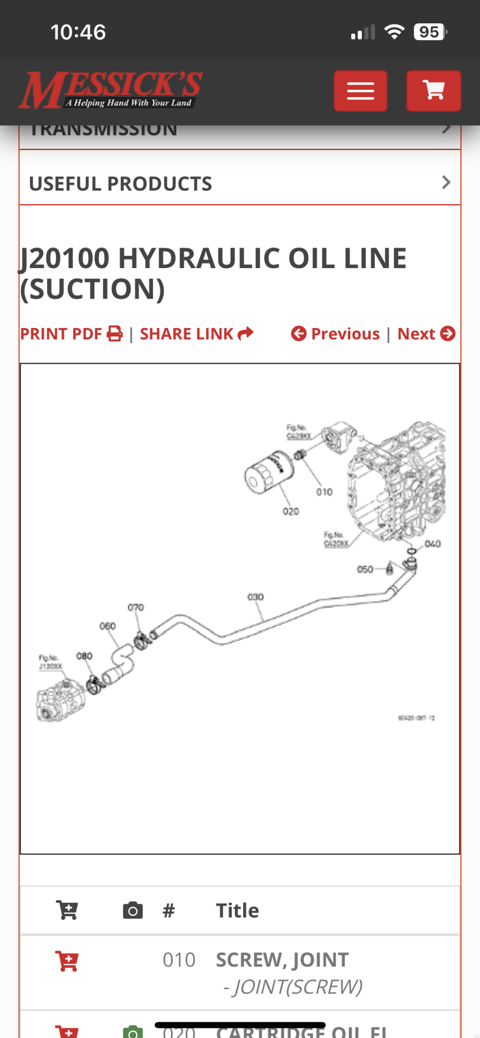

Welcome! Sorry we have to meet like this. My L35 had a similar problem. I'm not familiar with your tractor, but according to the parts diagram there's a clamp-on connection at the other of that pipe. Can you not get to the clamp, or can you not fish the pipe through other obstructions once you get is disconnected?

Hose clamp and pull to the rear. Should be able to fish out without pulling cab.

I've got the clamp off but I can't seem to fish it through. The elbow won't move past the corner of the cab.

I would suggest jacking the machine up safely (jack stands) on the right side. It will give you the most maneuverability. Might try going out the front too. Is the tube in between/above #20 and the transmission? If so, the front cab mount may need to be removed.

The biggest issue seems to be getting enough movement to fish. The quick mount for the belly mower is stopping me from getting leverage. I could wiggle past that corner mount if the quiuck mount wasn't there.

If the belly mower is in the way id remove it. You should make it so the new one will go in fairly easy. If you are having to apply too much strain to get the old one out just remove parts. You don't want to bend the new pipe going in. I guess what I am saying is your not going to save time and effort fighting/vs/removing brackets.
