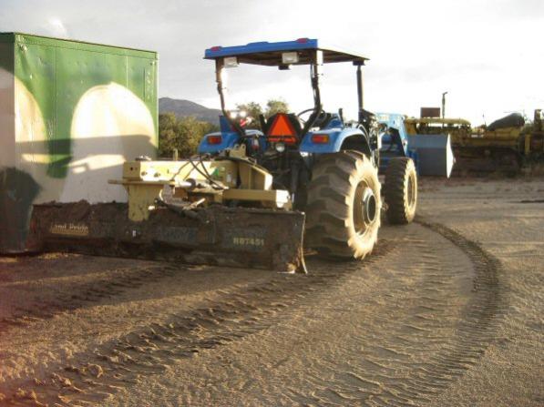

What size? All hydraulic, or just the angle function. Typically I recommend this blade. A very good blade for most tractors under 60hp. Land Pride is very good about providing any or all functions manual or hydraulic.
I do enough grading that after fighting a manual blade for about 2 years I went with this Land Pride RBT45108 unit to run behind my 12,000lb tractor.
Oh what an improvement. ;)
