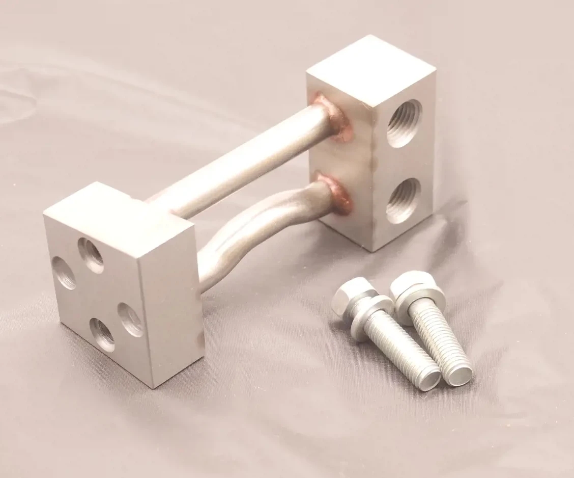

Here is your block.
According to Messicks it fits 47 very different models. i am quite sure the number in your instructuons is not the maximum pressure rating of the block itself. Its probably the system pressure of one of those dufferent models chosen at random by some clueless document author.

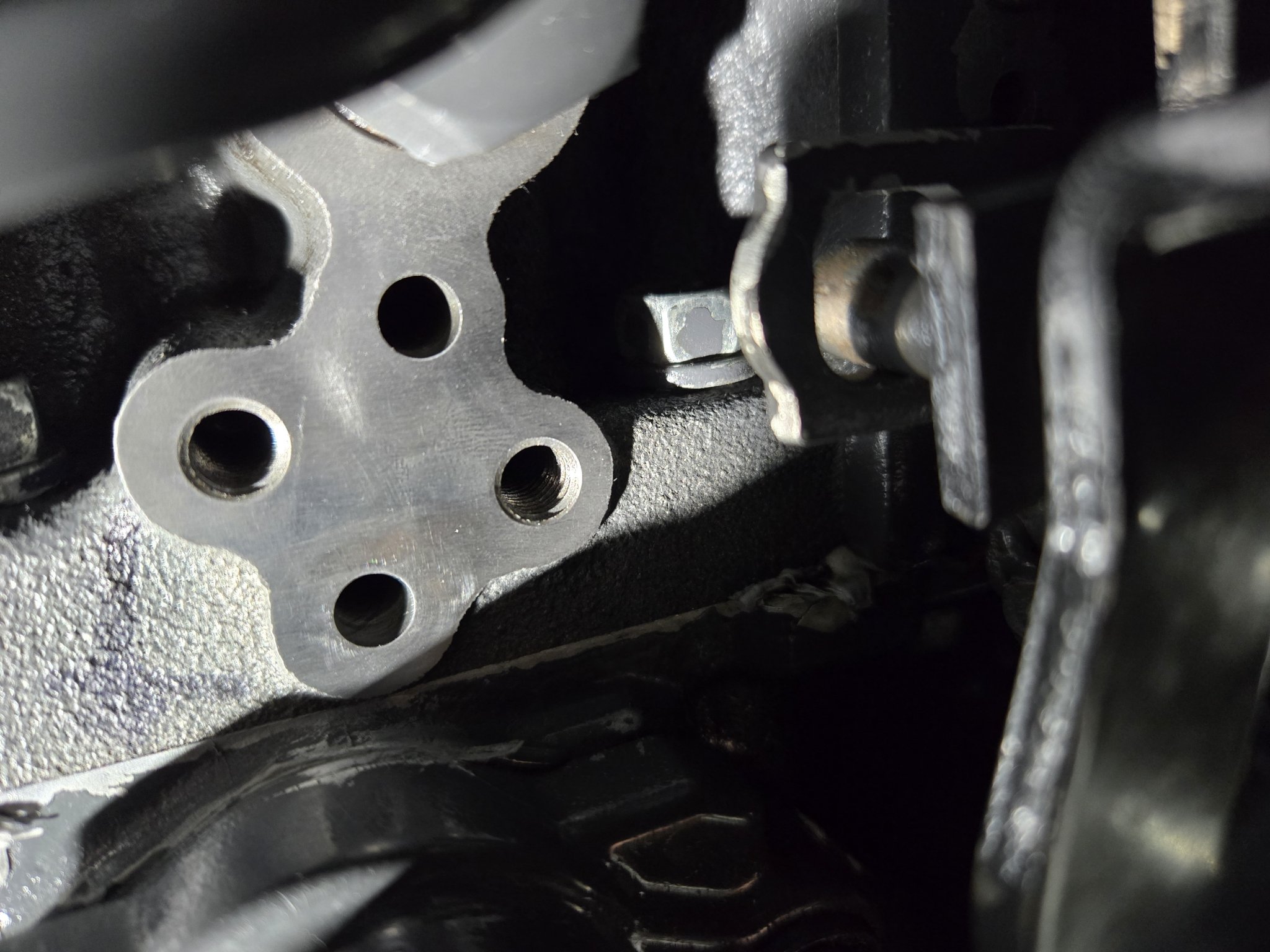

So back to your problem. Are you positive its leaking at the orings?
Yes that is my block. Yes the oil seeps from between the block and the transmission case. I don't see any anywhere else at this point.

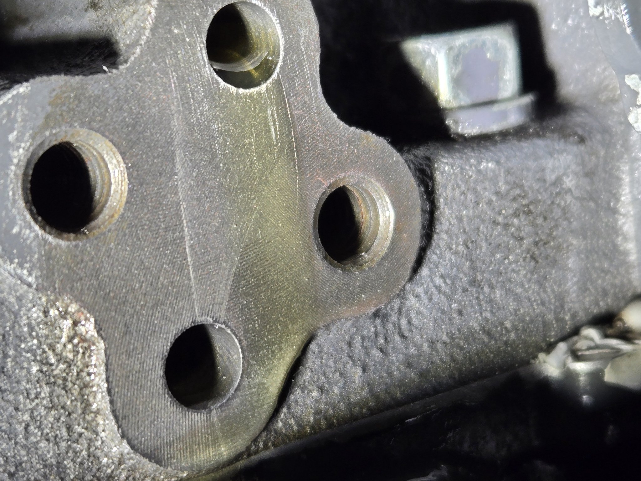

I tried to determine if there is any irregularities in the casting, without much success tho there seemed to be a small flaw in the top side of the lower port. So I did some careful polishing, see b4vand after pics attached. It's tough to get in there so I think it's as good as it's going to be. I still could do a test for uneveness in the machining with Dykem Blue but I dont have any at the moment.

My gut feeling is one or possibly both of the counterbores that hold the o-rings in the rear hydraulic block are cut too deep and you are not getting enough "squeeze" to make a good seal. I would check that using a straight edge and feeler gauges to measure the protrusion as I mentioned earlier.
Rule of thumb for a static face seal like this is about 20%-30% compression. For example on a 2.5 mm thick oring thats .5 to .75 mm (.020"-.030") protrusion.

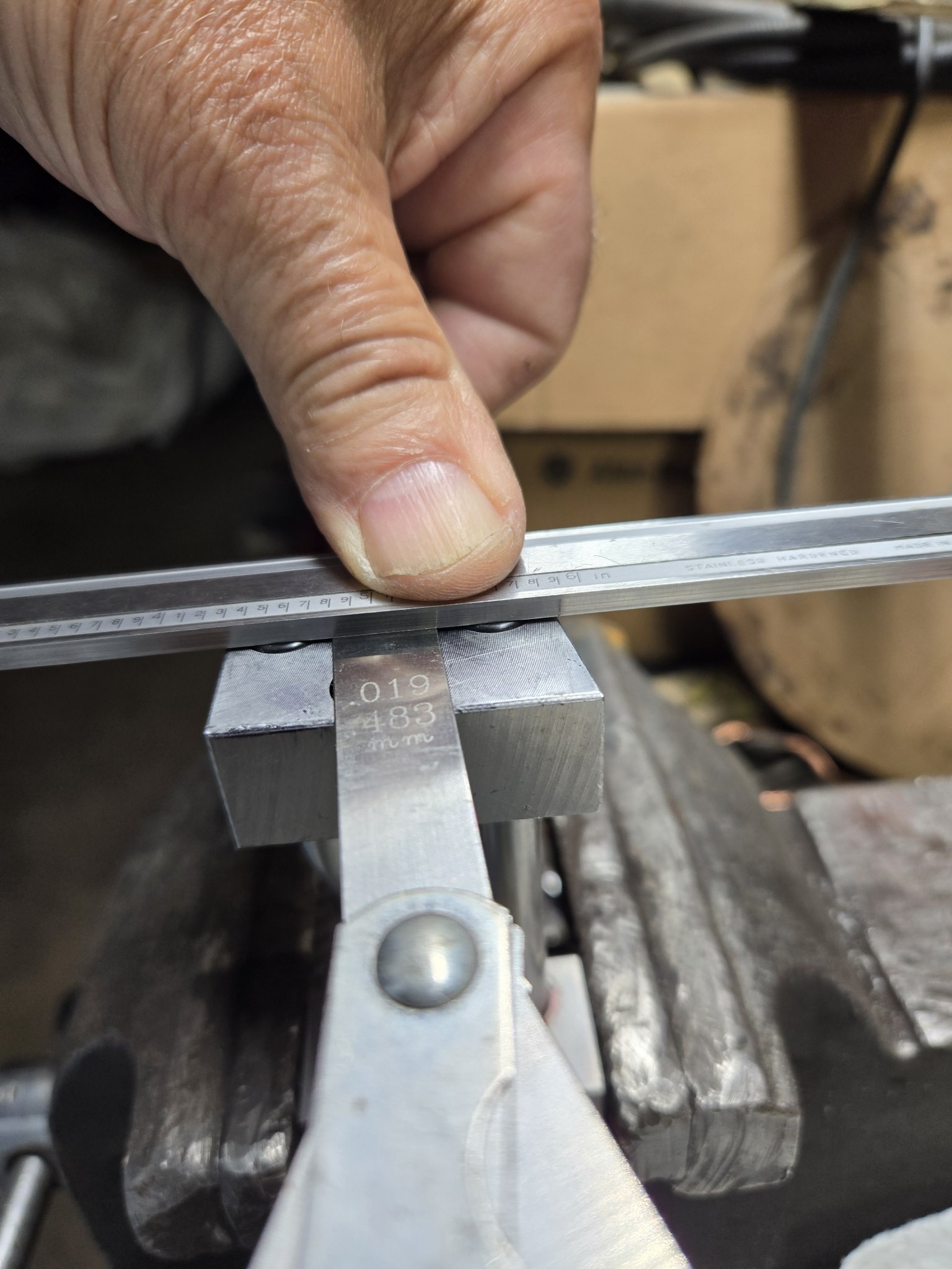

Ditch those instruments. All you want to knpw is the height of the oring above the face. Lay a good straight edge across the oring and use feeler gauges to measure the gap between the straight edge and the face of the block. Do each oring individually.
Ok
13,126
7,401
Something like this? .020 and if the o ring thickness is .074 then it's 27% protruded. Hard to hold the straightedge on the individual o rings. Did that with a machinist rule and seemed there might be a thousandth difference measured 90 deg apart. .018 and .017
Exactly. That gives you a direct measurement and eliminates a lot of error. Oring is probably 2mm (.079) and thst should seal fine if the two surfaces are flat.
