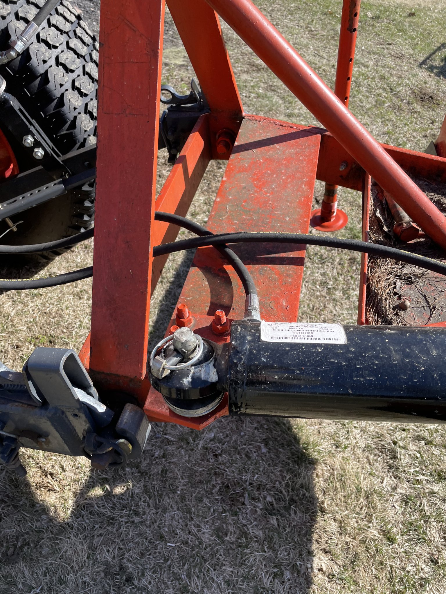

I cobbled together hydraulic angle for my rear blade (RK brand) I use for snow removal. Disregard the circles and arrow. I can easily reverse blade by pulling the pin and replacing in the opposite side. I get about 45deg max angle each way. Let me know if you need more pictures or other info.

A cylinder off a truck-size plow blade will already be the appropriate size as far as rod strength, strength of the mounting points etc so you're probably off to a pretty good start. As long as it's a double acting cylinder! Some plows use 2 single acting cylinders instead and if you only had one of those you'd need another one to make this work.
I like the reversible mount idea shown above!
The main thing to be careful of with your mounting points is interference between the cylinder and other things as it moves. Because whatever you attach it to will be moving in an arc, the entire cylinder itself will also sweep through an arc, just a much smaller one. So it will need clearance to either side of the cylinder housing, and the end that the cylinder is pushing around cannot have anything come in from the sides and ding the cylinder rod either. In a case like this you can probably just mock up potential mount locations with large c-clamps and then rotate the blade by hand through the range of motion with the cylinder ports left open. That way you can 'try before you buy' on your mounting points.

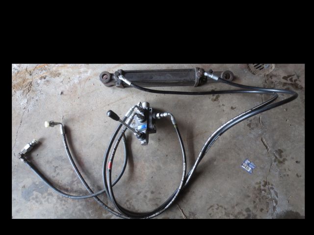

Regards
What type of control spool valve did you use? ( pics if available)

Thanks for pics , similar to what I want to do
