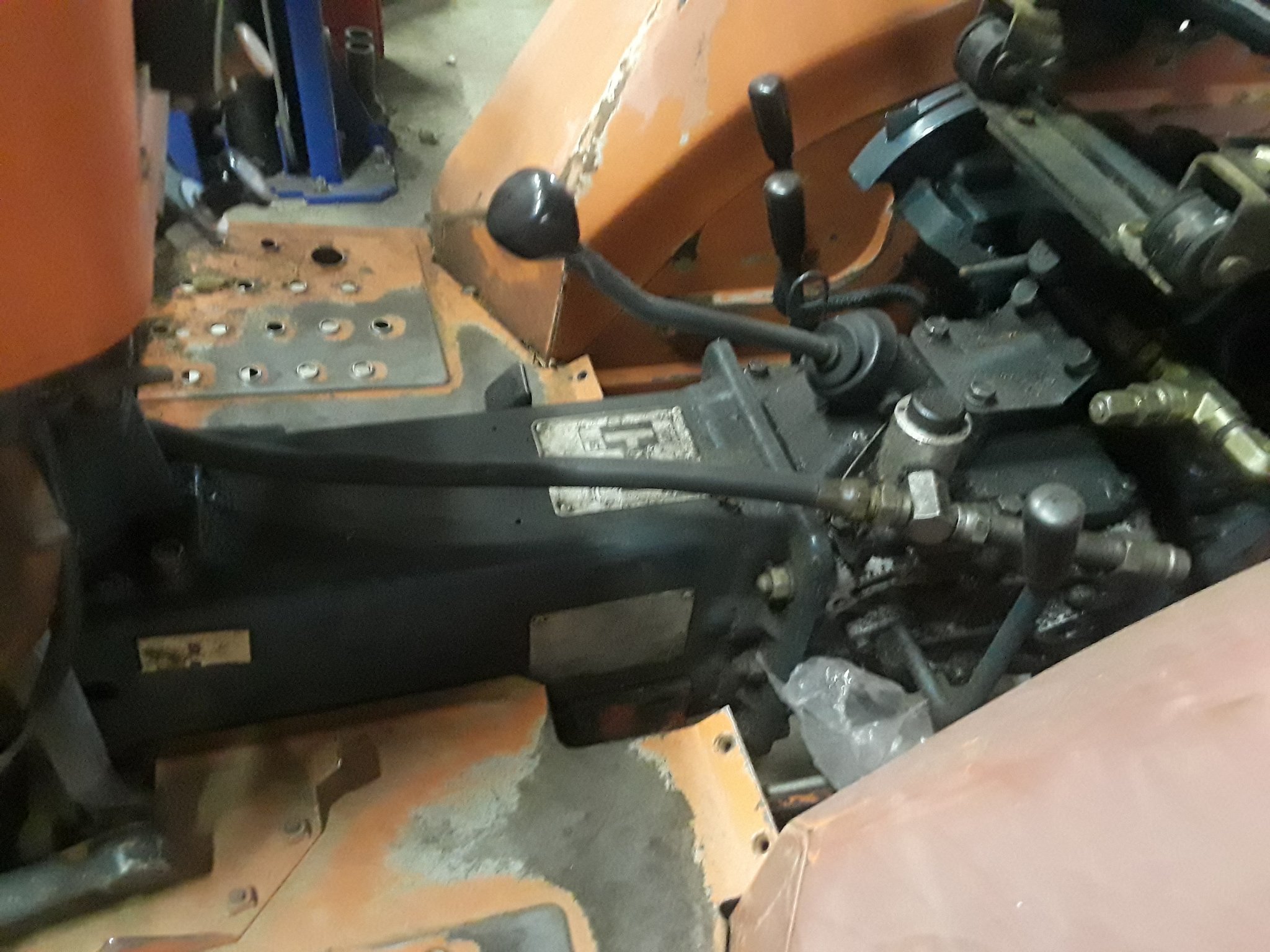

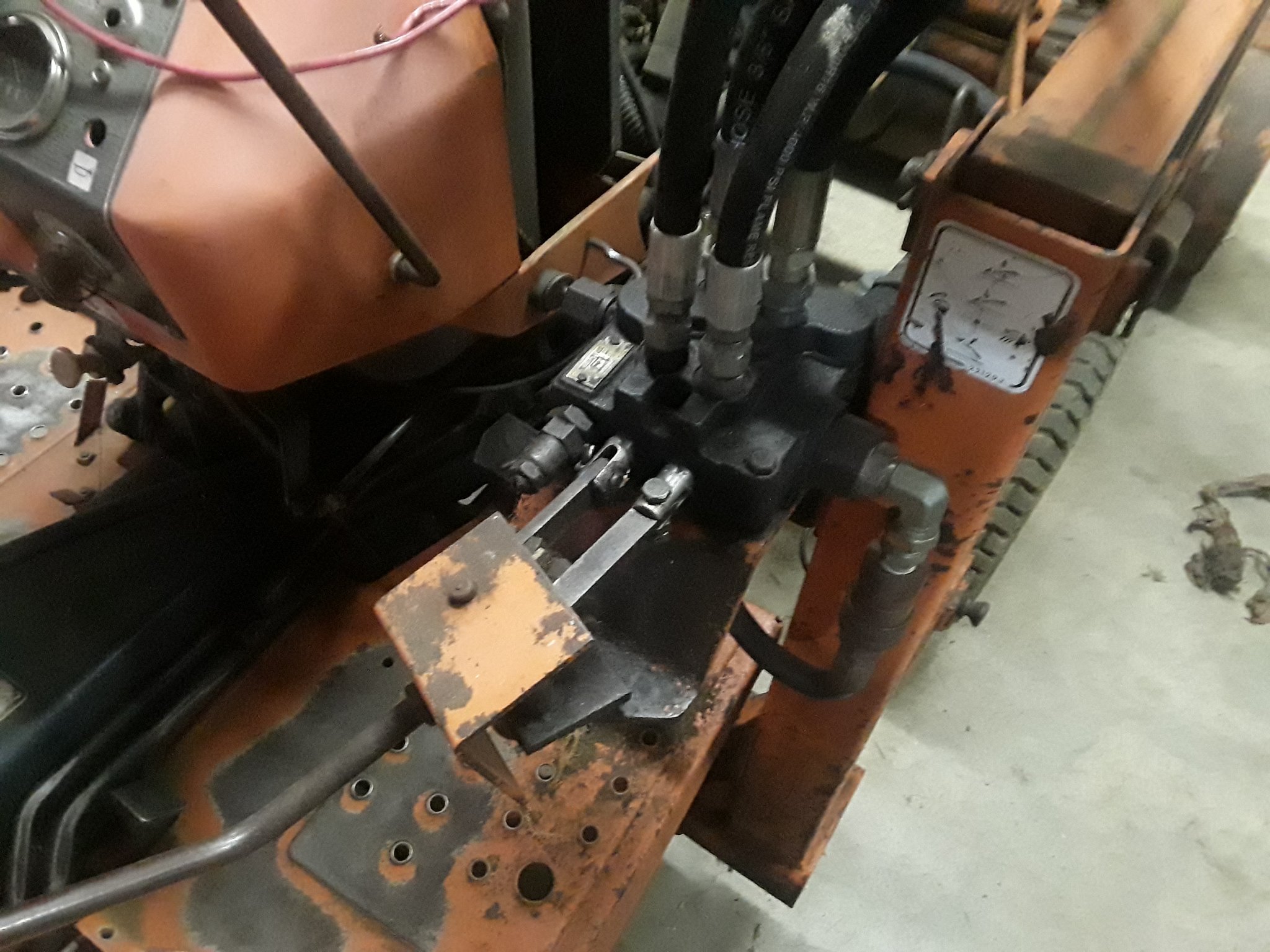

All you need is an inexpensive ($150) two spool valve with power beyond port. You connect it to the hydraulic outlet block as per the manual and run the tank return to the transmission filler. Your 3pt will function just as before. Here is one on a B7200DT. Just happens to be for the loader but it would work for a snowplow just as well.

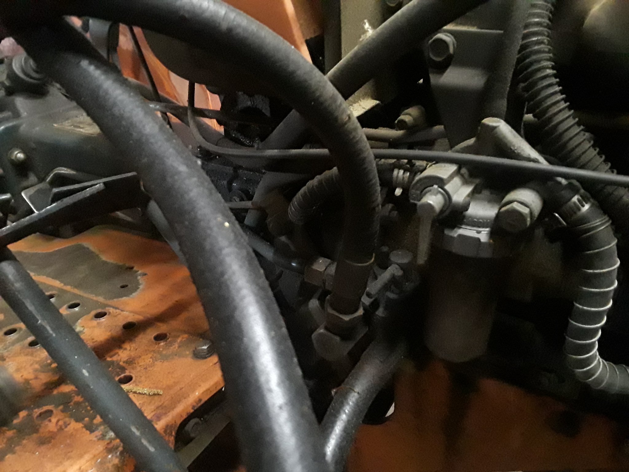

4) Last but not least is the implement tank return. The return port on you power beyond valve is used to return the out flow from the cylinders to the hydraulic reservoir.. That flow needs to go straight to the tank and on some (all??) Bx200 tractors Kubota supplied a hose fitting for the hydraulic filler for just that purpose - part number 70050-01615 ($54). I know that is correct for a B7200DT but may or may not be correct for a B6200HST

You are more than welcome. I am not endorsing any product but here is one low cost candidate for your control valve. You would need the optional power beyond conversion sleeve. Its also available with float on one spool if your lift cylinder is double acting.
I will aslo add that if it were me I would opt for one of the joystick models with float on one spool. Its a better way to control the plow and even if you don't need float now you will likely find a time when you do.
