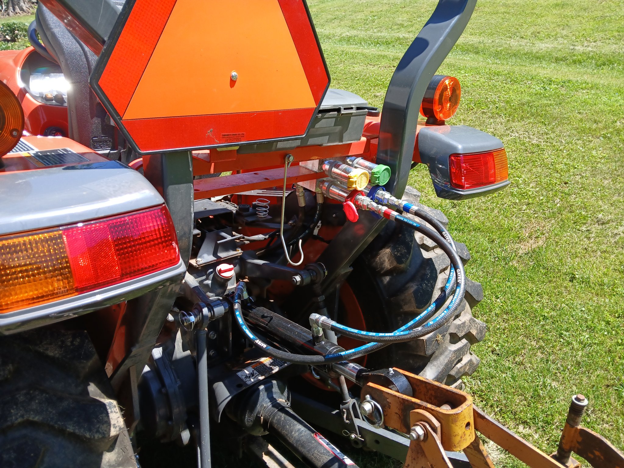

Here is a DPOCV used as a mounting block for the rear outlets on my L3901. Works just like a cylinder mounted one but it is part of the tractor not the cylinder.

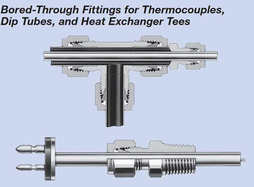

If you're going to hard pipe the pilot operated check valve, I'd recommend considering bored through Swagelok fittings. Make up the check valve body and tubing lengths then slip on the bored through fittings on both ends. Slide the bored through fittings out and thread the fittings into the cylinder port fittings then finally tighten down the compression nuts. The downside is that you're not going to be able to take it apart without cutting the ferrules off or cutting the tubing.
