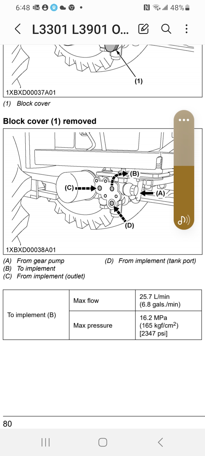

Yes, that matches the port layout on the OEM outlet block. Here is the diagram from your L3901 operators manual.
B is pump out
C is power beyond return
D is tank return

BTW... Warning to o anyone else buying one of these... The parts manual is a not correct. Use the attached diagram.
I would not call it incorrect - it a genetir parts diagram. Conncct the hoses exactly as they labeled them using the port assignments from your tractor owners manual.
