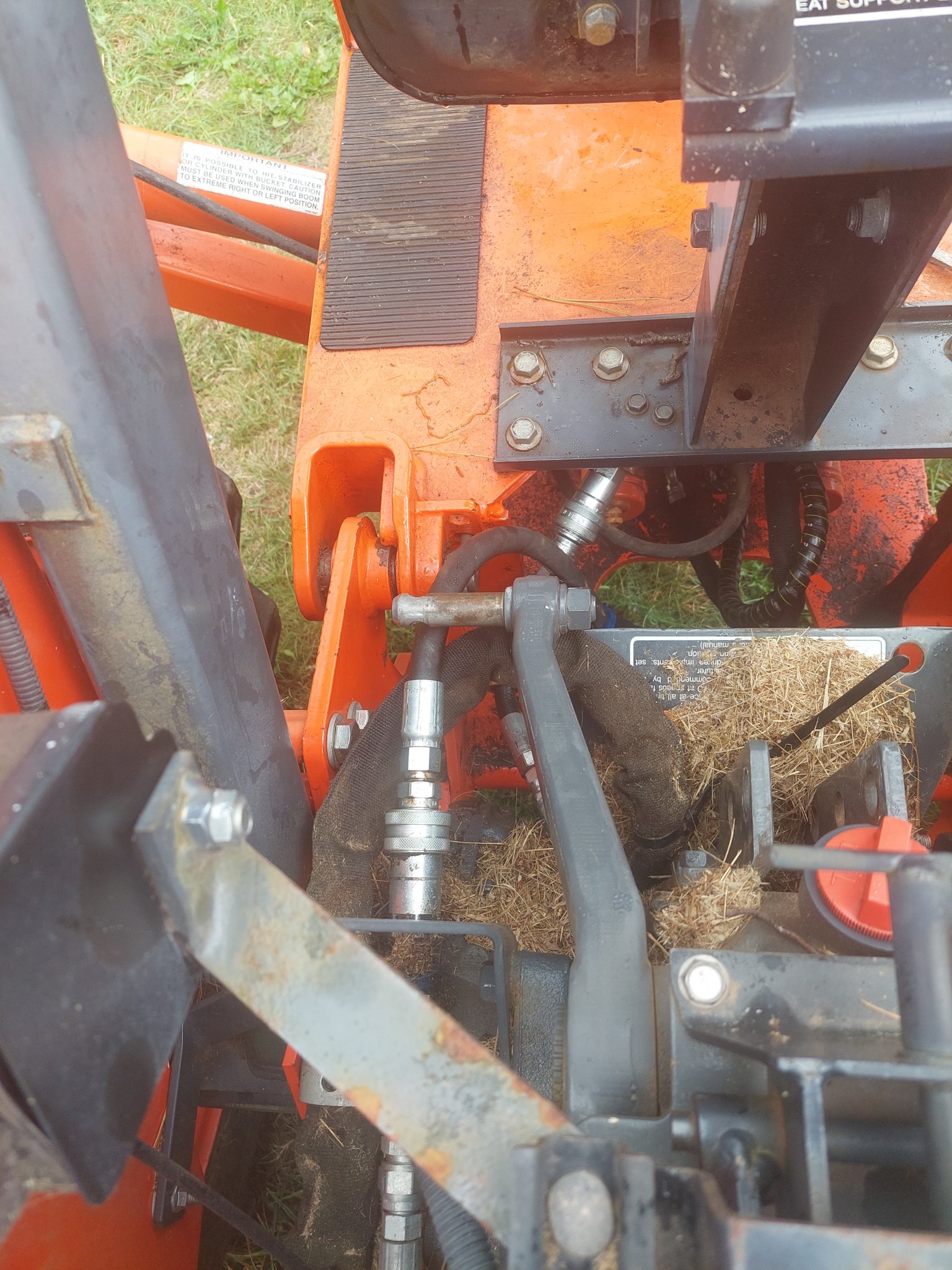

Thank you so much Dan! I really don't understand this stuff at all. Yes I did replace one of those hoses. The top one in the first picture. I will take a close up and post again.
There are two hoses to/from the hoe.
Here are the pics
10,431
5,616
Here are the pics
Here is the short story.
Oil from the pump goes in one side of the loader valve, out the other side into the backhoe valve, out the other side of it into the 3pt valve, out the other side of it and back to the sump on the tractor. Something in that path is blocking the flow.

Yeah I think you nailed it. The flow seems to be fine all the way to the return line and even though I disconnected the return line on both ends I can't get this line uncoupled. It is acting as if there is pressure but there isn't.
" most likely at the coupler between the backhoe return coupler " - How you knew this is beyond me. I suspect some sort of magic.
10,431
5,616
No magic. Diagnostic analysis honed by 40 years of debugging code - both mine and others. You provided the clues with a very good description of what was and was not working. Many of the very well educated professionals I helped over those years were not so well organized. Given the symptoms it was just a matter of fitting them to system operation. That said are you SURE its the coupler?

Anyway I finally got the coupler apart and it looked fine and was functioning properly so I cleaned it and snapped it back together and everything is working as it should.
