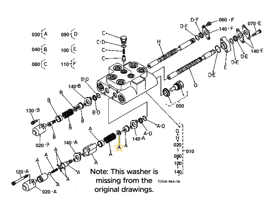

I have a used MX5000 with a LA852-2 using a husco 9210 spool valve. The detent was not working, when cold the boom would not lower until warmed up. *(It was full of water and the balls/spring were sitting in the bottom cover) I noticed that in between float and down pressure, there was a spot that wasn't "normal", it had a jitter. I replaced the detent with the Kubota part #75536-65400. The detent works good, and the jitter in between float and lowering with power is gone. now the issue seems to be on the boom raise, pulling back on the stick about from neutral position to 3/4 position of the boom stick it works 100%, as soon as i go beyond 3/4 to full the boom stops raising and I can hear strain on pump. What did I do wrong? What should I be doing?

I font think you need any tolernces.
IF the problem is over travel it should be pretty easy to find and remedy. Something mechanical in the valve prevents the spool from being pulled out the front. Identify that and the fix may be as simple as adding some shims or a washer.
Looking at the component parts diagram I would guess travel is limited by the fully compressed length of the centering spring.

Good day Dan,
Thank you for your knowledge, I have resolved the issue and you were bang on with your advice.
There is missing information on the Spool Valve Component Parts view.
The washer that goes on detent shaft that is missing from the Component view.
Thanks again,
