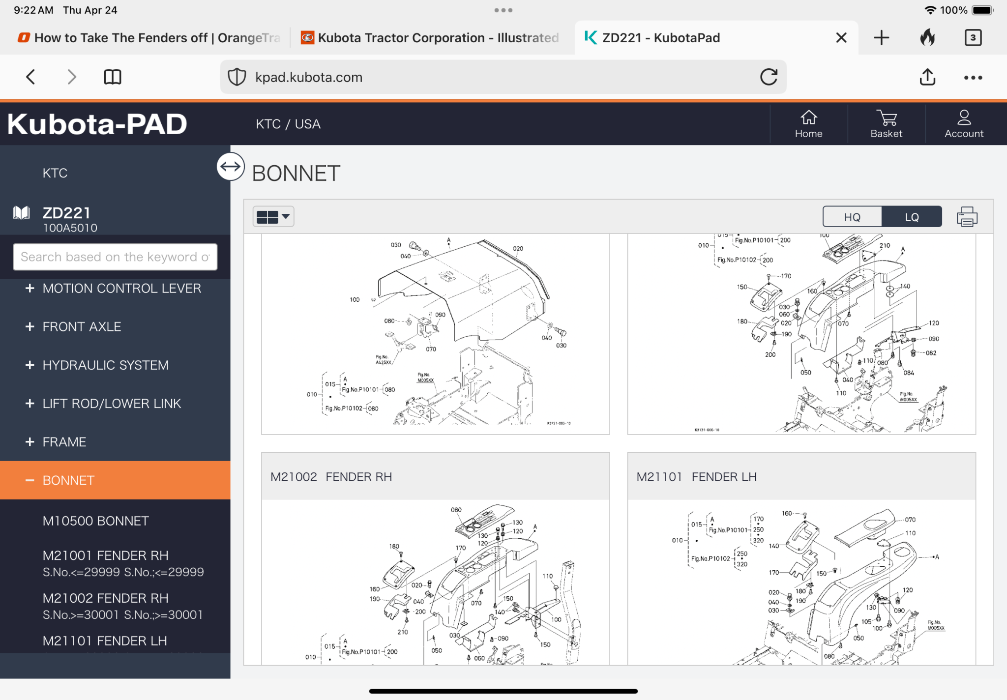

Hello all,
My first post, Proud owner of a used Kubota ZD221 Zero Turn Mower. I am trying to repair a few things. Primarily, the fuel sending unit has a faulty or stuck float, and one of the bulbs in the key ignition appears to be burned out. My problem is that, for the life of me, I can't seem to find out how to take apart the fenders. As far as the left side is concerned, I only see one bolt where the floor meets the fender, and what appears to be a pin on the underside. For the right side I found a few bolts and screws but I get about half way and cant seem to figure out the rest. Searched YouTube for a mower similar to mine, but no luck. I even went so far as to purchase a workshop service manual for it, but the only instructions on removing the fender state, "Remove the left and right side fenders." (huge help). Hoping someone here might be able to steer me in the right direction. Thank you in advance for all your help. Let me know if pictures would be more helpful.

You can look at illustrated parts lists that should help you understand how they are attached.
Go to this website
and search for your mower then get to illustrations like this
