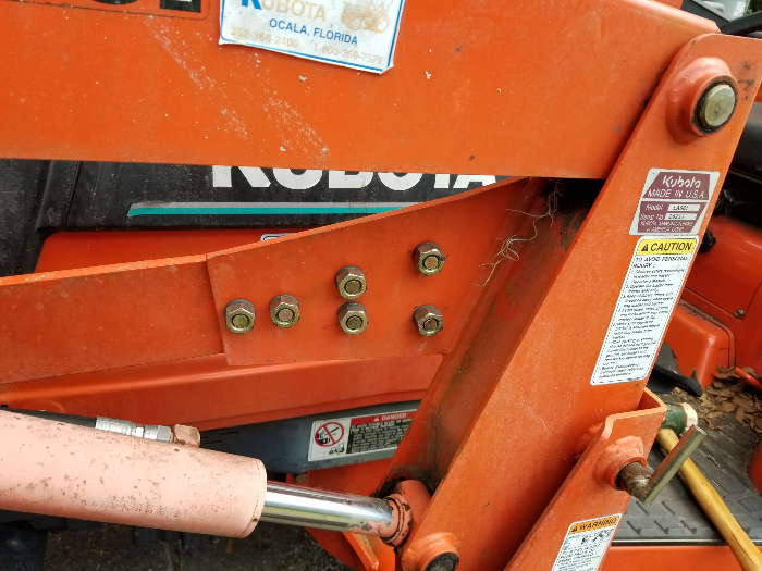

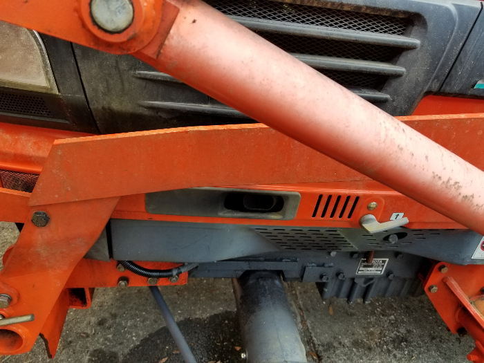

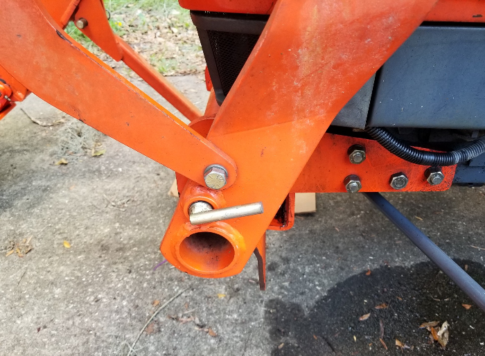

It turns out I was right. To get the loader off, you either have to remove two additional pins (which I can't find on any photos of other Kubota loaders) or remove six bolts per side.
I have three photos. One shows the pins under the grill. Another shows the member that connects the part the front pins go in to the part where the rear pins go. The third shows the rear pins. As you can see, it's one continuous piece except for the six bolts.
I looked at a bunch of Kubota FEL videos before trying to do this, and not a single one of the loaders had four pins.
If I just remove the pins, those little struts will have to hold up the arms and also the heavy part that protects the front of the tractor. I don't think they're built to take that kind of load, so I wonder what Kubota was thinking.
If I want this thing to come off, I'll have to remove 12 bolts every time. The removable pins are useless.
I want to replace the steering hoses myself, but it looks like you need a professional just to get the FEL off.

Today I tried to get the loader off again. I removed the 4 pins. I also took off the guard over the bumper. I loosened the bolts on the bumper so I could try to take it off.
It's really something. The upright parts of the FEL at the rear have two pins each. The upper pin is removable. The lower pin is welded in place. Inside the upright member, there is a horizontal semicylindrical piece of tube the welded pin sits in.
When you remove the upper pin, you still have to lift the rear of the FEL up so the welded pin comes out of the semicylindrical rest. It has to come up half an inch or so.
The FEL is so heavy, a human being can't lift the welded pin above the rest. In fact, if you put a two-foot pry bar inside the tube where the removable pin goes, you can't move it at all by prying. Also, inside the member, there are two welded obstructions that make it impossible to lift the upright member far enough to clear the rest.
Here is what I learned about this thing. It is not possible to get it off unless the hydraulics are working. I found instructions someone else posted online, and I will repost them here in case anyone else needs help.
When I started working on this, I was able to run the engine and move the loader, but I can't do that now because I have to replace the front gear case first. It looks like I am stuck repairing the gear case with the loader right where it is.

Here is a wonderful design feature others need to know about: Kubota uses a mixture of M14 and 9/16 fasteners on the loader. They are nearly the same diameter and look alike, and the bolts will try to go into the same threads. Kubota also uses several different lengths of 9/16 bolts. If you work on an LA681, you have to bag and label the fasteners.
The fasteners are way overtorqued at the factory, so an impact wrench and breaker bar are required. I will be reinstalling them much less tightly.

I knew a guy who had one of those older design loaders, like yours, on his Kubota. He never took it off because he thought it was too much hassle. Kubota stopped using that design on later models as you are seeing on YouTube. My tractor was slightly newer, and had the 2 pin design that was easy on and off.
Looks like your loader was supposed to be removed by removing the 4 pins and using the hydraulics to curl the bucket and shift the arms so the loader would slide out of the mounts on the tractor.
You are in a hard situation without being able to use the hydraulics to get the loader off. You say the front axle needs work. Can you still push or tow it? Will the engine/hydraulics work? Wondering if you can get the tractor to a place where you can start it so the loader can come off.
I will tell you those two parking stands are plenty strong to support the arms of the loader but make sure to pin them!
Your comment about having both metric and SAE threaded bolts suggests someone did some homebrew wrenching on yours at some point. Every single bolt, nut and screw on my tractor was metric. I would be concerned that the fella that decided to use SAE hardware might have also had an inspiration to make other "improvements" that could make your job even more complex.
