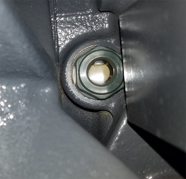

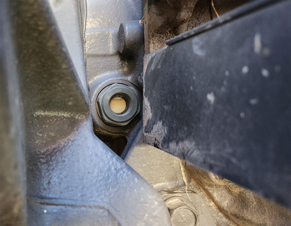

Five years with a sight glass on two MX tractors and I've never needed to dye the hydraulic oil. Perhaps there's something special about the MX sight glass. 😂 The dipstick on the M6060 was another thing altogether and I ended up "blueing" the end of the dipstick because it was so hard to read, hard enough that I overfilled the tractor.
I'm all for doing things that make life easier, but I like understanding the why or how rather than doing something just because. Why are some sight glasses easy to read and others not? Is this issue more common with L series models? Having a good idea of how much oil is in the engine or the hydraulic tank is an important part of proper maintenance. If dipsticks or sight glasses are hard to read, companies need to address that without band-aids such as dye.
Here's the sight glass on my first MX6000 when it was just a few hours old.
Here's the sight glass on my current MX6000 that's four years old (photo taken this morning 10/06/25).
