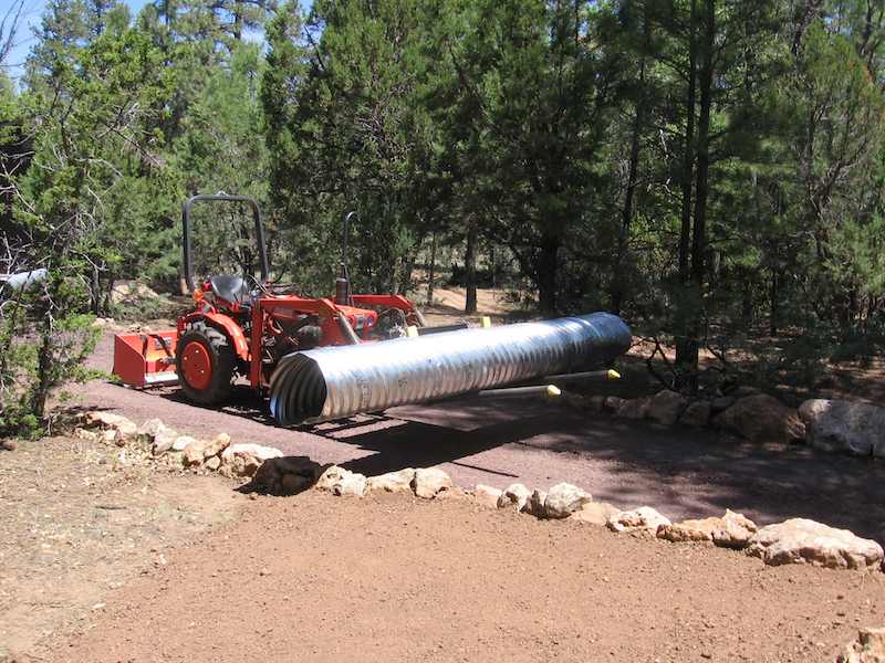

I have an old set of GC brand chain on forks, and I have always felt they were too long, especially for my B7100. I was thinking of shortening them and thought I would ask you folks what length yours are. The pertinent measurement would be from the bucket edge to the tip.
Judging from the third pic, mine must be at least 40", (stand is 39" deep) should have measured them last time I went there.

If I try to pick up something like an old rotted log or a heavy limb, the forks are so long that the FEL will not lift until the forks are completely under the object.
In other words, the FEL cannot overcome the lever effect of the long forks. The FEL was only rated to lift 400lbs new, and I'm sure less after 41 years. FEL was rebuilt a few years ago, and functions well without the long lever arm of the forks to contend with. Something like a loaded pallet of almost anything is hard to lift because the load is so far from the pivot point.
I guess my thought was that if I can't use the outer 12" or so, why deal with all that extra length when maneuvering?
Sounds like most forks are around that 40"-42" length, so next time I go where the tractor is, I need to verify the fork length. My gut feel is that mine are still longer than that, but maybe not enough to make the chore of shortening them worth the effort.

I should also mention mine have a rectangular steel pocket welded just in front of the bucket lip that allow a couple 2x4s to be dropped in to prevent the load from sliding too far back. You can just see the yellow 2x4s in the culvert pic. Not a big deal, but one more thing that pushes the weight further from the pivot point.

Got to visit the tractor for a few hours today and measured my forks- 42", so they're not overly long.
Thanks for your input.
