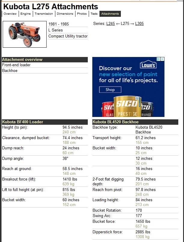

Does it have its own hydraulic pump driven from the front of the engine or is it tied into the tractor's hydraulic system?
tractordata.com shows a BF400 as the loader for the L275. It is always possible that an after market unit is installed.

Here is a L275 Tractor with the factory recommended BF400 loader.
It appears to be identical (maybe the predecessor of ) to the LB400 I have on my tractor.

Well its clearly NOT a 'BF400' front loader. So we can eliminate that.
