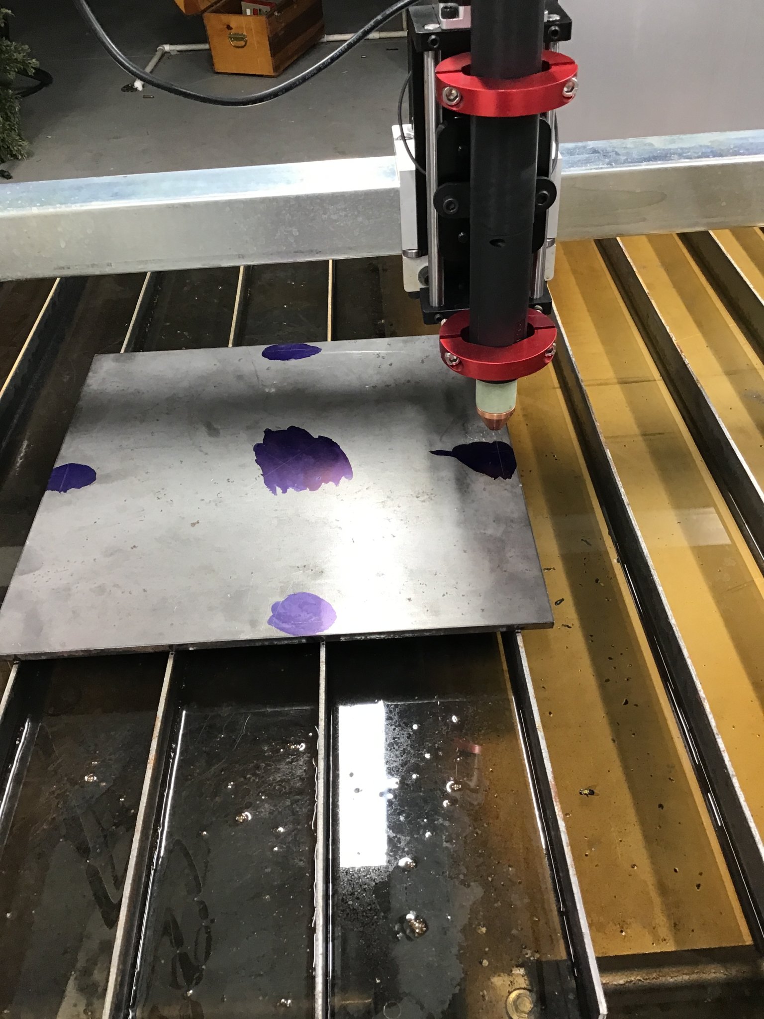

However the next 3 were cut using my Crossfire Pro!!!
Wow, that is a game changer for sure!!!
Here I am cutting out the “plates”…Took about 45 seconds per plate, after I got them “aligned”

from a different thread, I had to use “witness marks” to try and get each plate cut “about the same”

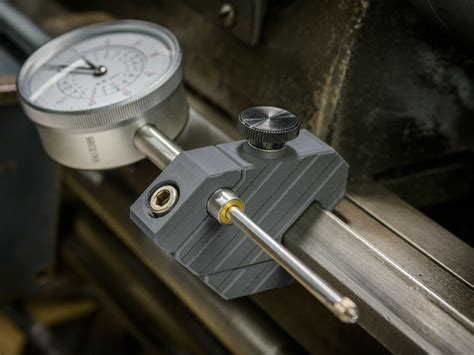

Here is a sample of what you can use to measure your cut distance with accuracy. I prefer the magnetic style. You can find these in any machining supply catalogs or on eBay, Amazon etc

I’m suffering from hoist envy! Starting to get cnc plasma envy!
