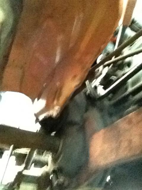

I have a L245DT with a FEL, and a few weeks back the front frame assembly snapped a corner off of the engine block at one of the mounting bolts. *using the FEL and NOT overworking it...
WELL... after getting her up on stands and and pulling the entire front end off. All I can say is it was a POOR DESIGN for the front end of a 4x4 tractor.
Yes, its only 25hp, but I'm sure its NOT the only tractor to have this problem.
It looks like its had 4 helicoils, and one stepped up/tapped out larger. So, its been a problem for this tractor.
So... buying and replacing the BLOCK is out of the question, it wouldnt cure the problem.
My intent is to fabricate a front subframe, bolt some plate to the sides of the block, weld some 4" channel from the bell housing to the front bumper ( it has an 8" C-channel bumper).
Bolting the front of this subframe to the bumper, and adding 2 anchor points to the FEL mid body supports, and welding the front assebly to the new subframe.
This way, the tractor can be "split" (if/when needed) and the new added metal would come off as part of the front assebly.

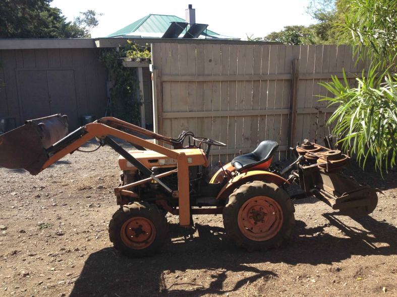

Since a tractor is essentially an engine bolted to a transmission, not including the transmission half in the subframe workings transfers the stress from your engine block onto the engine/transmission connection point. Worst case scenario results in the tractor snapping in half, likely just past the bell housing. No bueno.
Here's a shot from the side.You can see the front area attachments and see the frame running to the rear of the tractor. I'll try to get a pic up of the rear attachment point later today.
Right ON Ach...
Is that a kit/subframe or was that custom built?
If your able to get some close ups (whenever your able) that would be AWESOME...!!!

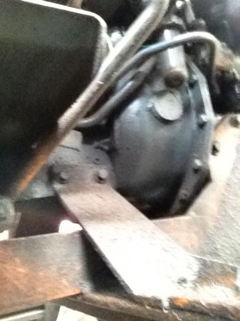

Terrible quality image but hopefully you get the idea. The subframe arm goes from the front attachment point until it hits the rear axle housing. Where it terminates it is welded to a crescent shaped plate that gets bolted onto the axle housing by three of the axle bolts.
The other picture is a shot of the side attachment, where the loader is connected to the transmission casing.
