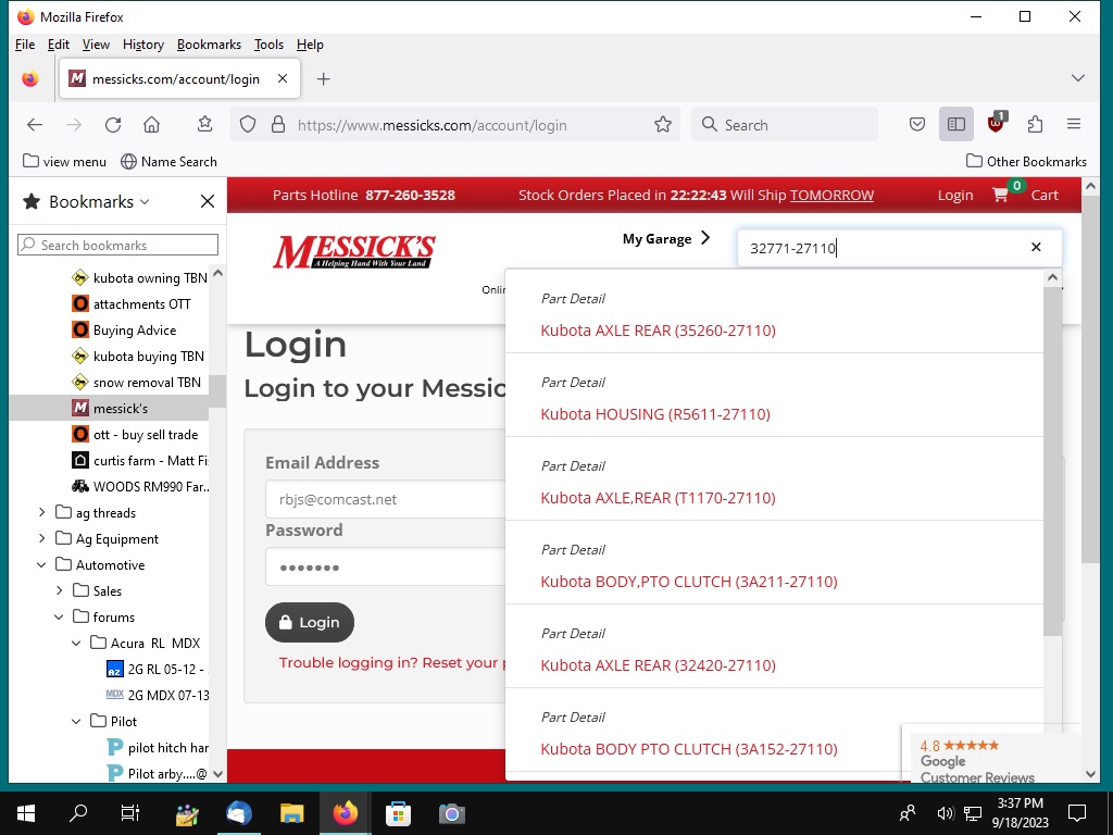

Is the break a "brittle fracture" - flat like broken ice? (closeup pics would be tell a lot) The original axle 32772-27110 looks to have a small keyway in the threads. This link and related thread describes a similar break occuring at that location. On a hardened part, small corners are huge stress raisers and cracks can start there. Sometimes a shock load can break a through-hardened part like a cookie, especially if the part was hardened too much.
The original axle is heat-treated and would be difficult to repair/restore to full strength, but maybe a new axle from another model can be modified to replace it. Several Kubota rear axles in that size range tractor are of similar design - some without a keyway or threads or maybe hardened by a different process.
For example, the T1170-27110 axle from a M59 is possibly similar in critical features - the inner-end splines, outer end stud flange, maybe even the bearing area may be the same. It's pricey at around $1300 but in a good machinists' hands something like this might be a place to start in duplicating a replacement for yours. Need to study the parts lists for mid size L and M models and compare them to the L48. There might even be some older models with candidate axles in salvage yards for cheap.
Searching Messicks's the part number returns several xxxxx-27110 hits - three of them are rear axles. Maybe find a clue there? Best luck - Dick B.
