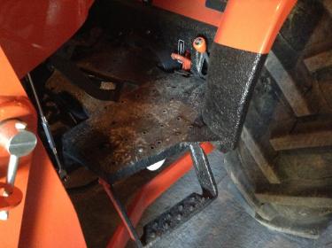

At 50 hours my mx5200's floor looked like crap. Bought some Herculiner at lowes for $55 . LineX wanted $450 for this. Did 2 coats on the vertical portions and 4 on the floor. Herculiner will not crack if it is applied to a thickness less than 1/4 inch, so I put a good amount on the floor. 120 hours later it is still holding up great. Even the step shows no sign of wear and I use it a lot. Thought this might help someone trying to decide on what to do with their floorboard.

Great idea, I'm at about 95 hours and mine has some missing paint. Will probably let it slide for a bit before coating mine.

I have also done similar things with the rubberised undercoating in the rattle can. Much less expensive but not as durable. Still gives you protection and touch ups are cheap

Great idea and nice job. Just got a new BX23S a month back and just started looking through the site. Will be doing this one soon if it ever stops raining here.
